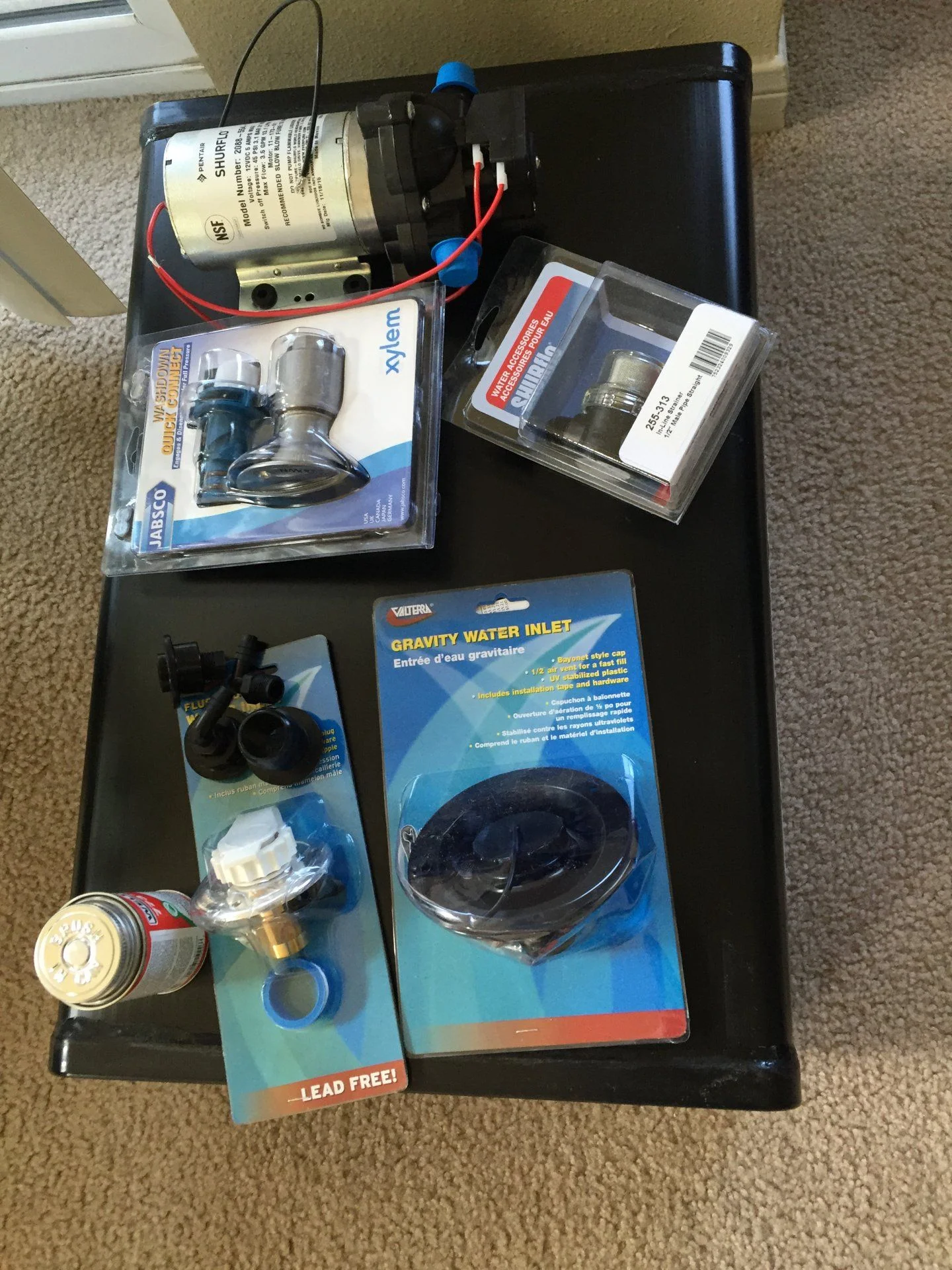

Pretty busy day today. I have ordered Prinsu roof rack, circuit braker and terminal fuses with terminal fuse blocks also some 12V usb sockets from west marine. Ordered tailgate lid storage kit from @socallove. I received the water system today:

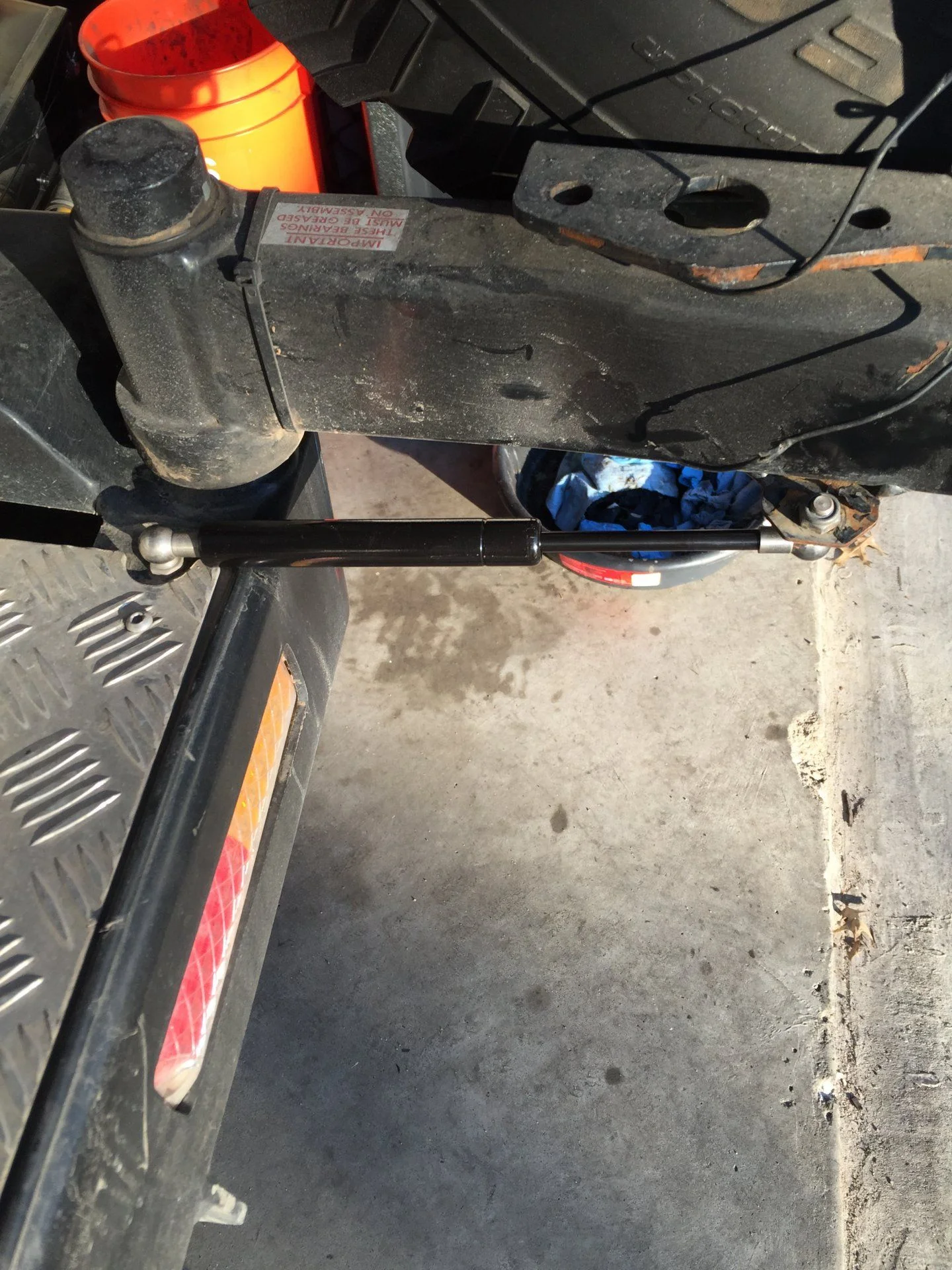

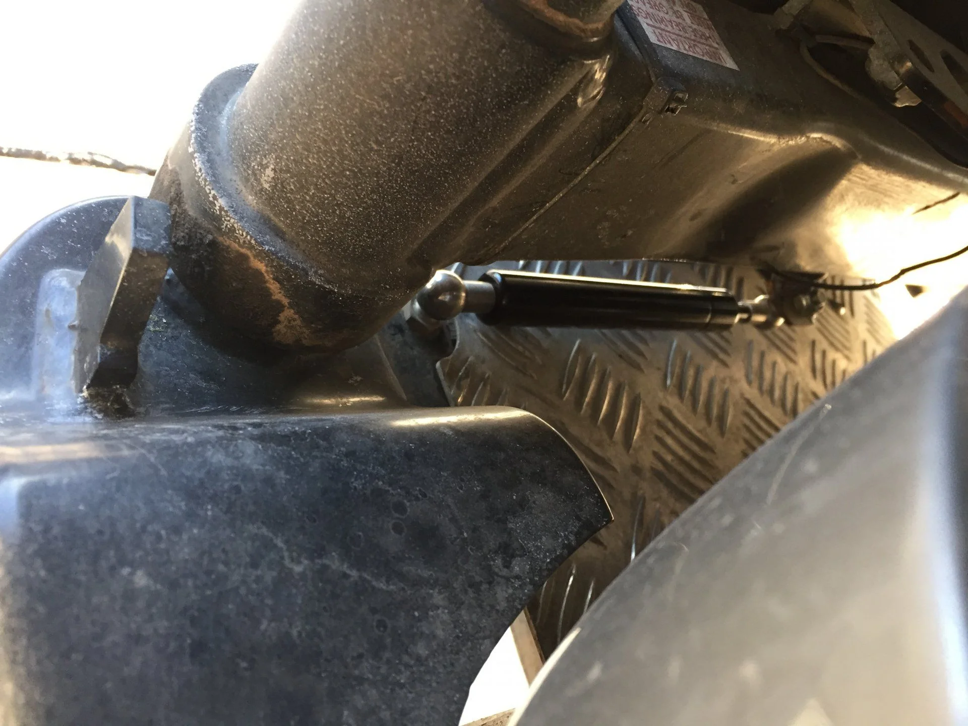

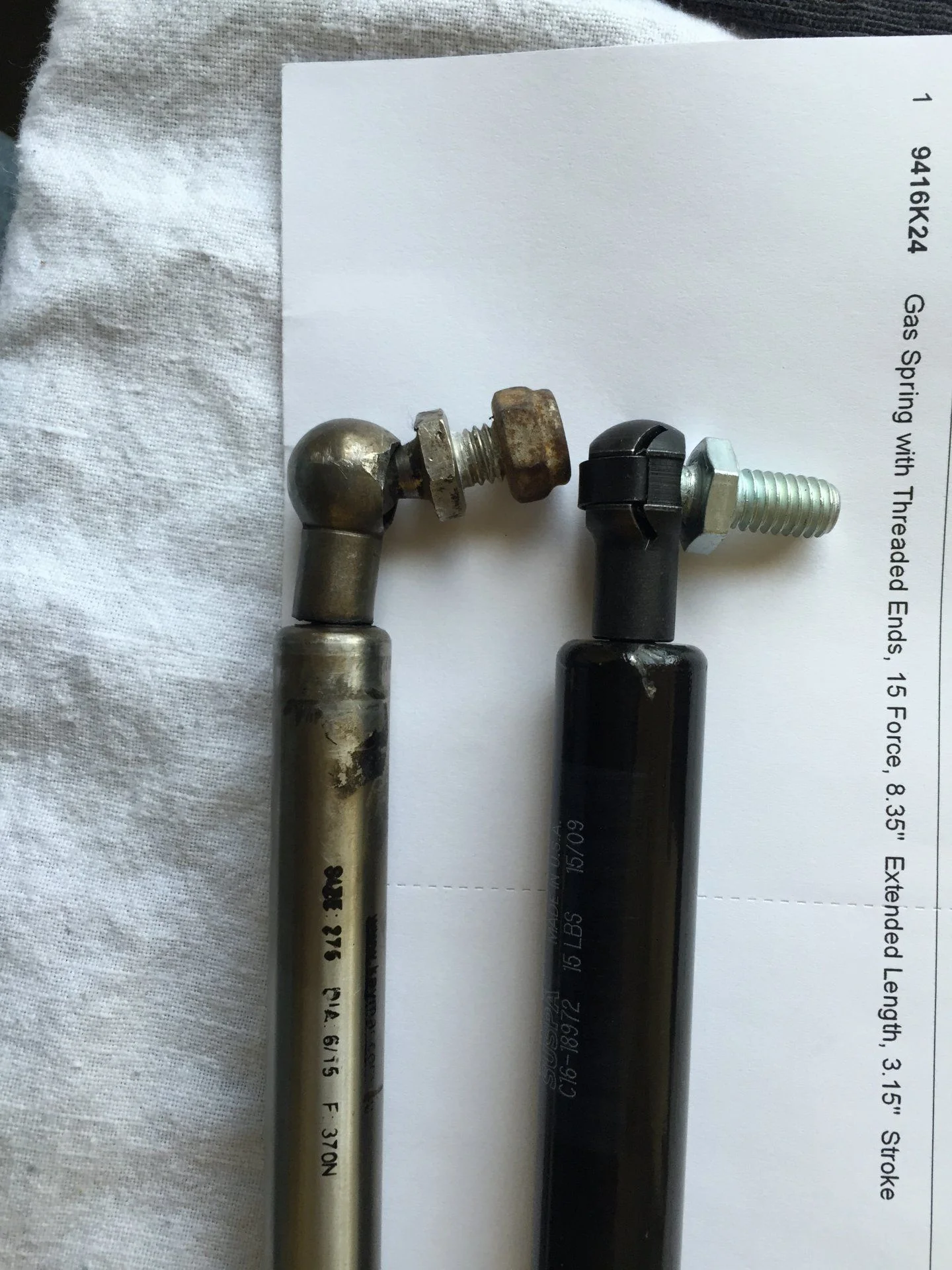

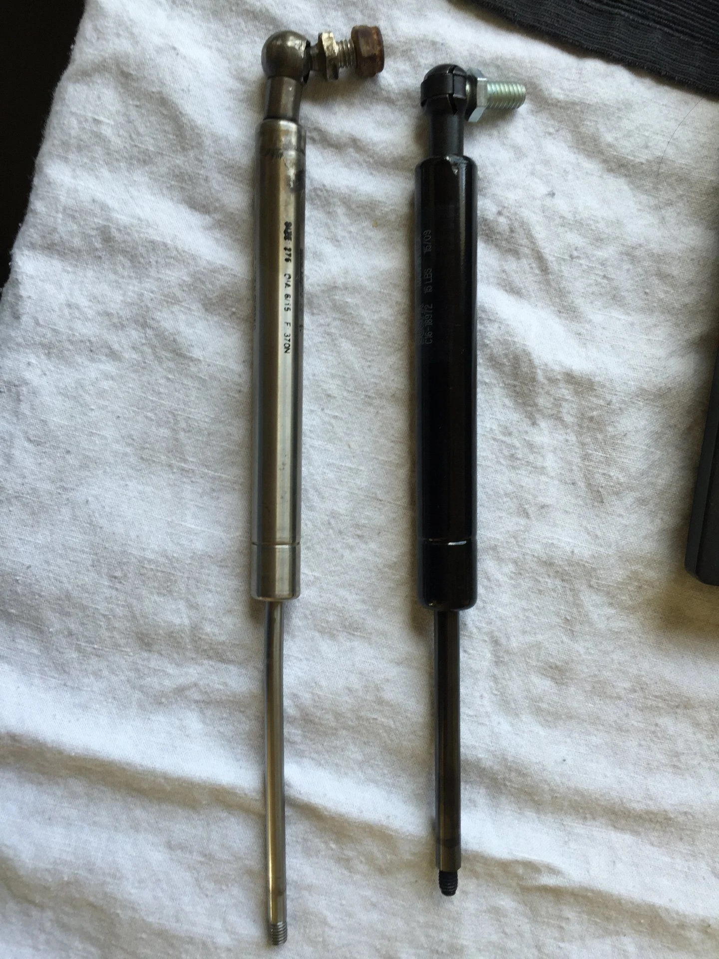

Got the shocks for Kaymar bumper from McMaster-CARR the shocks are good and the fit is ok.

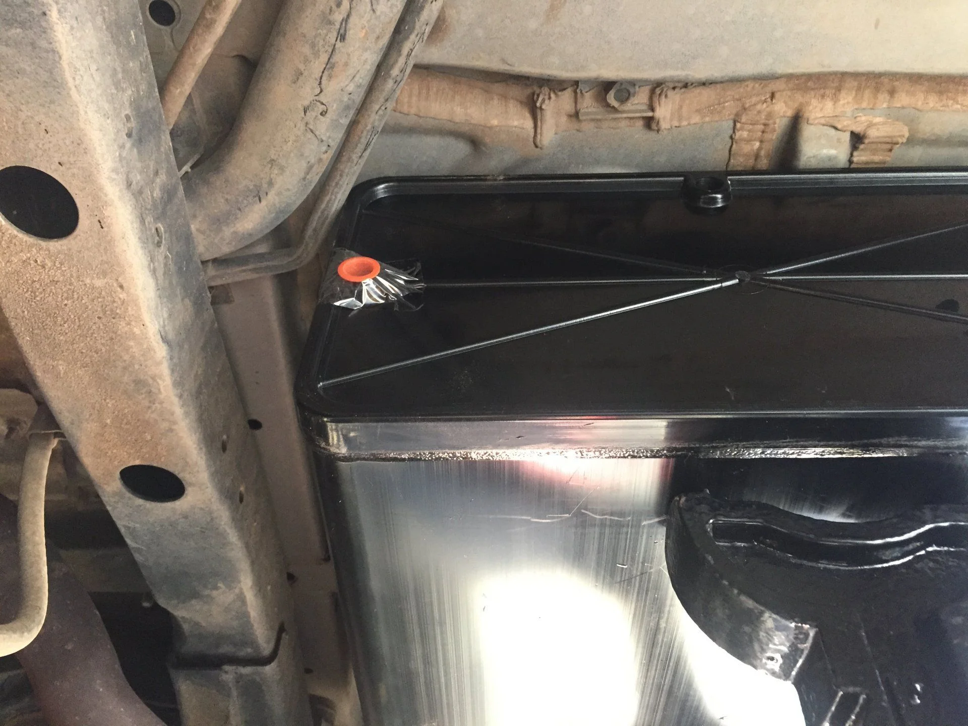

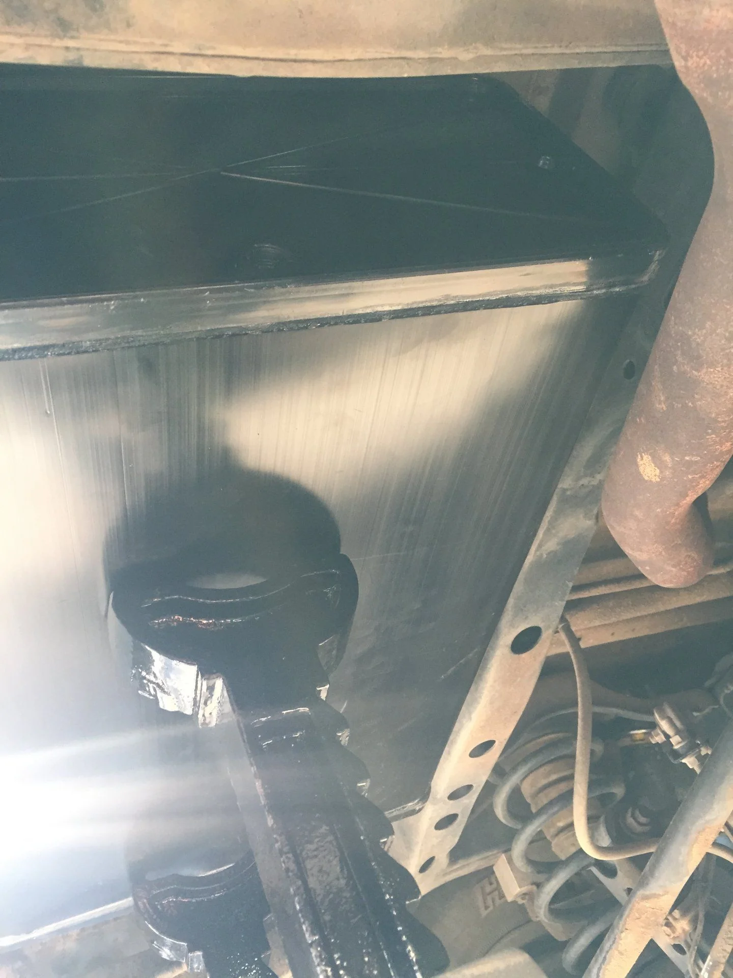

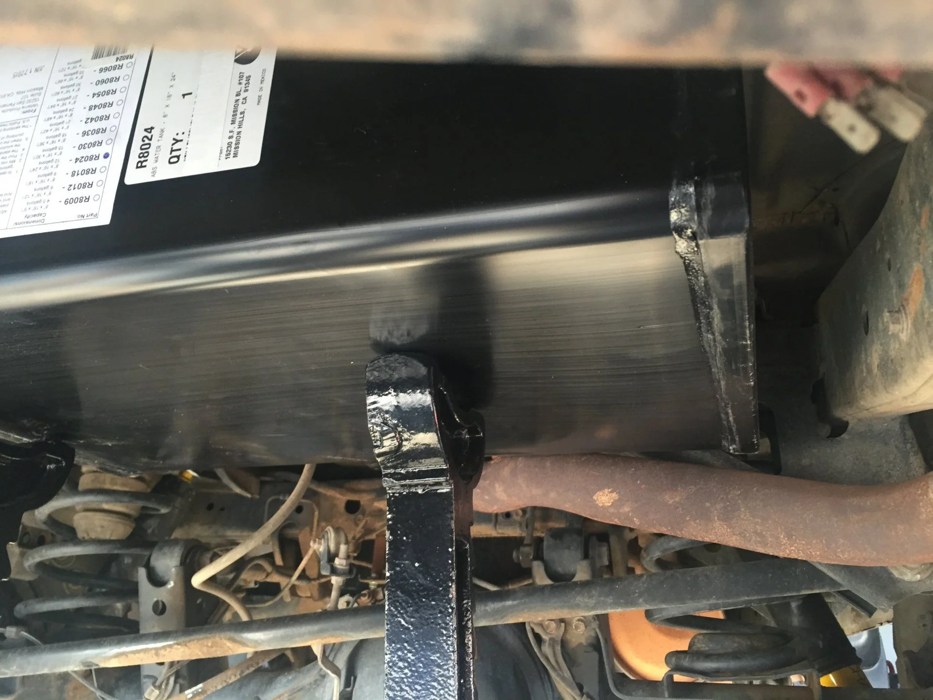

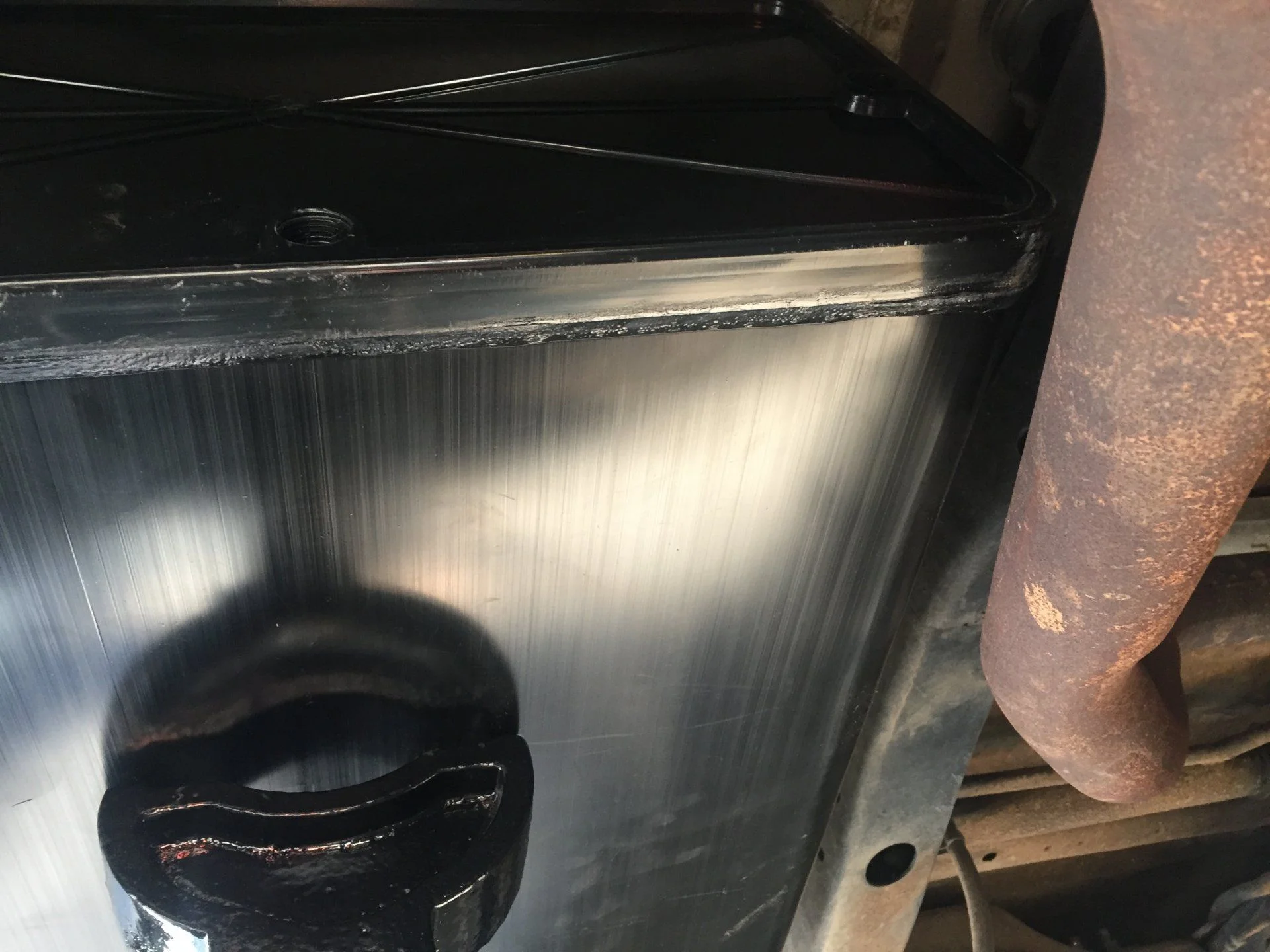

I tried to fit the tank under the frame where the tire reserve was. To me it looks like the tank is very close to the exhaust. I am bit worried as the tank is actually plastic. I could try to wrap it in some heat wrap but even that might not be enough .

Guys , I need some feedback on the water tank and it's location. Do you think that it is too close to exhaust ?
I'd be worried about plastic that close. A heat shield might do the trick or perhaps a slight exhaust reroute if you must run the tank there.
