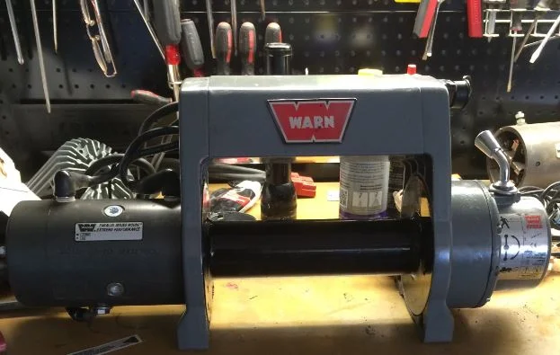

My FJ40 came with an XD9000i Warn Winch. When I tried to hook it up I got sparks and smoke. The PO said it worked for him.
Learned a lot, followed this video to validate my solenoids were good
I then bench tested my motor and validated it was bad
I used this instructions as a guide and it was very helpful
http://www.wanderingtrail.com/Repairs_Rebuilds/warn_winch/warnwinch.html
The parts breakout was very helpful as well
Took me a while to find those resources so thought I would share
Waiting a few days to let the paint dry before I add the cable
Its a multi-mount. It has a hitch end and plugs into a normal trailer receiver. The PO had a custom front bumper made with a receiver made.
I can see advantages to being able to use it on multiple vehicle or the rear. I personally would have preferred a hard mount, but I do like the look of the custom bumper.
The cradle wiggles as it isn't a snug fit so I may look into making holding brackets or developing a hard mount. BUT that's low on my priority list

Also, I put a shim in the receiver and that took care of 90% of the wiggle so I am good with the setup now
