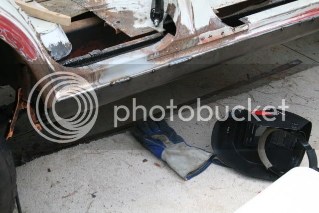

I just saw this thread, but here are a couple of pictures of our 55 rockers. They can definetly take a hit. They are 3/16" curved to fit the 55 rocker profile. We found lots of things that we didn't know we had during our recent move, and I found 2 pairs of these that we still have.

I've been running these heavy rockers since Lance first made them. They are indeed strong and almost as good as sliders- especially on my truck as they're welded to the 2x4" rectabngular tubing sliders that ya can't see on my truck.

Does anyone have a measurement on these? I want to know how long they are before I get with IPOR. My concern is they are only long enough to go where the original rocker was, I need to go into the bottom of the fender as well. Thanks guys.
they go from wheel well to wheel well, tire to tore basically. way longer than the original rockers.
They really do go from wheel well to wheel well. The only thing they don't have are the front and rear wheel well lips. Those had to come off of mine, so they are just cut off. A little patience and you could fab them up.
I cut mine off at the front fender and then had them meet there. I didn't need them for sliders, just rockers.
