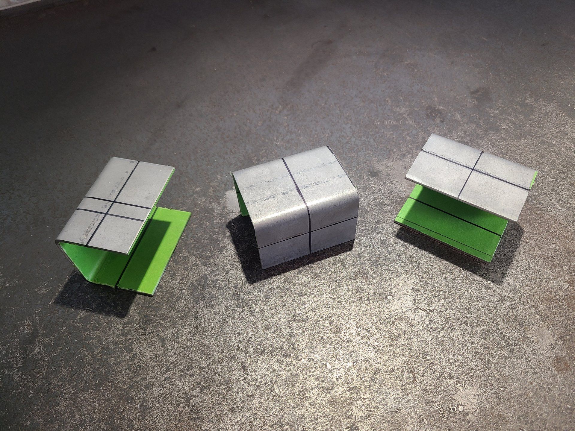

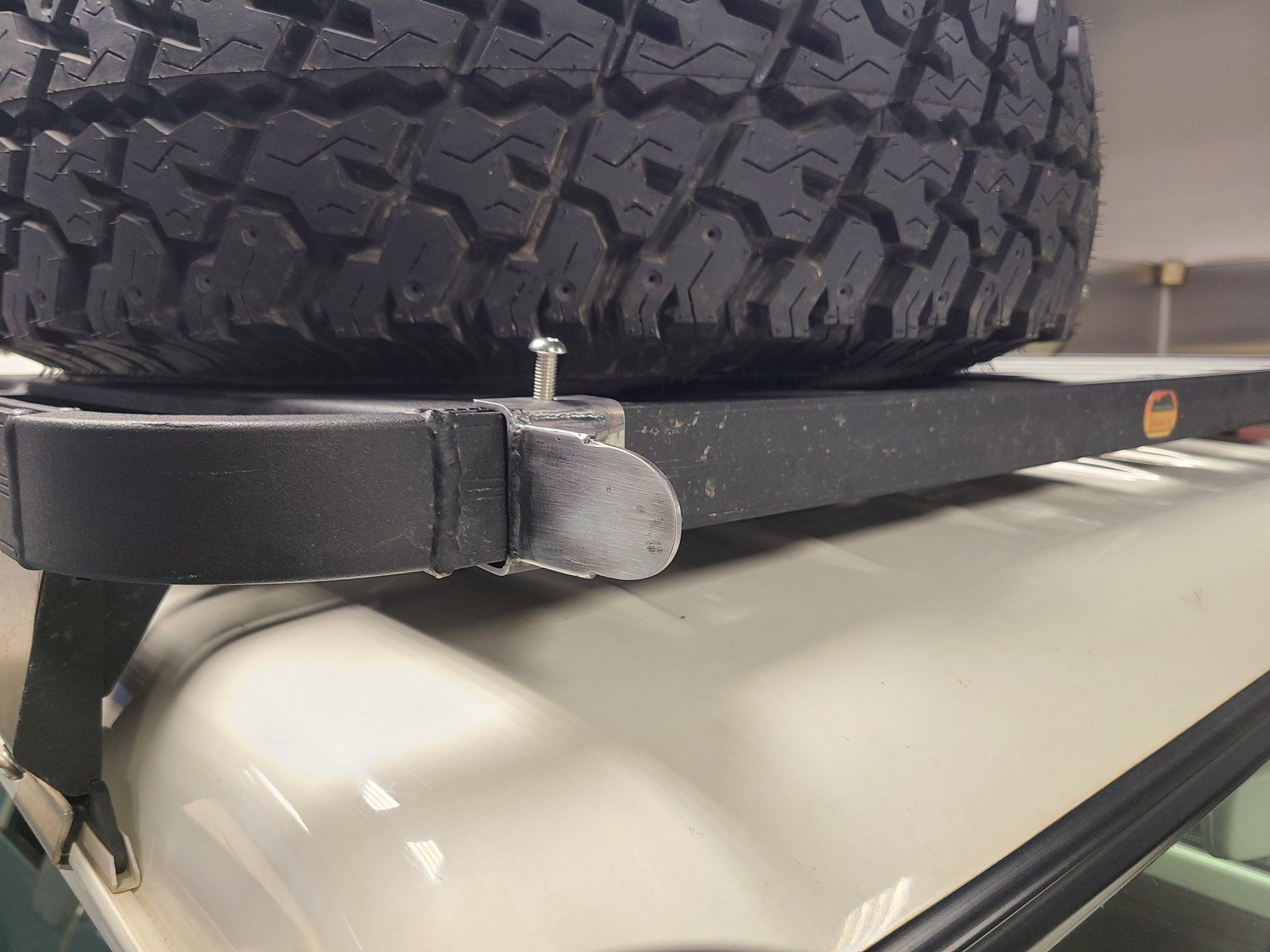

Got to work on our KC light bar and mounts.
Had some U-channel bent up and cut some pieces out.
Trimmed them down
This is where these will go. These will mount with some in-bound M8 t-nuts. 2 per bracket and there will be 3 brackets(2 sides and one center).
Made a pair of these to attach the light bar to the bracket.

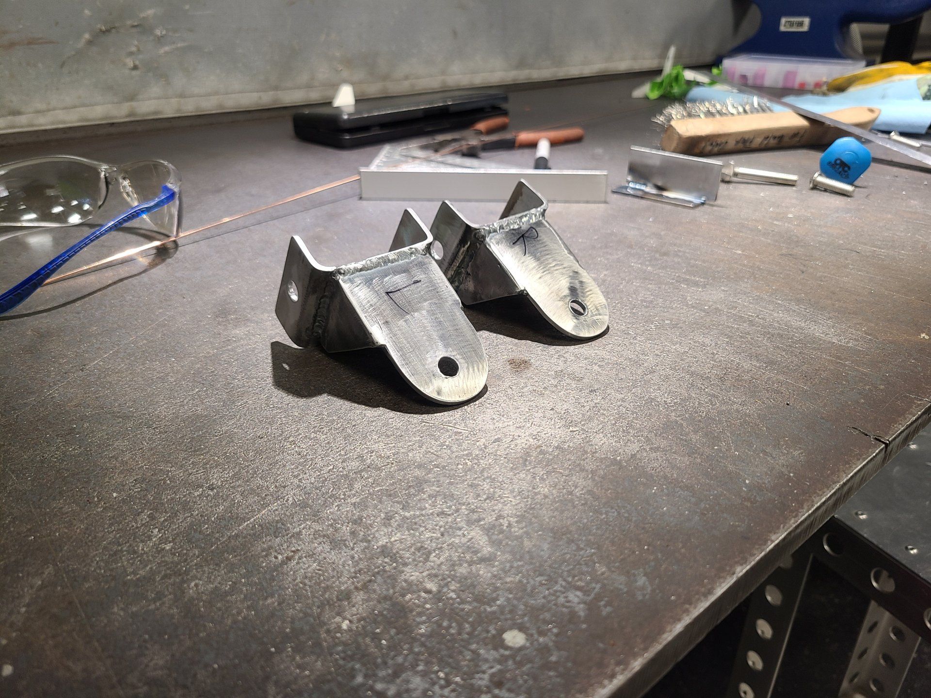

Ready for welding
Welded and drilled apparently. Skipped a step somewhere
Mounted on the rack but no hole for the light bar in this pic. What is going on here?!
This is the mount on the bar....

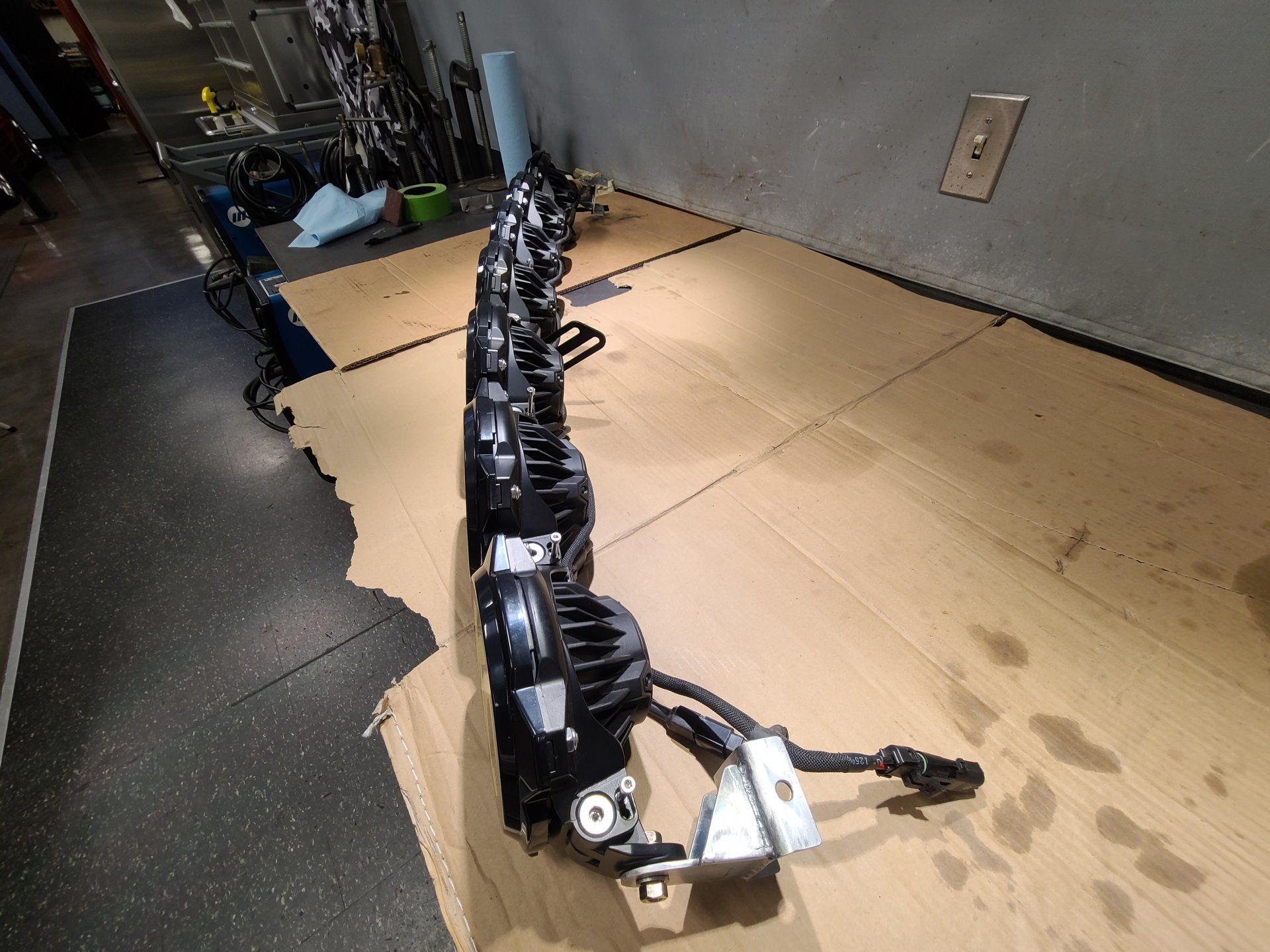

These light bars are pretty slick. They have a series of interlocking adjusters that link them together. They can be made to be straight, have a semi radius profile and have a deeper profile radius. We went with the deepest one. A couple of pins come out and get reset in a different position to lock it all in. The nice thing about our mounts is that they slide so as the radius increases, the bar becomes an inch or so smaller....the mounts just kind of slide to where you need them.
You can see the smaller set screws to the right of the larger Allen head screw. Pretty ingenious setup that they came up with.

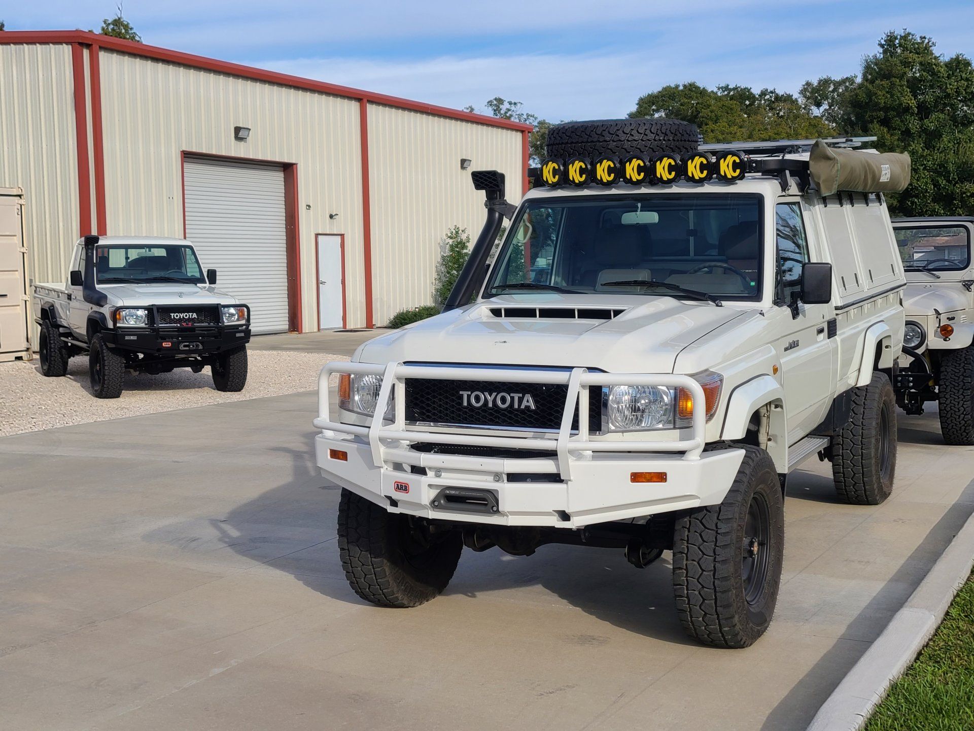

Mounted on the rack. There is a center mount that we will make tomorrow....then do some powdercoating and install this thing. And probably wire it too :)

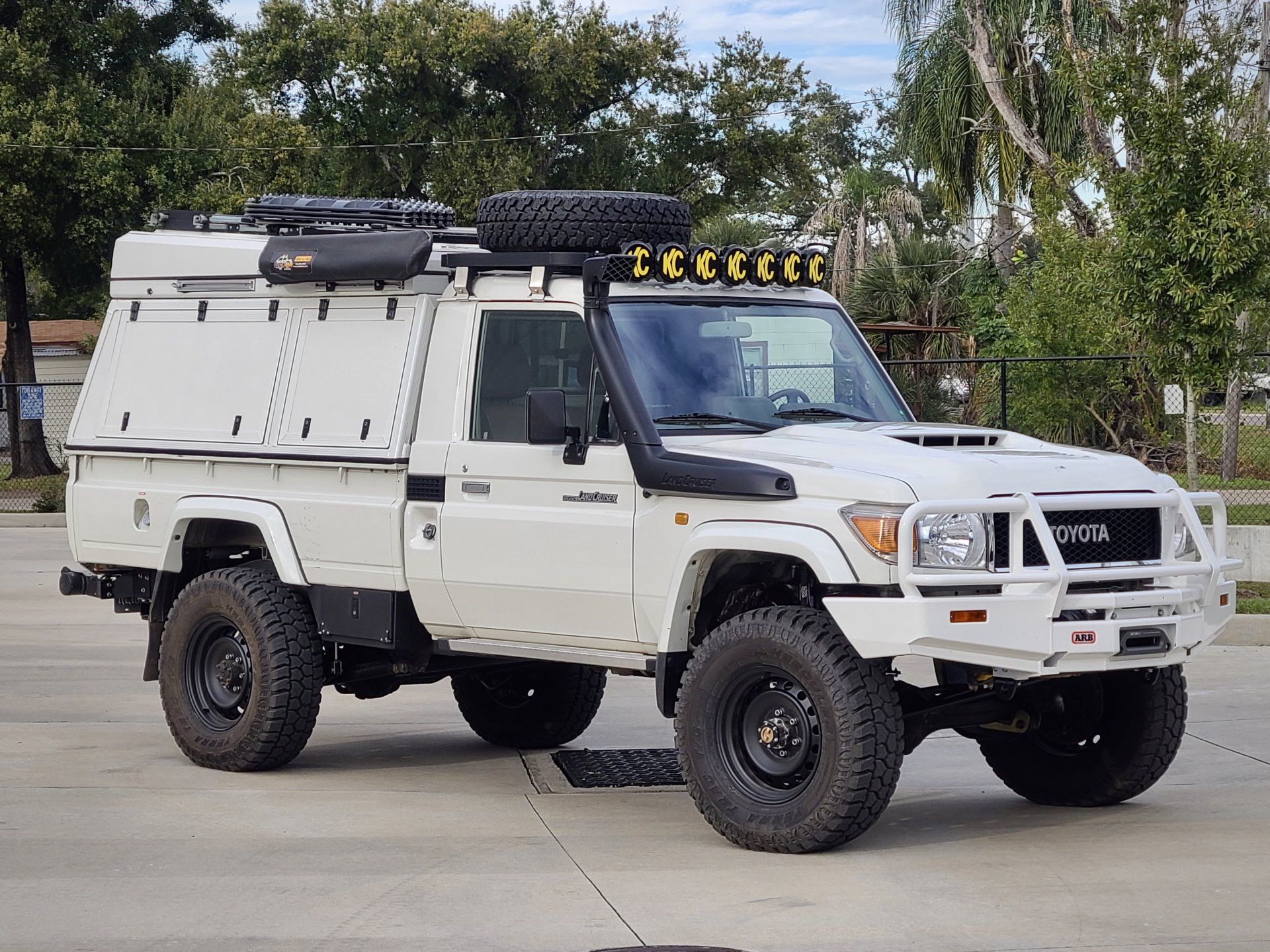

Well....... in almost 9 years, this stuff that arrived on a pallet has gone from this....
To this...
And I couldn't be happier :)
