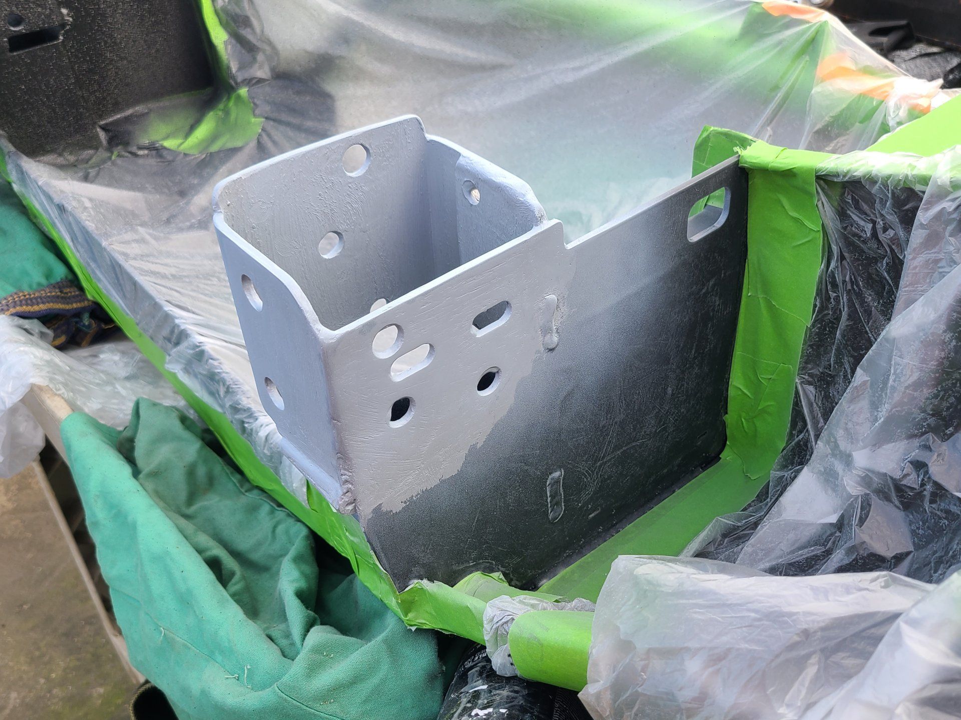

Tomorrow we burn these puppies in and move on to the next phase....drilling out some holes and painting the bare metal areas.
Welded in, cleaned up, coated, test fit, ready for some paint and a winch tomorrow.
Chris-
What are you guys using to drill that size plate? Drill press? Bit type?
Thanks.
Sometimes we use our drill press but usually we just work our way up with stepped bits and lots of lube...these were done with a 18v Makita drill.
I bought a set of stepped drill bits at Northern Tool for a project at my house 4 years ago.......there was a huge one in it that I needed for whatever reason. I have not been able to kill those bits and I'm a pro at killing drill bits. I'm sure they are on their last legs(steps?) now but they have been great. It would be shocking to know how much material these have drilled thru. I think we've killed 2 Makita drills in the time we've had these. Ha.

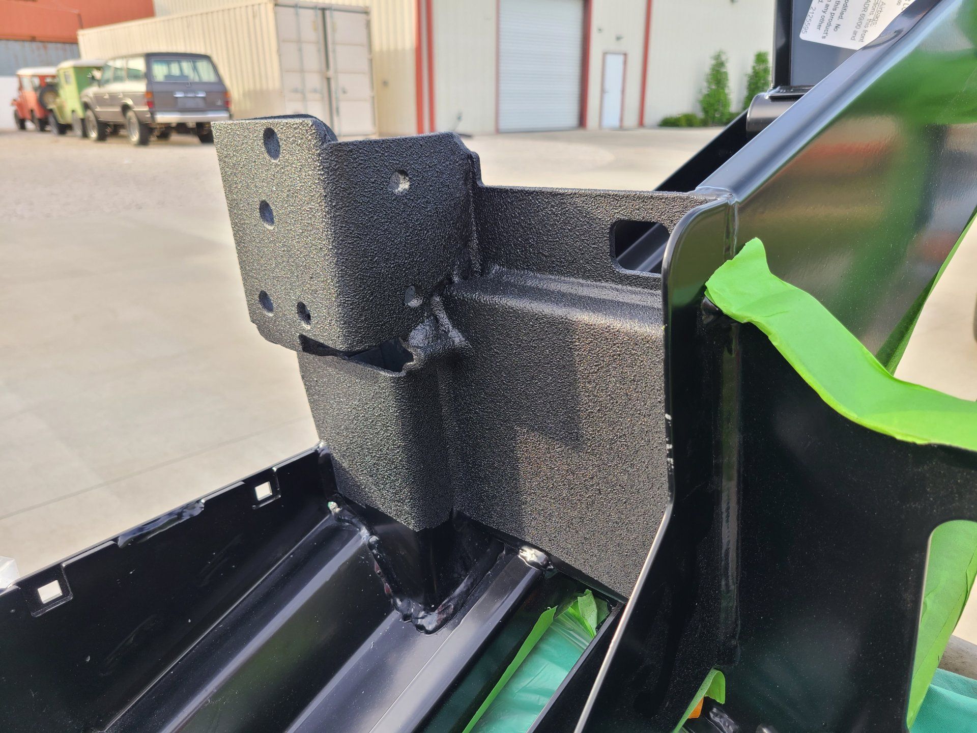

All done with the bumper. I'm glad I don't count the hours we spend on things when it comes to my projects. Too many hours.
We'll leave the bumper off for a few days....installing a few things under the hood and working around the bar is a pain.

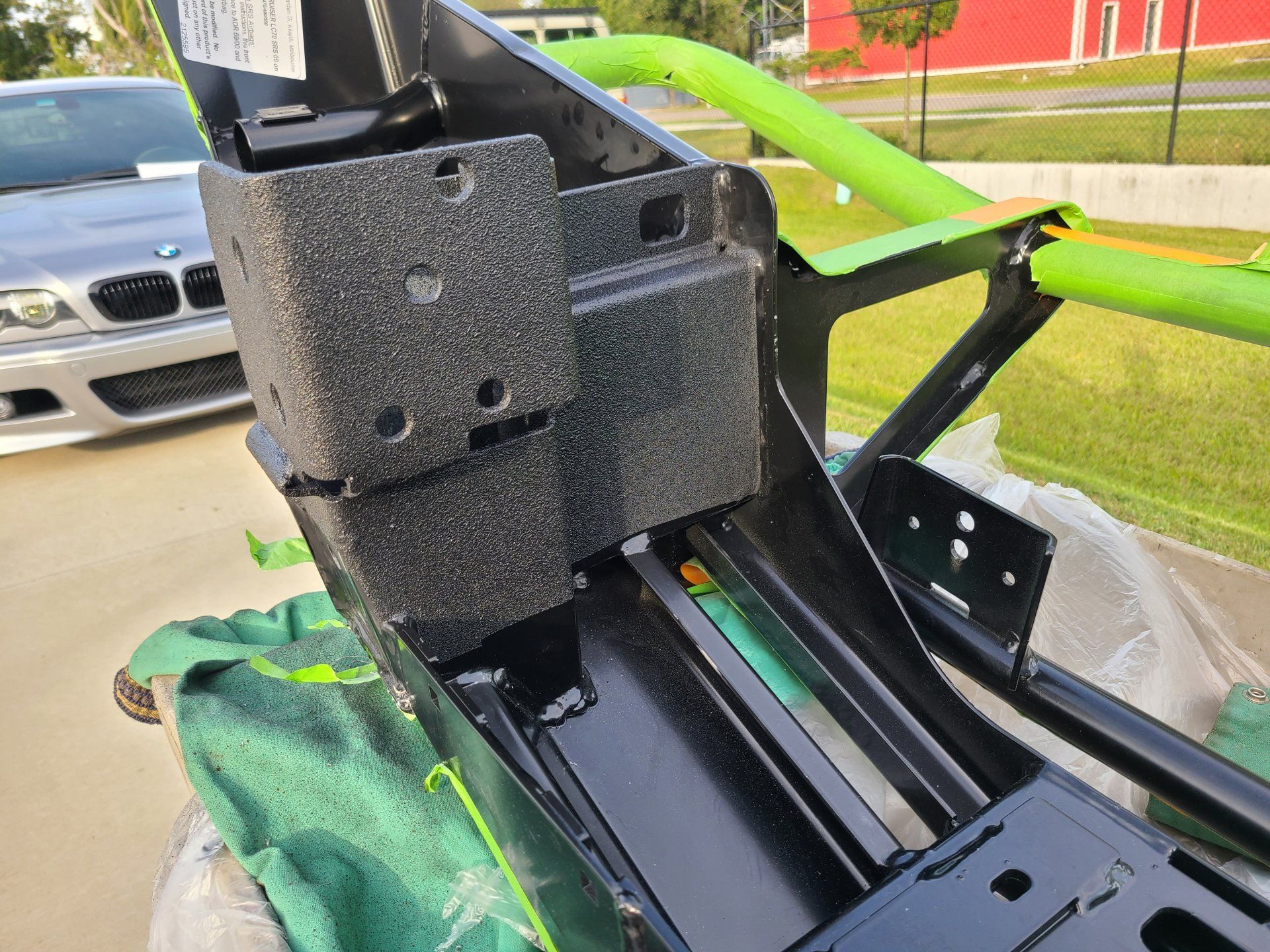

Apparently nobody read this warning sticker....oops.
Sanded and primed the Master Series paint....I brushed it on and it left a lot of brush marks(it was far too thick) but no biggie since we were going to be spraying in some Raptor.
Raptor liner sprayed in once the primer dried. I love this stuff. Fine texture like we normally shoot. Couldn't be an easier product to use.

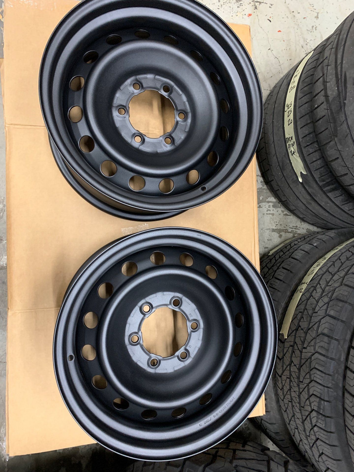

Had the wheels sent out for powdercoating.....the paint on these steel wheels almost immediately fades out...drives me crazy. No fading with the textured black powder. It's a great finish....has a cool sheen to it. The bull bar may go texture black at some point....or white
What size tire are you putting on those?
Need to think about this for a second.....I have 4 sets of these wheels floating around on the trucks. These are FJ Cruiser spares...so 17x7.5. We are running the 285/75/17 Hercules on them.
