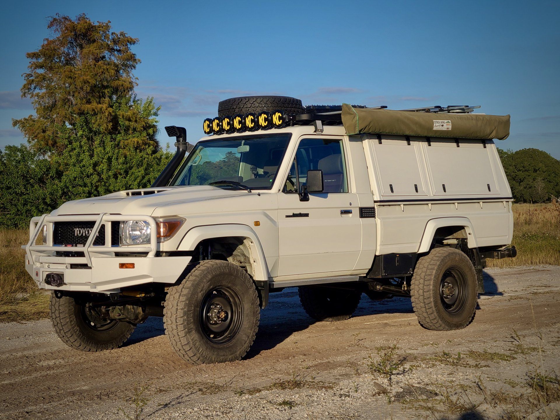

I love this thing....between the diesel swap, the part time conversion, Dobinsons suspension(HUGE upgrade) and 34s...it's just a really solid rig. The interior changes with the gauges/headunit and additional sound deadening make it even more comfortable....especially with the heated Scheelmann seat. It's still the old truck I know and love but it's way way different now. I have always had a soft spot for this truck....now it's even softer.
I was able to dial in the tuning to where I think things are good. Probably using a bit more fuel than I should but I really like how well it goes(gets up and moves out for a big heavy truck). EGTs are under control. Boost is at 15psi. It sounds really cool too.
My first normal tank was about 14.7mpg.....not good in the world of diesel but I'm driving around a house. With a tire on the roof. Not good aero at all.

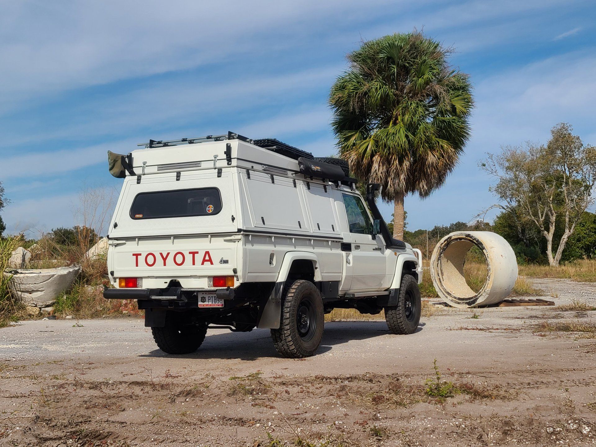

This rear end is going to change....starting to collect the parts for a spare tire swing out. It's time to get that tire off the roof. Kind of excited to be able to have a trasharoo or something on the back of the truck too.
