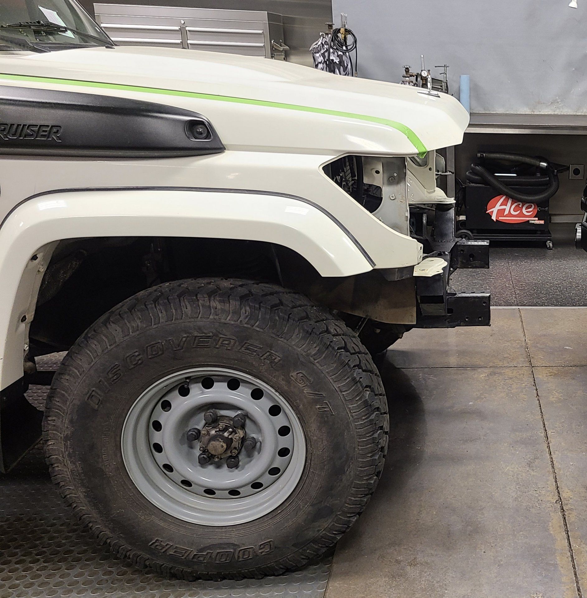

Finished with about 80% of the lift today. Gained 4" over where we were....which was on stock height 80 springs. The truck always felt like the height was great but it was really low. Once we got the last truck done, it was very apparent how low #1 had become(or always was).

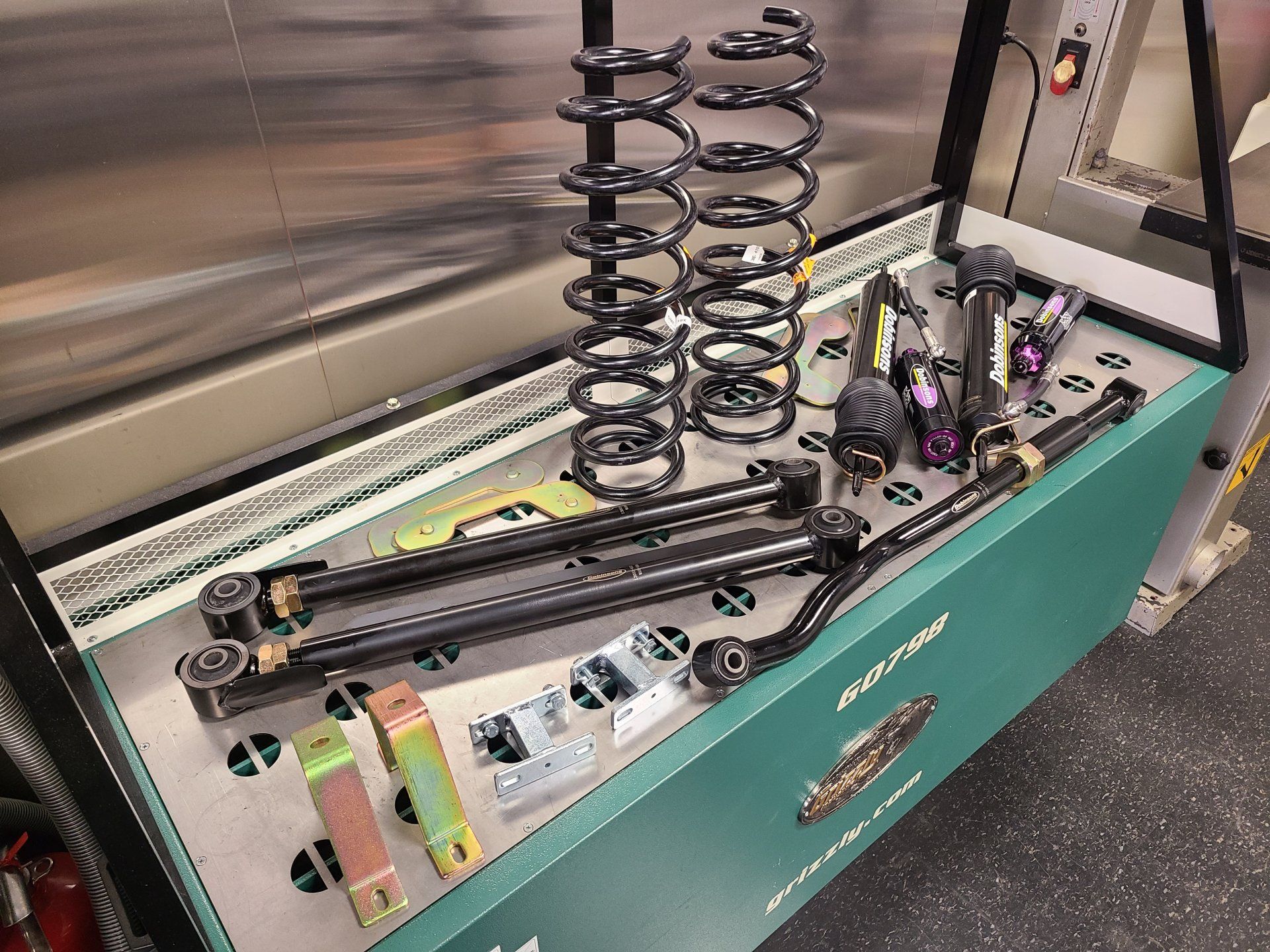

Lots of good stuff. OME 4" competition coils for the front. Probably will be aggressive without a winch/2nd battery and bull bar but that will all change down the road. Dobinsons MRR shocks on this one too. Rears on back order so maybe next week for them. Dobinsons lower control arms for the rear....80 series stuff obviously. Very nice pieces. Impressed every time we get stuff from them. Sway bar drops and some @landtank 4" caster correction plates.

These MRR shocks are really impressive.....trying out different settings on the #2 truck to find out what is best. 3 way adjustable.....high and low speed compression as well as rebound.

33s are looking pretty little now.
I didn't take a before today but this one was from a few weeks ago.
