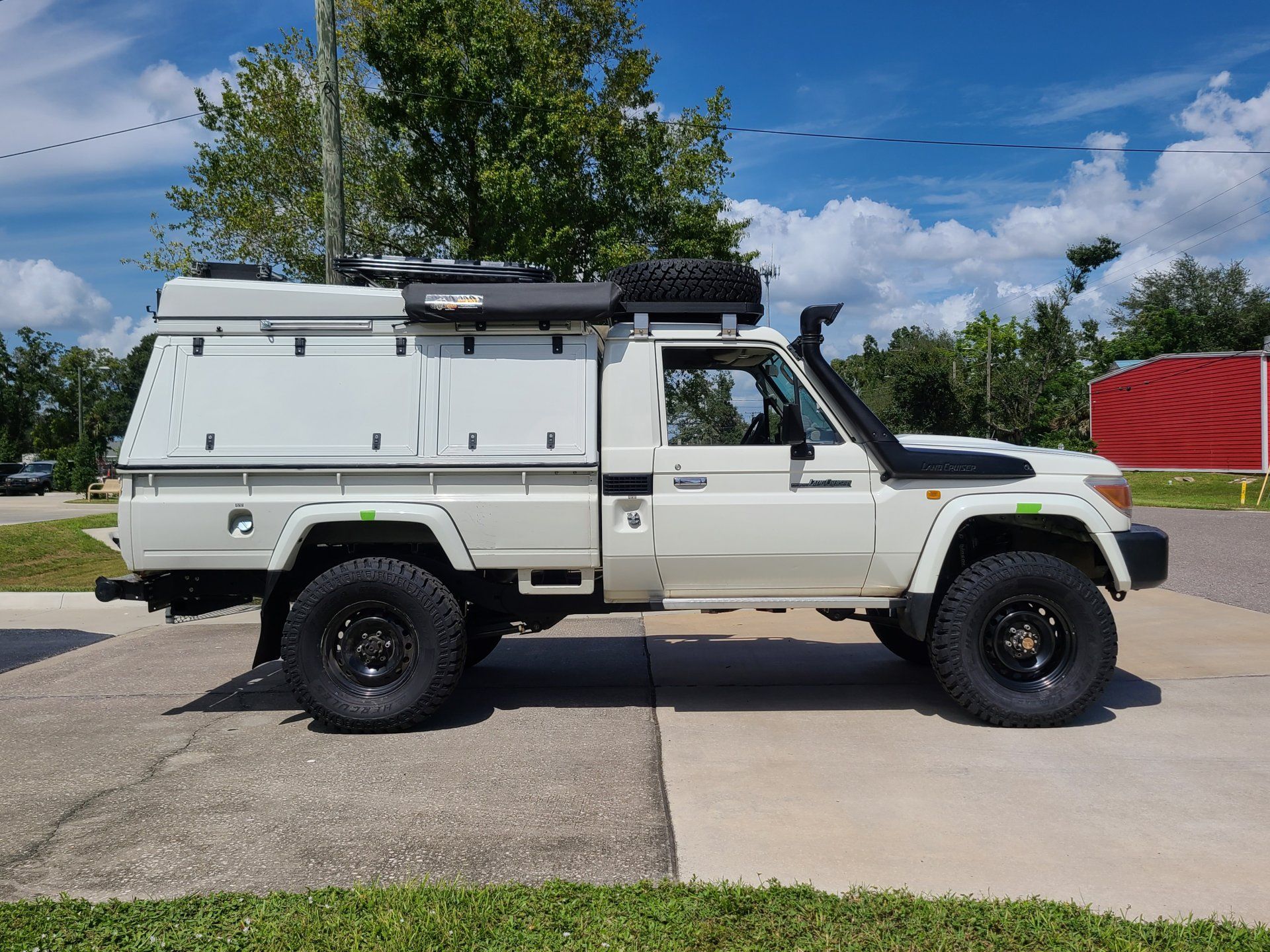

#1 meet #2....not quite on level ground....rear of #1 is on the concrete..about an inch higher than the rocks.
Level ground. 33s look like 29s. I remember when 33s seemed HUGE. I kind of have a feeling these wheels and tires may go on the Troopy at some point.

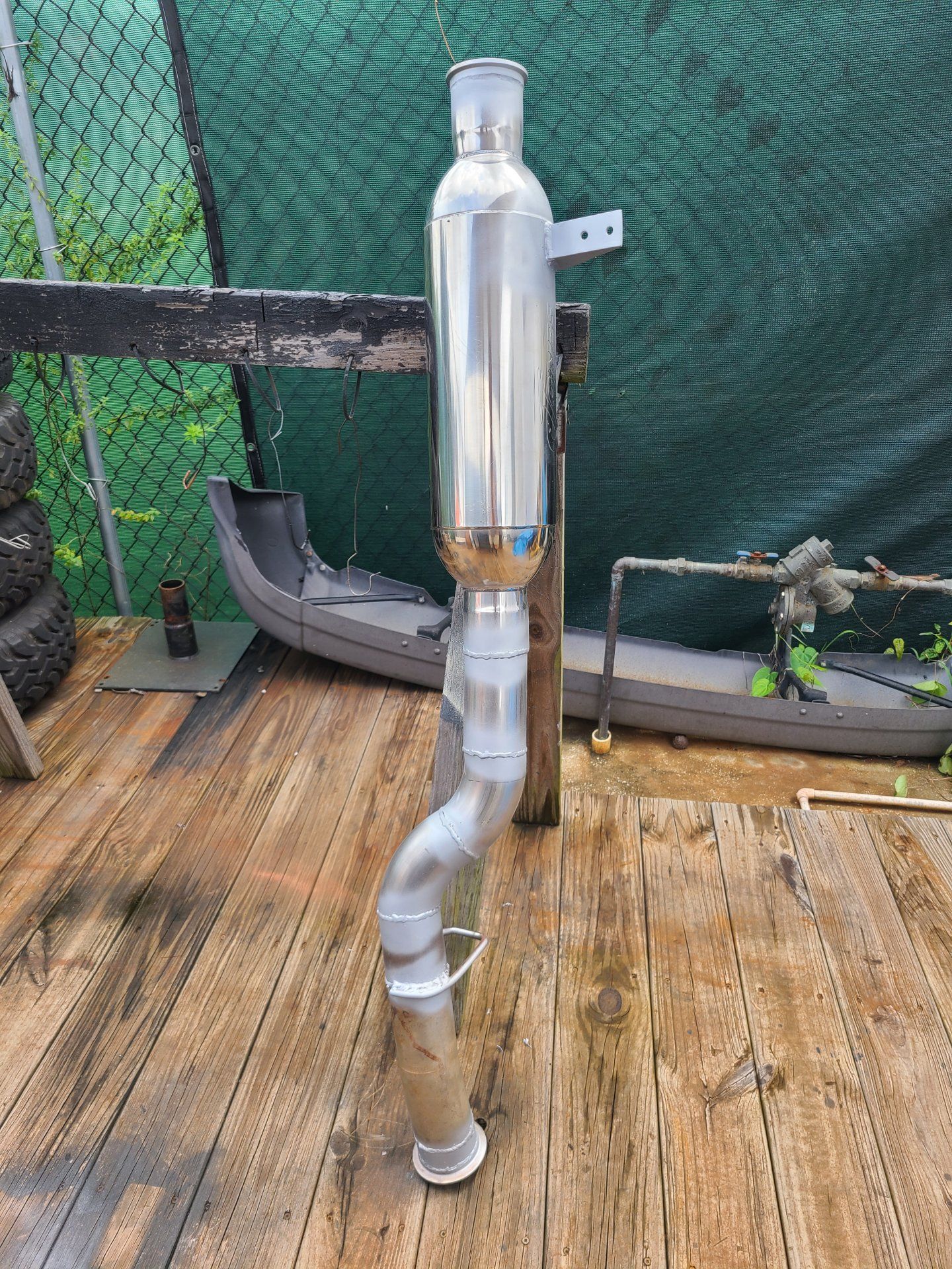

Spent this week working on customer work but had a chance and was able to build an exhaust for the truck. More like just a section of exhaust. Really happy with it. It's quiet and I think it flows really well....3" all the way from turbo back. Aeroturbine 3030XL muffler. We had a small resonator from the old truck that we left on....even left the old cat on but gutted it out. At some point I'll take that portion out but not overly worried about it.
Old Cadillac Escalade ESV muffler.....only way I could get that 1FZ to be quiet. HUGE muffler. I hated the way that 1FZ sounded.
Our little baby resonator....this crosses over the top of the transfer case
Muffler section
We have been trying to build the exhausts to use the OEM Toyota rubber mounts for support. I really like them sitting on the rubber mounts vs being suspended from them. This exhaust however has a couple of both :)
Aeroturbine muffler needed a mount to be welded on.
Topside of the mount
Maybe one day we'll get this thing thermal coated but I doubt it.....maybe coated with dirt. REALLY challenging to route the exhaust thru the rear coil sprung suspension....with the new lift it was a little easier....more room.

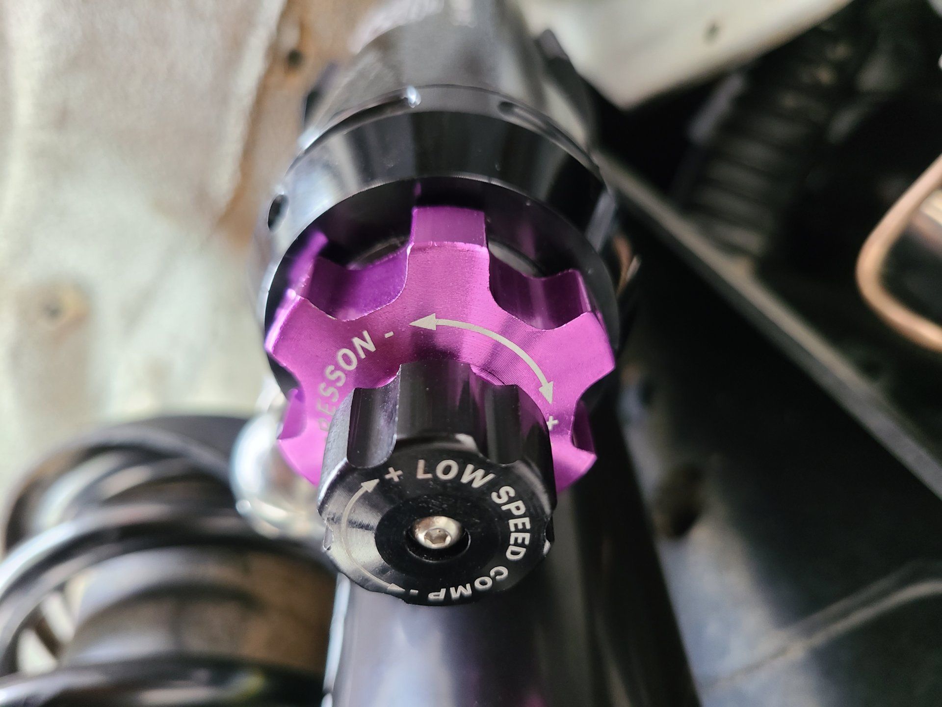

Also playing with shock settings. The Dobinsons MRAs are SUPER nice....but they certainly need some setup. So far it seems like max high speed and low speed compression settings with minimal rebound feels best on the road for this truck and the springs it has in it. A bit like a boat when they are lower. Off road the lower settings will be great.
Settings for the high and low speed on the reservoirs.
Rebound on base of shock....under the boot which is why it's not secured just yet.

Swapped the 35 to the rear this AM.....looks pretty good.
Pokes out more than I am used to on this truck but maybe I need to expand my horizons...

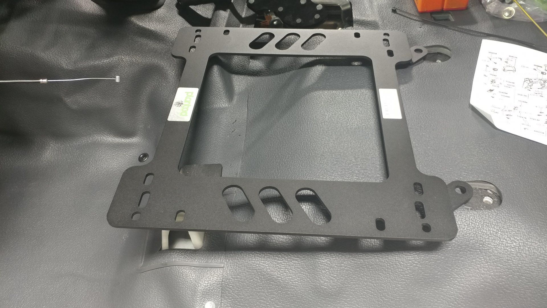

Modified the seat mount bracket today.....same thing as the #2 truck. The front mounts get cut off and moved about an inch forward.....the rears bolt right in that way.
#2 truck's bracket....this is how far they're out. I believe these brackets are for a 75 series truck.
Front tabs cut off, moved, welded, painted.
Fits just right....just needs a seat to go on it. Tomorrow that happens. We used some black texture spray paint to blend in the areas we had to grind for welding and the top side areas that got burnt off during the welding. Hard to tell it was even modded.
Got the seat in....learned something interesting today. On #2, I ordered a LEFT side Planted seat bracket. The Scheelmann supplied seat tracks fit right on. Ordered the same one for this truck, the Scheelmann supplied seat tracks did not fit right on. I was discussing with my tech who has Scheelmanns in his F250.....when he bought his planted brackets, they came 2 different ways...for Recaro....or for everything else. So I'm guessing that Planted has 2 tops for their brackets...one for the Recaro(I want to say they were about 1/4" off) and one for other seats tracks. I must have got the Recaro one. We popped a couple of new holes in it and all was good. Kind of a head scratcher though.
Number 1's bracket....seat fit right in.
Not off by much but just enough to be a real pain. Way easier when they drop in.

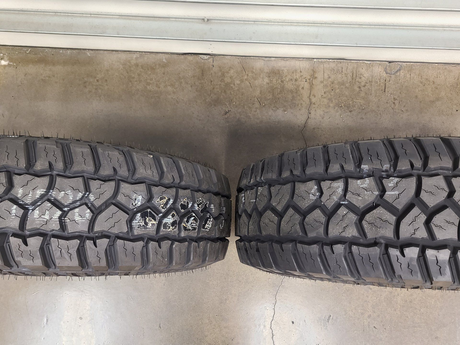

315/70/17s vs the 285/75/17s(on the left)
315s
285s
315s on the passenger side, 285s on the drivers side
The winner is the 285.....mainly because it fits the rear better and it's rated for a 7.5" rim....the 315 specs an 8 and up.
315s sure look good but the rears are a little too big....

Any rubbing at full lock with the 315?
Both look good to me, but obviously the 315s look better 😀
Didn't feel any rubbing....I'll check it out closer tomorrow when I move it in the AM. I think it will be OK. Not sure how it will do in the rear under compression....might rub. That rear axle pokes out just a tad too much. Kind of why I liked the skinny wheels and tires BUT....these do look good. And yeah...the 35s are better :)
