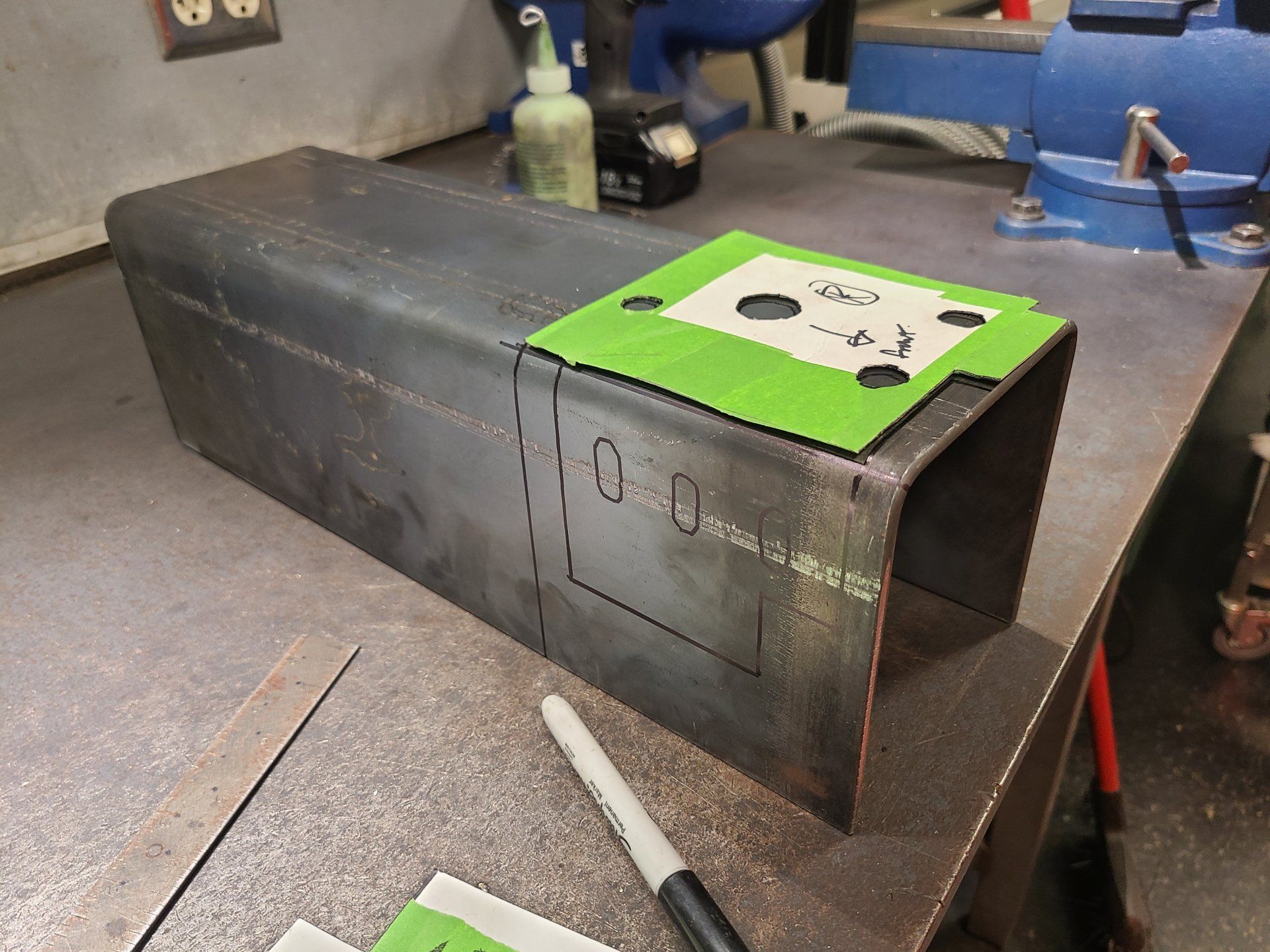

We start by cutting the inner walls out of the bumper where it slides on the frame. We will re-use that cross bar.
Lots of pattern making on this project. We'll transfer this to the U channel we are having made along with the 3 other sides.

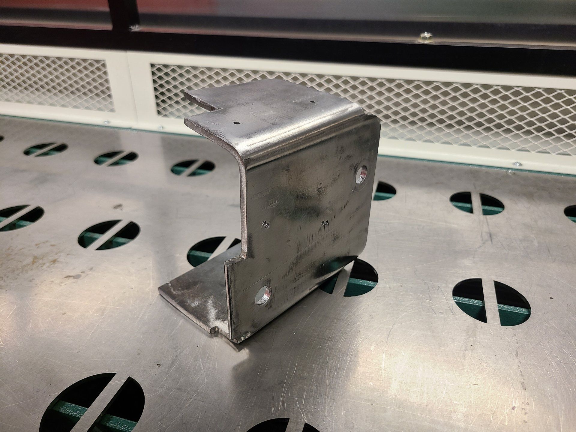

The sheetmetal shop bent this piece incorrectly. New one in the AM.
It will get cut up and put here
Which got prepped for it's big day of welding tomorrow.

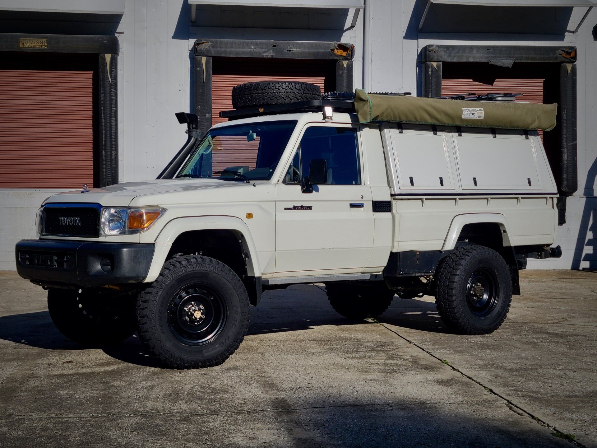

OMG.
I want!!
Beautiful. Amazing. I would love nothing more that to take that rig for a spin.
Special truck!
OMG.
I want!!
Special truck!
If you're in Tampa, stop on in and we'll go for a ride :)

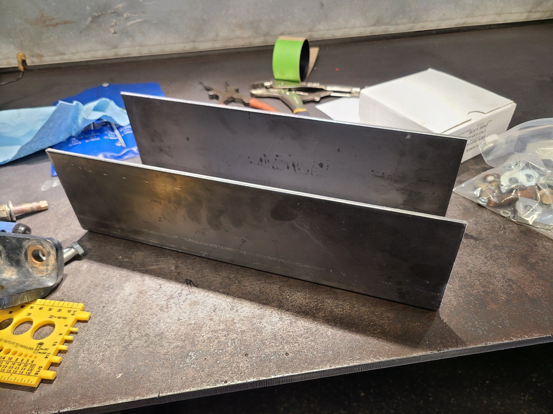

Another day, more bumper work.
Picked up our correct piece of metal....patterns made and transferred.
Lots of cutting and shaping
