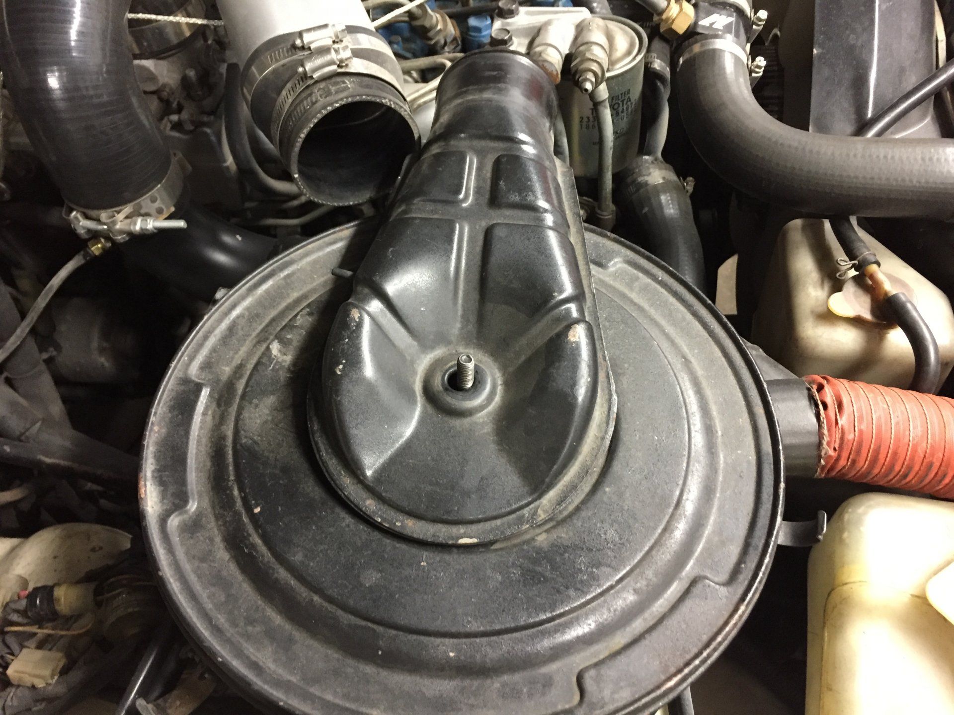

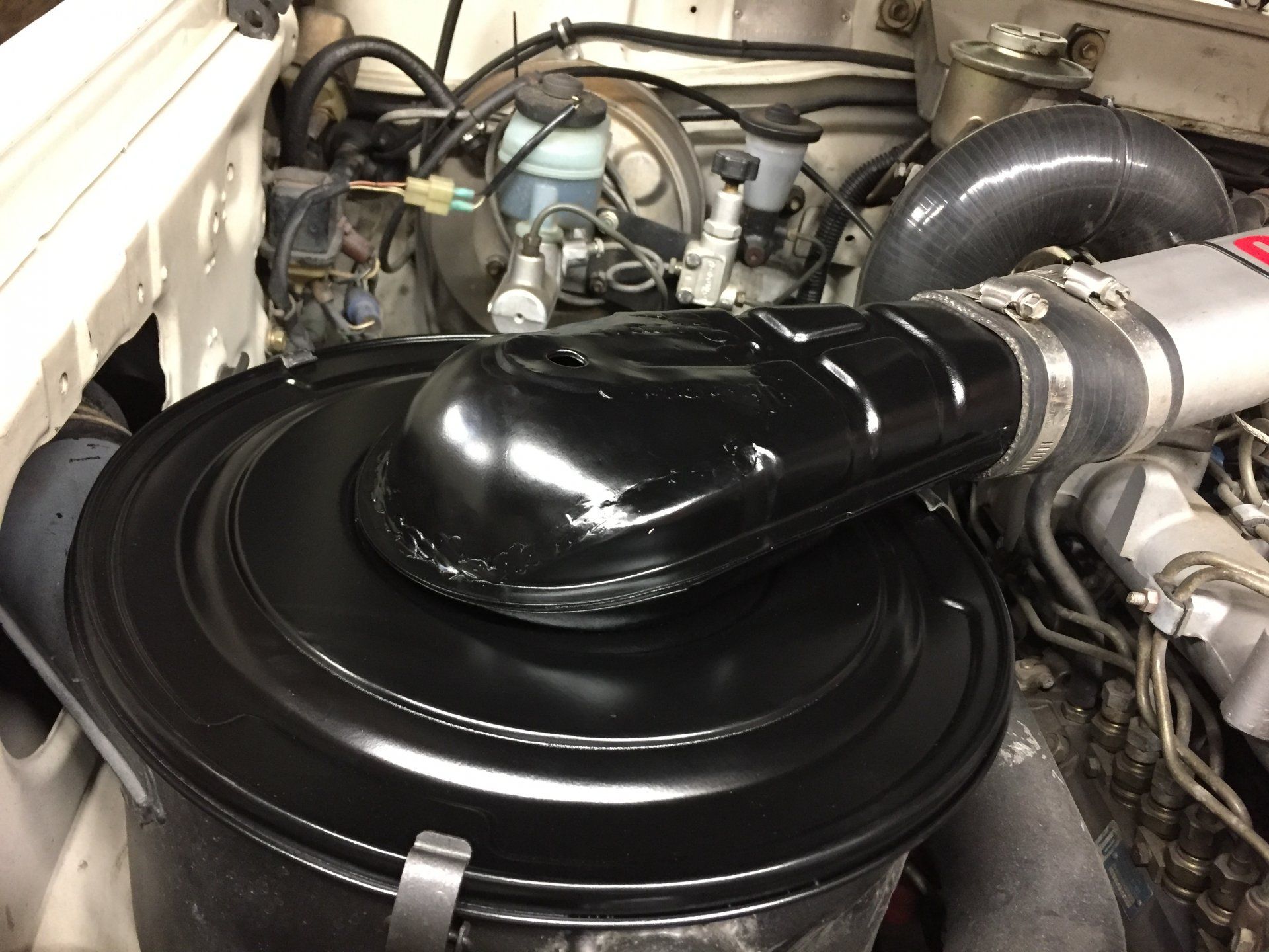

Question about the mounting of the air clear base. Where exactly is it suppose to bolt up? I got one from Onur that was suppose to be for the right one for my year 79 but it won't bolt up and work with the factory snorkel.

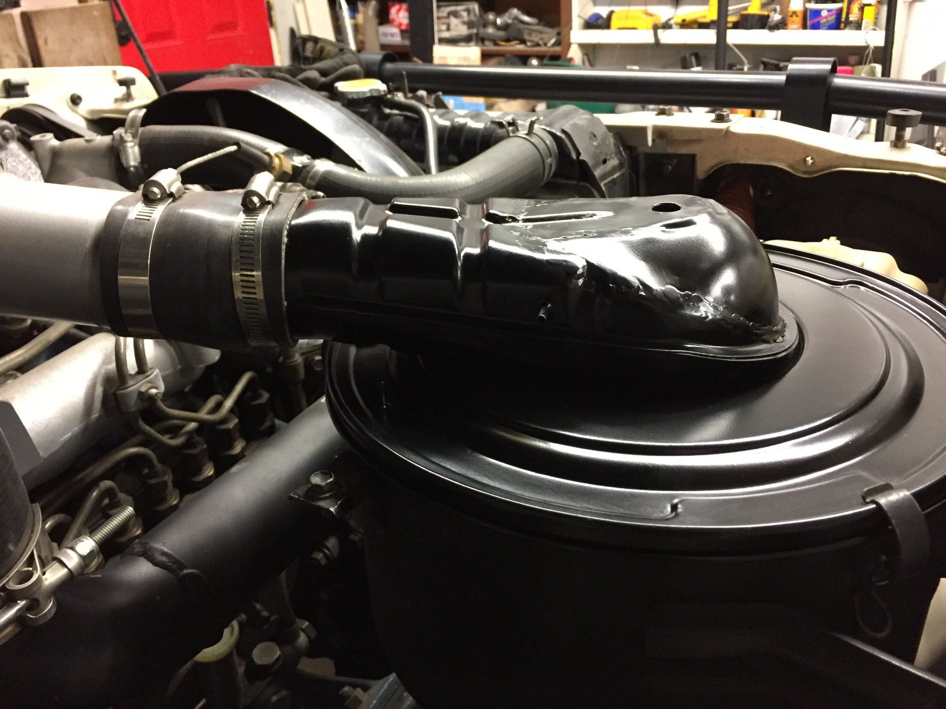

On my #2 truck....it bolted up to the fender......but we had to make a base support I think. There may be some kind of factory bracket we were missing. That filter assembly was from the 2014 HZJ76 that gave up its interior. I do believe the lid was from Cruiserparts as a take-off since I wanted a HDJ style lid for the turbo setup that has the 90* downturn.
This truck is all kinds of weird because we placed the air cleaner all the way forward to clear something on that passenger side fender. It was from the 80. We changed around the feet on the base....and in looking at the fender, we drilled a couple of holes to mount it on isolators along with making a mount for the inboard mount(holds the AC dryer too....a multi-tasking mount if you will). Snorkel lined up with some shenanigans connecting it to the OEM snorkel. The 1FZFE has a nice big inlet.....so it would appear that we just clocked it a little different to line up the inlet towards the snorkel.
Yeah I toyed with modifying the 80 box but figured it would be easier to buy the one that bolts in. Well I should have know that it wouldn’t just bolt in. I don’t think there has been one thing on my truck that was a “bolt in”.
Thanks for the pics. I think there is a bottom bracket we must be missing.

After taking apart this truck, I realized just how much was one off. Everything was made to bolt in. Very different animal vs. #2 which was way more bolt in. A few brackets here and there were made obviously but most of it just fit in.
An 80 box will work nice......cheap and easy to modify to work. That would be my go-to if I had to make one again.

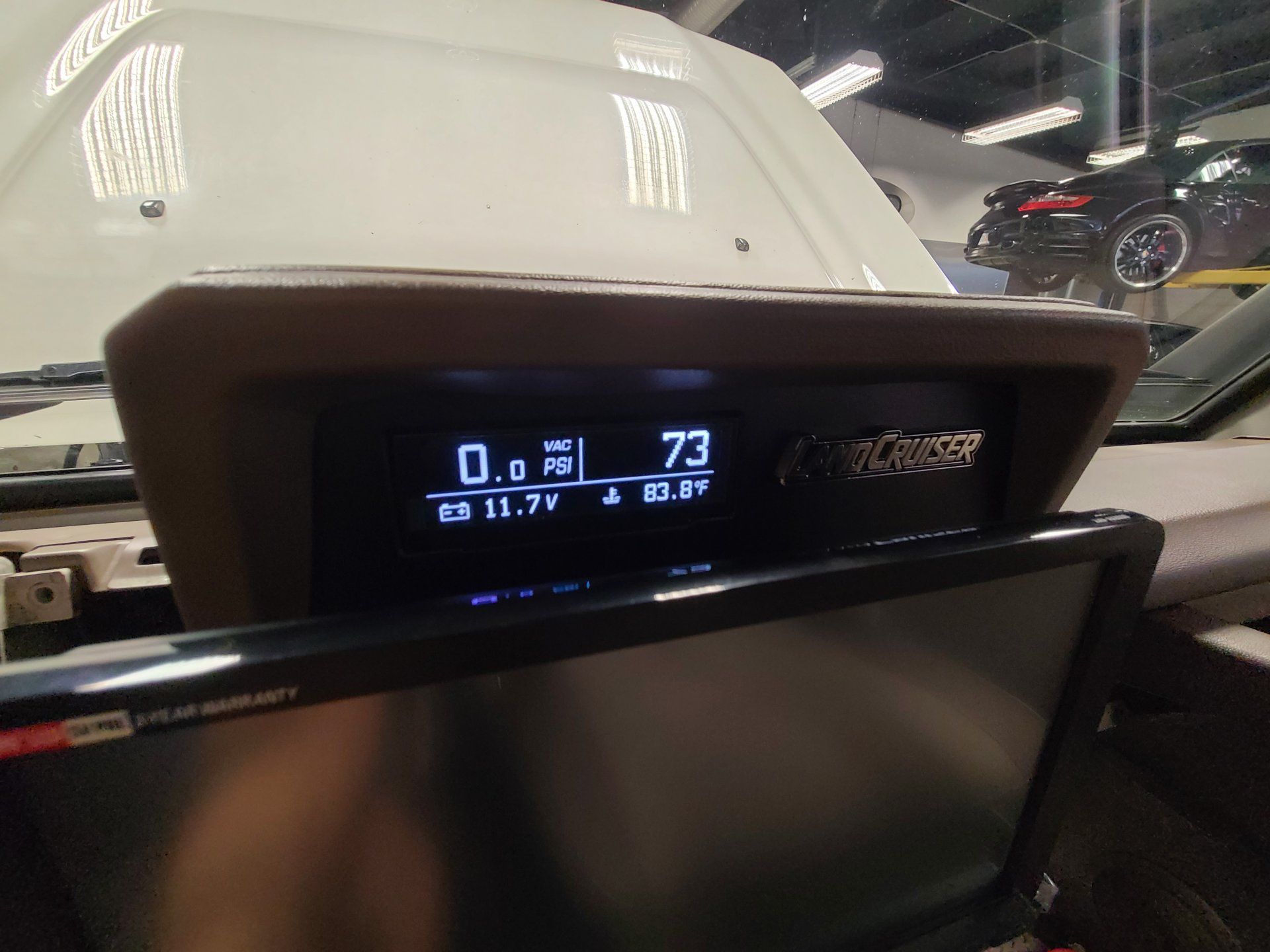

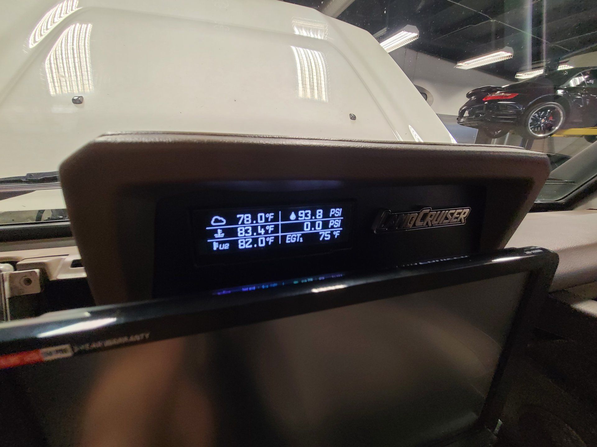

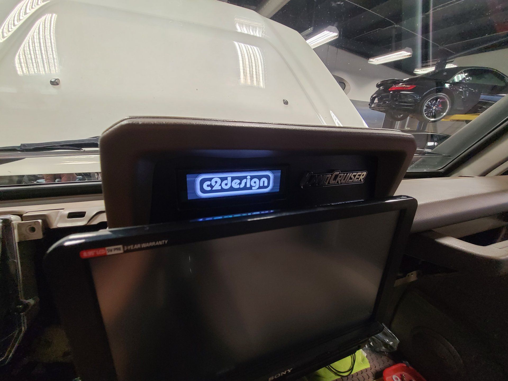

We dialed in our gauges today so we could keep an eye on the motor.....I really dig this gauge setup. Really has a good amount of info. Also allows for audible alerts....we set ours for EGT, water and trans temp.
The all important opening display image
There are a ton of screens....we take out a lot of stuff we don't use. Mostly fuel mileage stuff. This one is too small for my liking but lots of info....outside temp(cloud), drop with 93.8 is oil pressure which is not hooked up, 83.4 is the coolant temp, boost next to it, U2 is temp for the transmission(they didn't have a transmission icon) and then of course EGT.
This is the screen I tend to use all the time....boost and EGT are big(way easier to see) and then the bottom smaller readouts are set by the user. Voltage, temps, pressures as well as miles covered(trip and total) and speed(mph), time too. There's an RPM readout but we can't get that to show.
When you power down, there is a trip recap screen....time of trip, average speed, top speed(v max) and fuel used if it's setup.

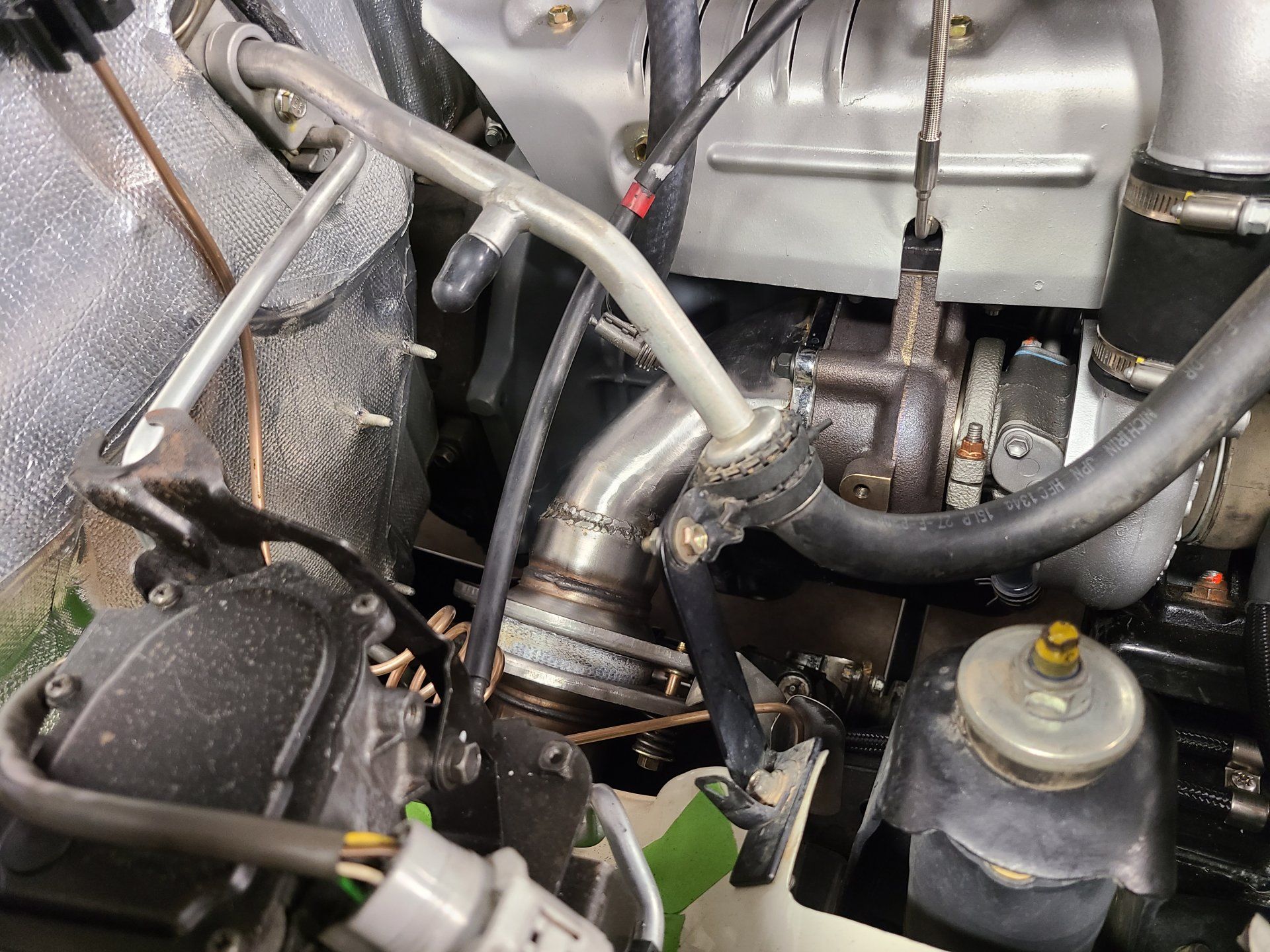

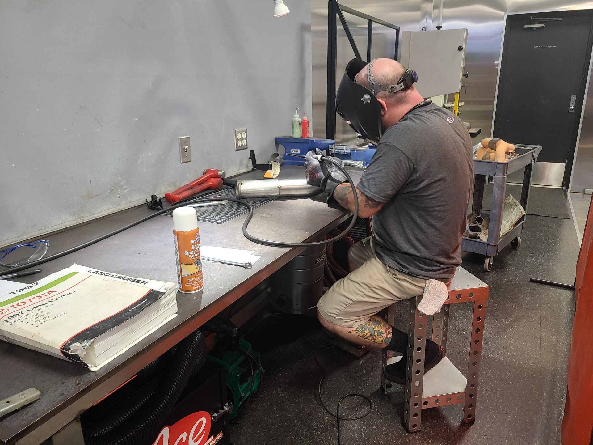

Built a downpipe for the truck over the last day or so....I did a HORRIBLE job documenting it. This truck will have the exhaust running outside the frame.....for now it will tie into the old exhaust since it's 3" and existing. Way less work than a scratch built exhaust.
Started like this with a jig.
At one point it looked like this
This guy spent a lot of time at the table when he wasn't test fitting his creation
And it's installed! And that's all the pics I have of it.

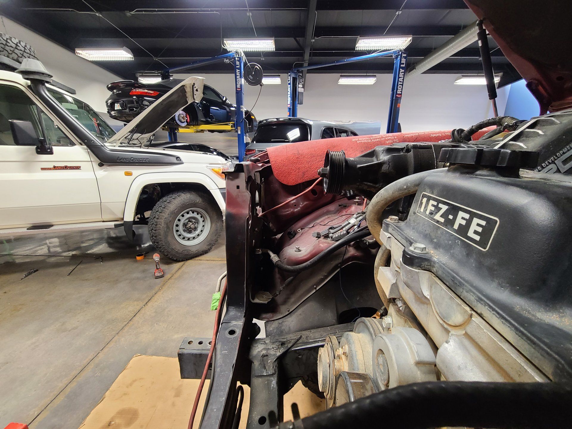

Funny how things cross paths and happen in the shop.......one of our 80 series customers had a motor go out in his truck(ran it out of oil..."fixed" at another shop....knocking nose came back...go figure"......just so happens we had a 1FZFE that had just come out of a truck. Today the donor and recipient were occupying the area.
don't you have room to run the exhaust inside the frame? that's what I was doing with the LJ-78/1HD-FT project, had it all mocked up, then sold that project.
We could have....the other truck is inside the frame. I need this truck ready to be on the road in 10 days....so for now it goes outside....plus that's how the old one was routed so it was way easier to make it all work.
We'll pop in a Aeroturbine exhaust to replace the big Cadillac exhaust that I had been using.....should have the Aero on Tuesday. We made this system modular so it's easy to make new sections.....easy being relative I guess.
