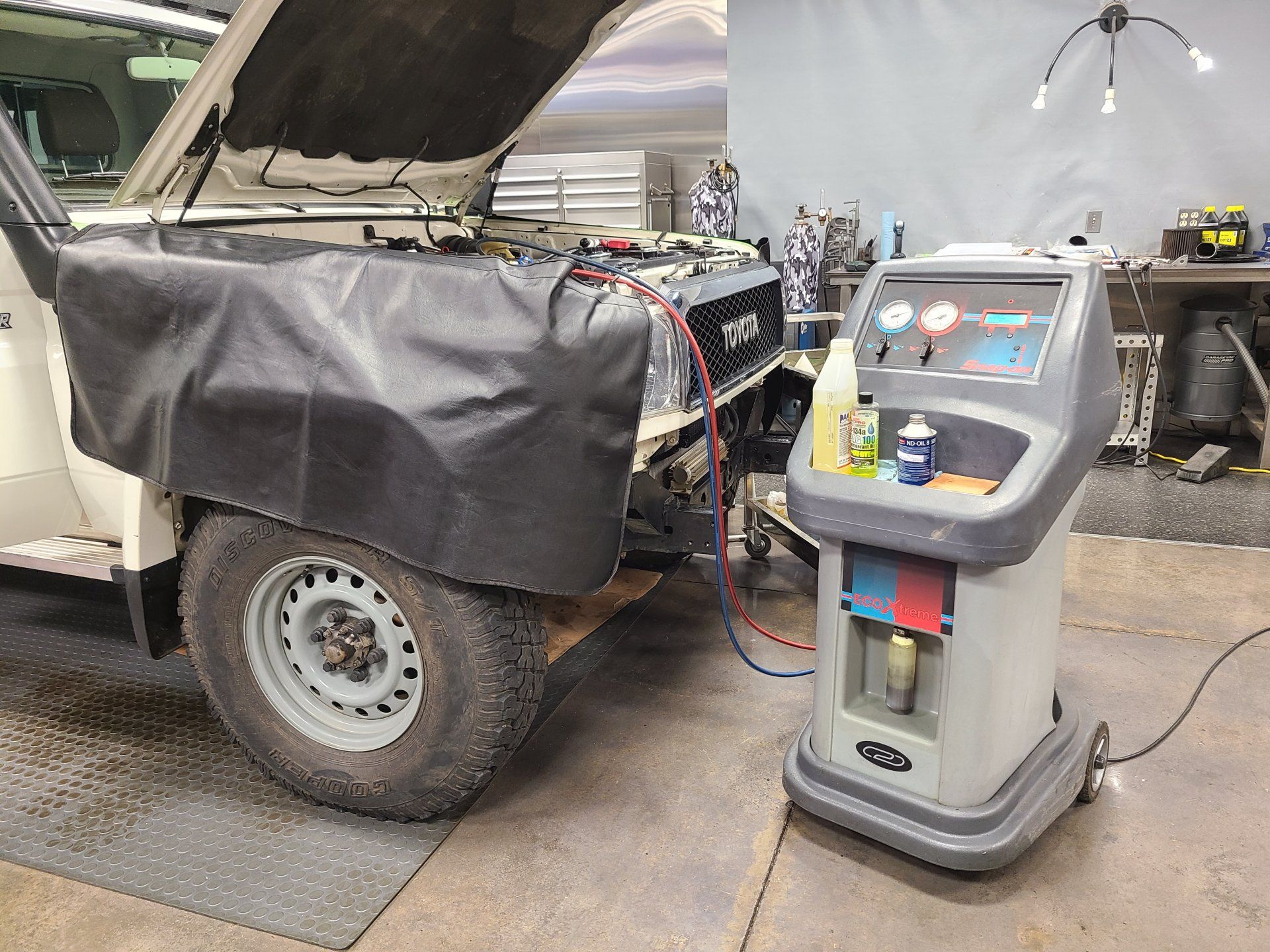

In Florida, THE most important thing you do is make sure the AC system will work...even before the motor starts.

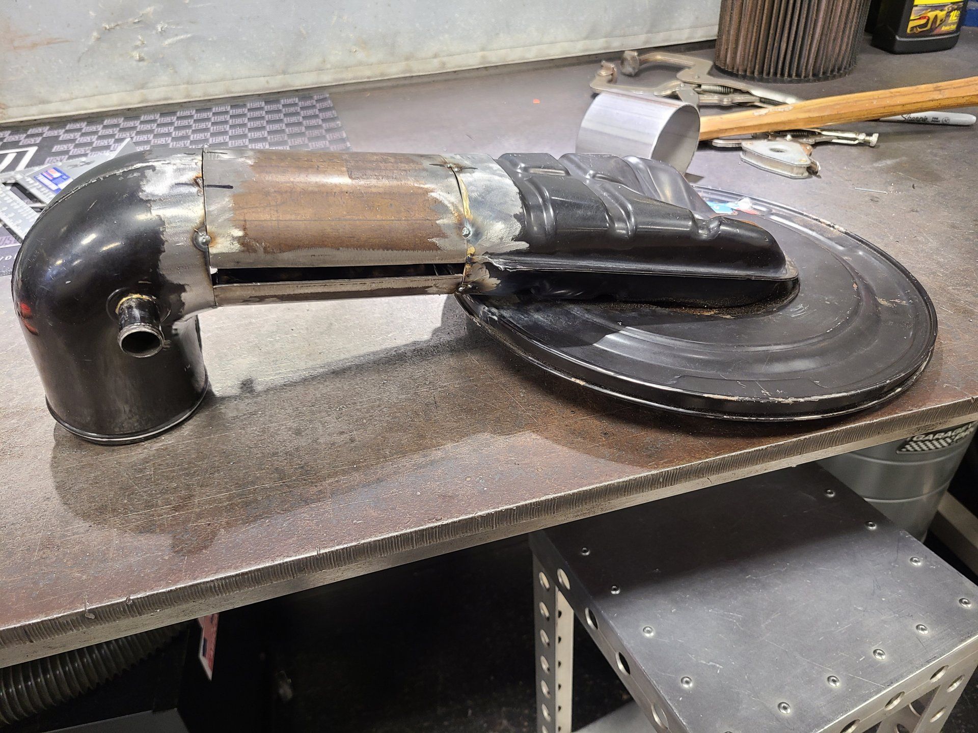

Started thinking about how I was going to get this to work. The air cleaner was built for the 1FZ but it won't work for the 1HDT's intake tube....
HDJ81 lid not really going to line up easily.
Cut some metal....and cut the lid....
Tacked it together....
Test fit....
This will not be a pretty piece...it's going to be temporary. There is one final slippery slope for this truck which will involve a winch, front bumper, second battery and related charging/switching setup for it along with the Safari Airmax snorkel.
The slope of slippery: Battery #2 needs to go where the current air cleaner assy is....that battery will be for the winch(maybe lights) so that of course means a bull bar and winch(and lights) need to go on(which is a huge job...79 bar going on a 80 chassis...lots of modification to make it work)........the air cleaner will have to be worked fairly heavily to accept the Airmax which is for a VDJ79......and after all of that, the air cleaner should line up where it will require a stock air cleaner lid for a 1HDT. Let the parts collecting begin :)

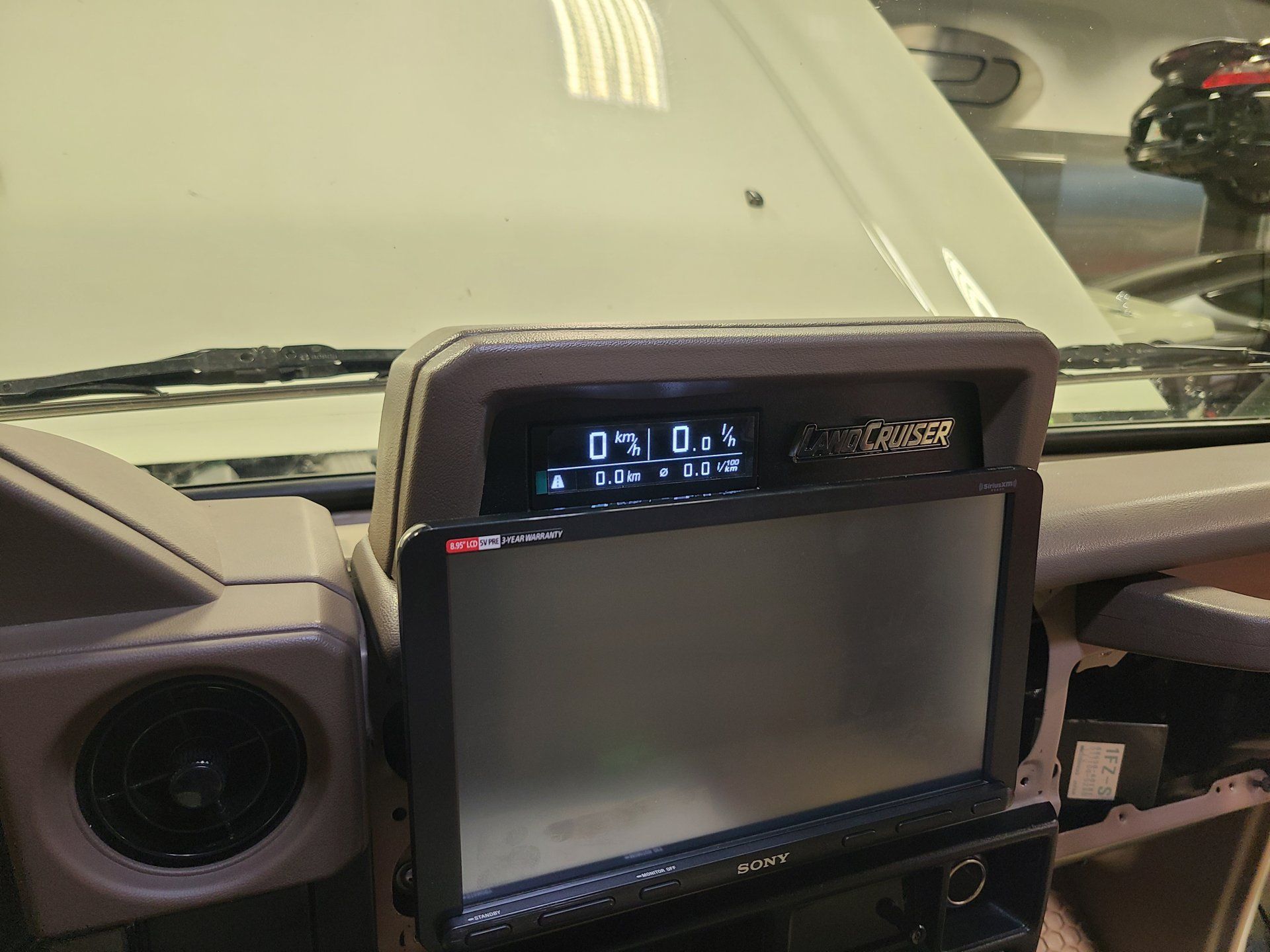

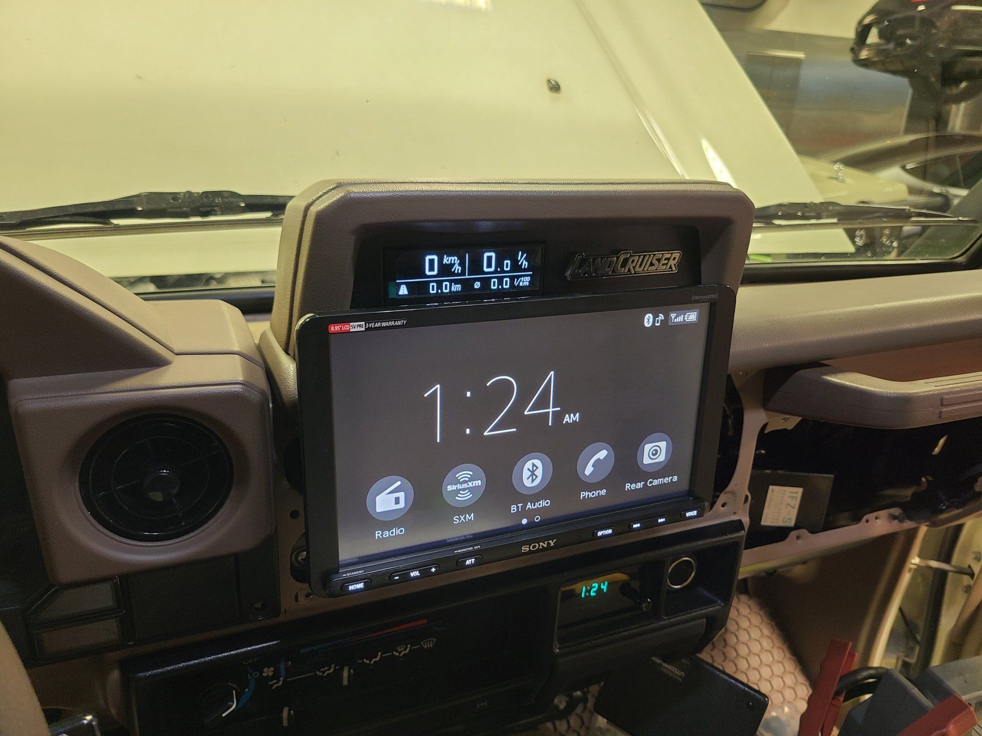

Popped in the shop to mount the gauge cluster. Did a quick test fire to see how the display looks...really cool. Used double stick tape to lock it down...not going anywhere.
Sony screen is huge.
From the back before the cover went on...

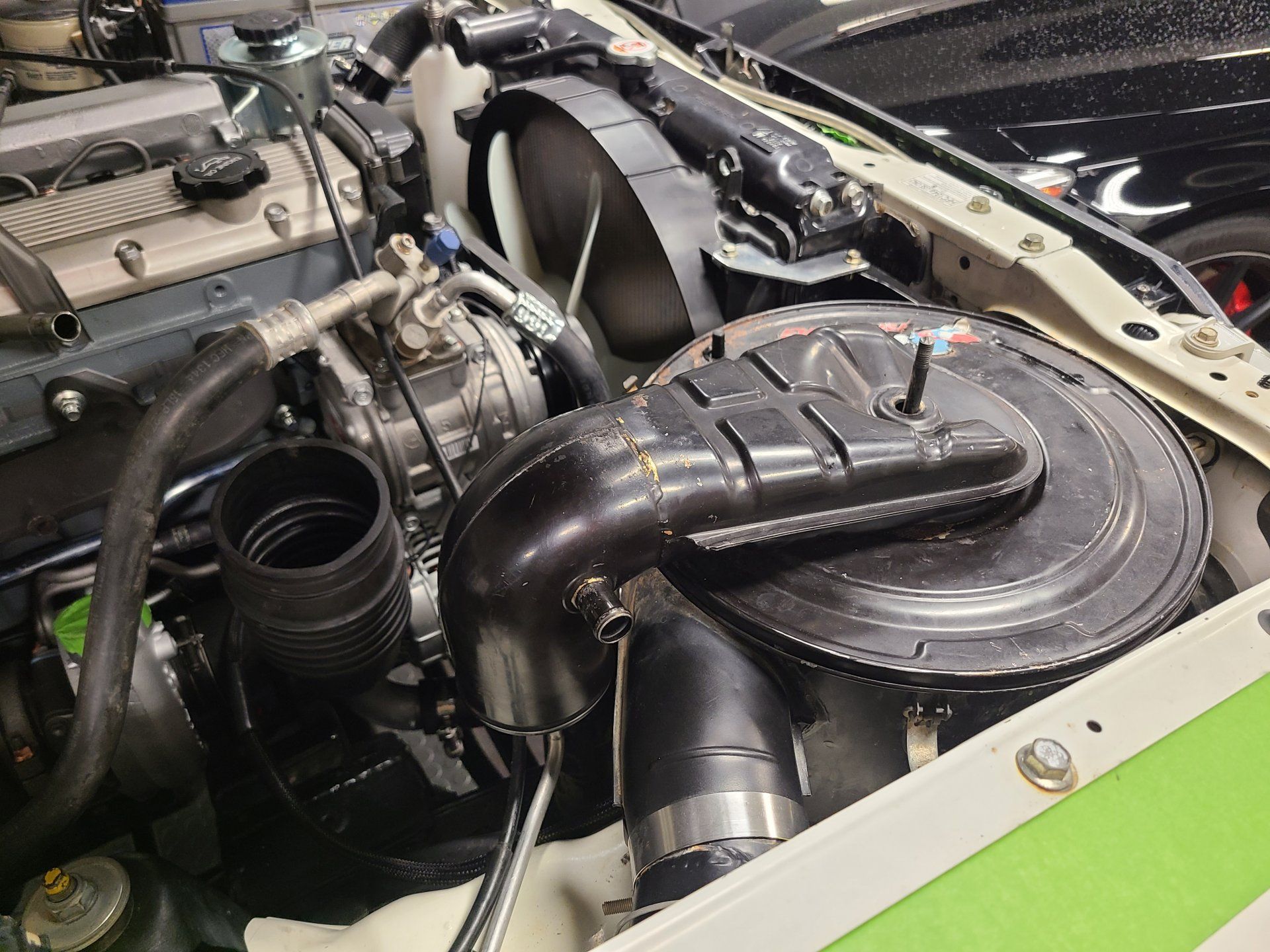

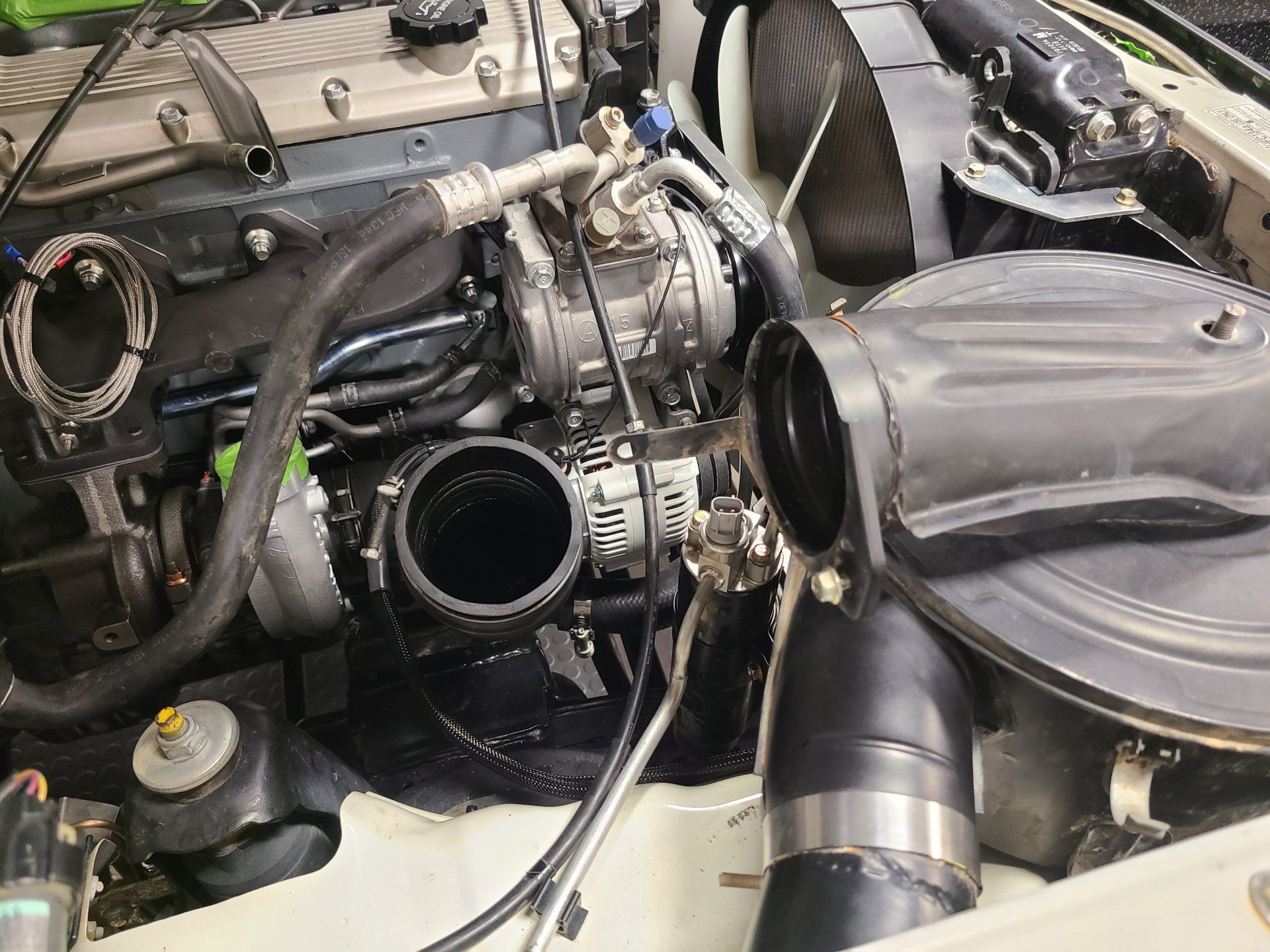

Finished the air cleaner lid......ended up cutting it in half once it was fully welded as I got a little worried that there could be a piece of welding wire in the inside that could get sucked into the turbo....so we cut it and cleaned out the inside. We'll use a silicone coupler to put the 2 pieces together. WAY too much time in this part.
