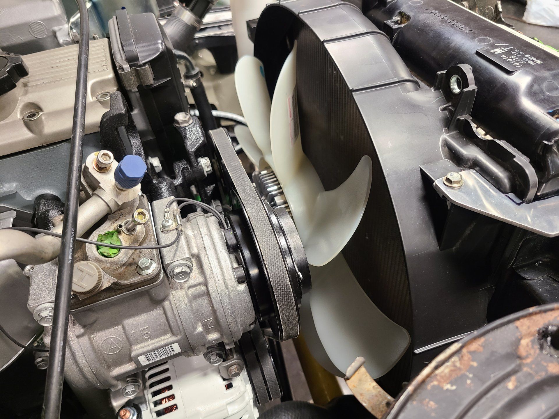

Front of motor complete....crank pulley torqued. Really happy with the fit of the fan to the shroud.

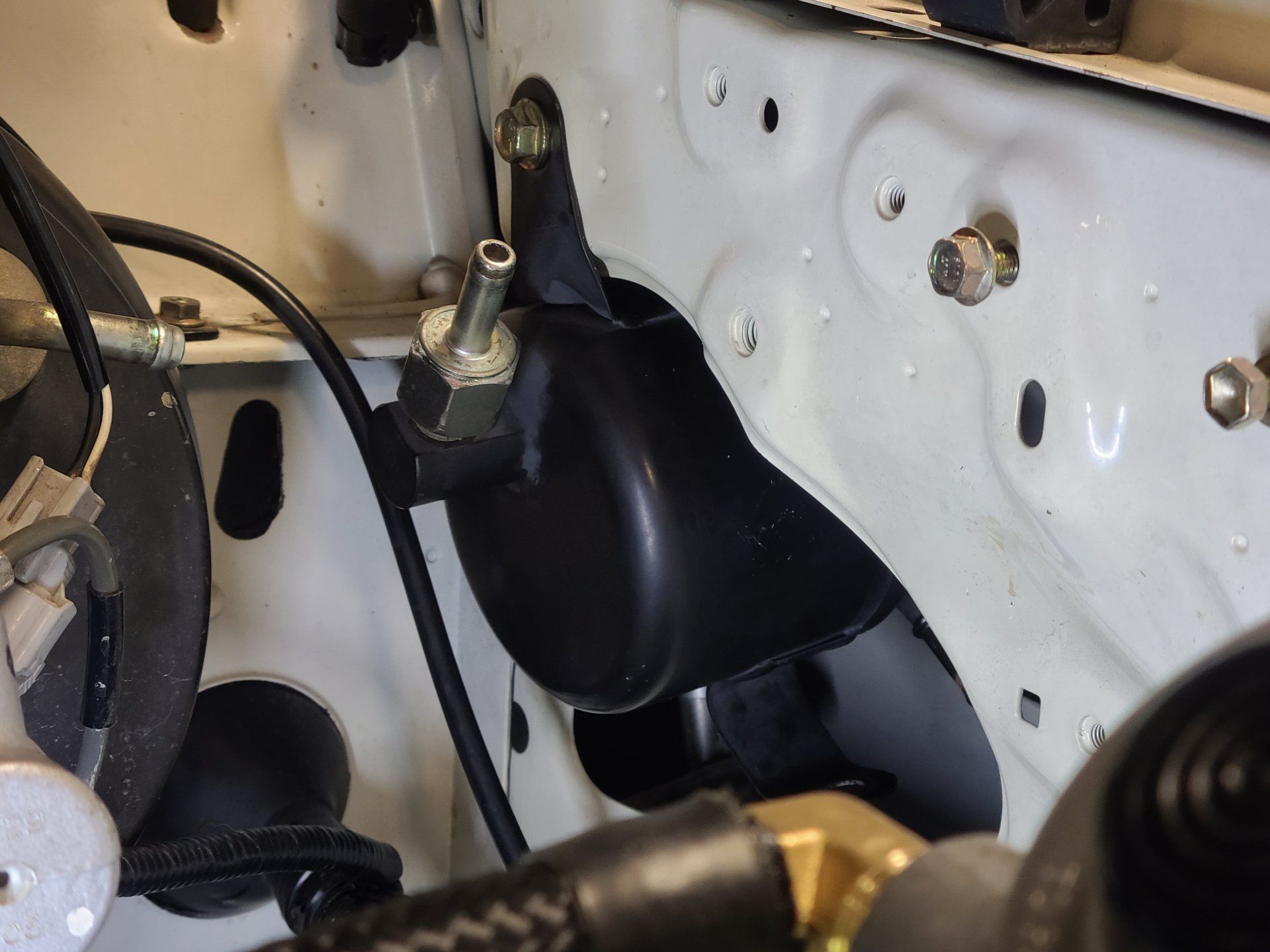

Borrowed this OEM vacuum reservoir from another project....tucked it into the rear inner fender opening on the LH side. Good place for it. On the 79s it's on the RH side of the truck with a metal crossover pipe to the brake booster on a LHD truck. With it in this location on our truck, we eliminated the need for the metal tube and cleared the engine compartment of one additional item. Ran the vacuum line from the pump thru the the inner fender. Clean setup.

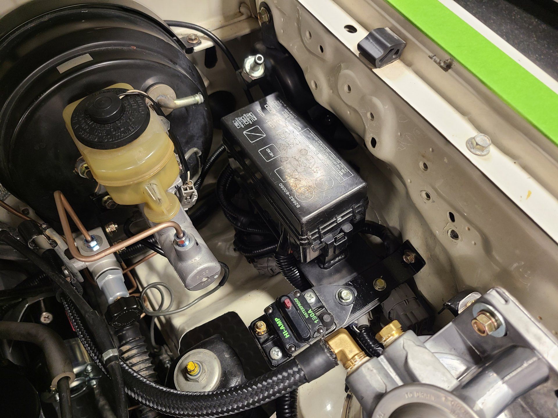

Got the front fuse box back in as well as the 150A breaker for my camper battery in the back. This was on the truck before we started...just moved it to a new location since all of this area changed massively.

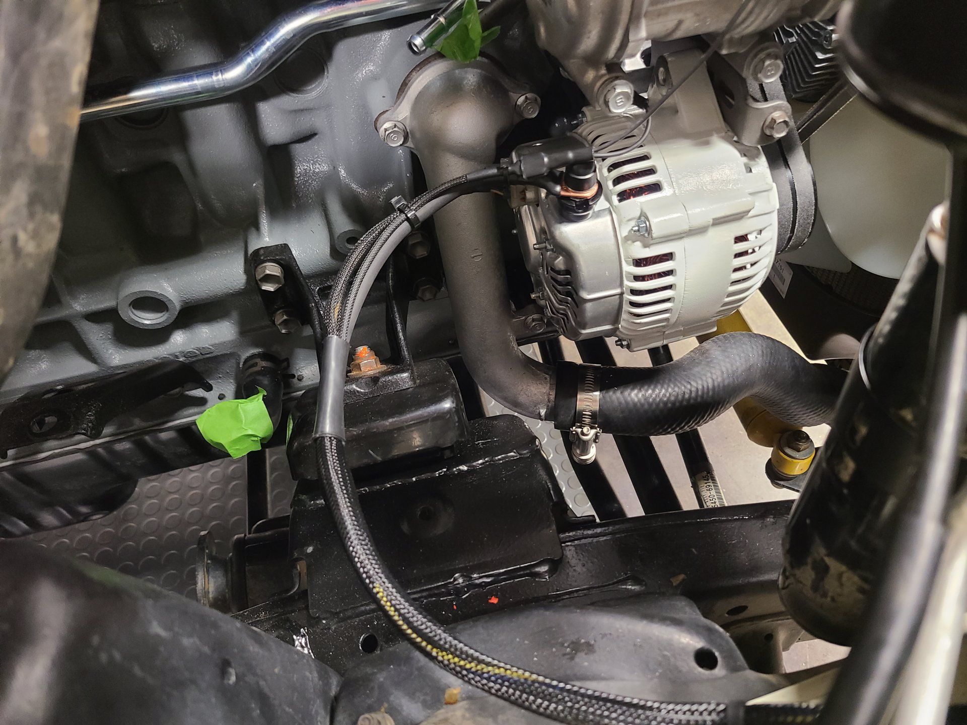

We added another 150A breaker to the alternator circuit. All the fusible links were put back in.
Alternator wiring...

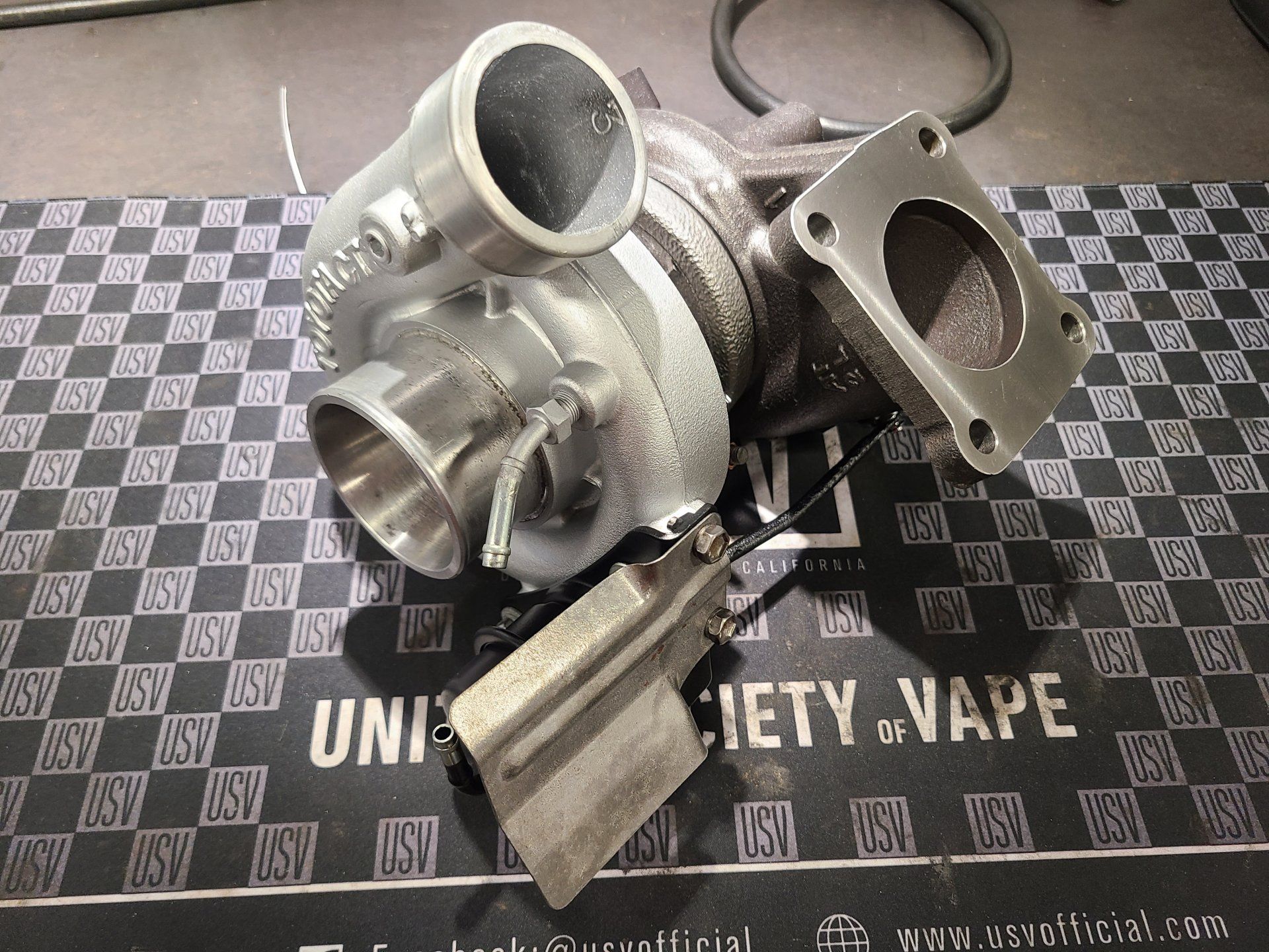

This poor turbo was hurt.....aside from the internals being loose.....it had this stuff happening on the hot side. Yikes.
Our local turbo guy, Kirk at Boost Lab in Tampa, somehow was able to source the hot side for this exact CT26 and got it all back together for us. I ended up spending a lot more on this turbo than I wanted but it should be good for a long long time....
