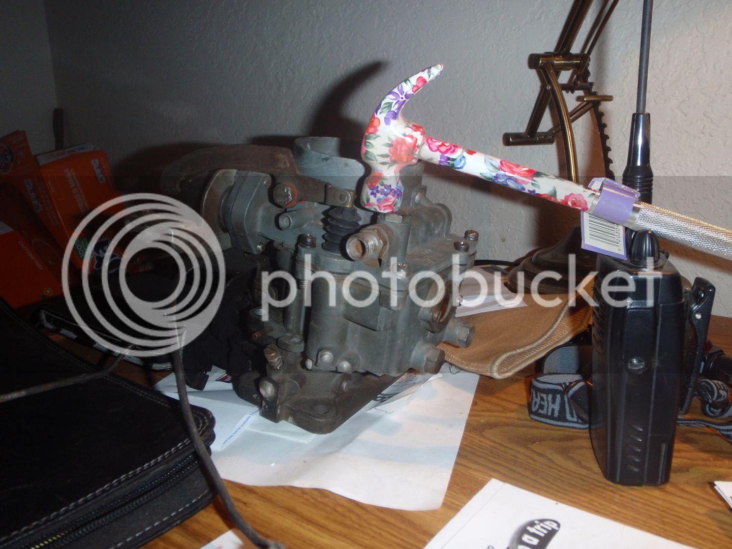

Is any fuel at all getting to the float bowl? It's pretty easy to remove the top half of the carby and clean things out. On mine the needle valve at the fuel inlet was packed with crud, but she still ran fine at lower speeds.
Here's a picture of a FJ40 carb and where you tap to get the needle valve to unstick... remember, it either works or it doesn't - if it doesn't, you'll be in a for a carb rebuild (which you might be into anyway)
and yeah, my hammer has flowers - what's it to you?!!! :mad:
Thanks.... And yes, nice hammer.
I continue to be stumped on the fuel situation. I tried tapping... Nothing. Then, I disconnected the hard fuel line and turned over the truck. No fuel came out. So, I poured gas into the carb, it fired right up and a little gas came spurting out.
Bottom line, fuel is not making it to the bowl. Now, I'm wearing out this new battery. Getting frustrated with this. :mad:
