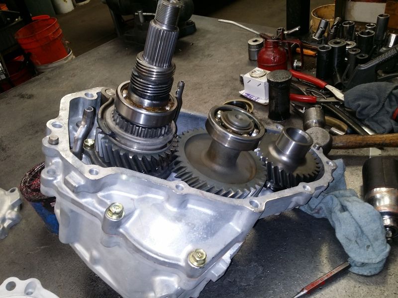

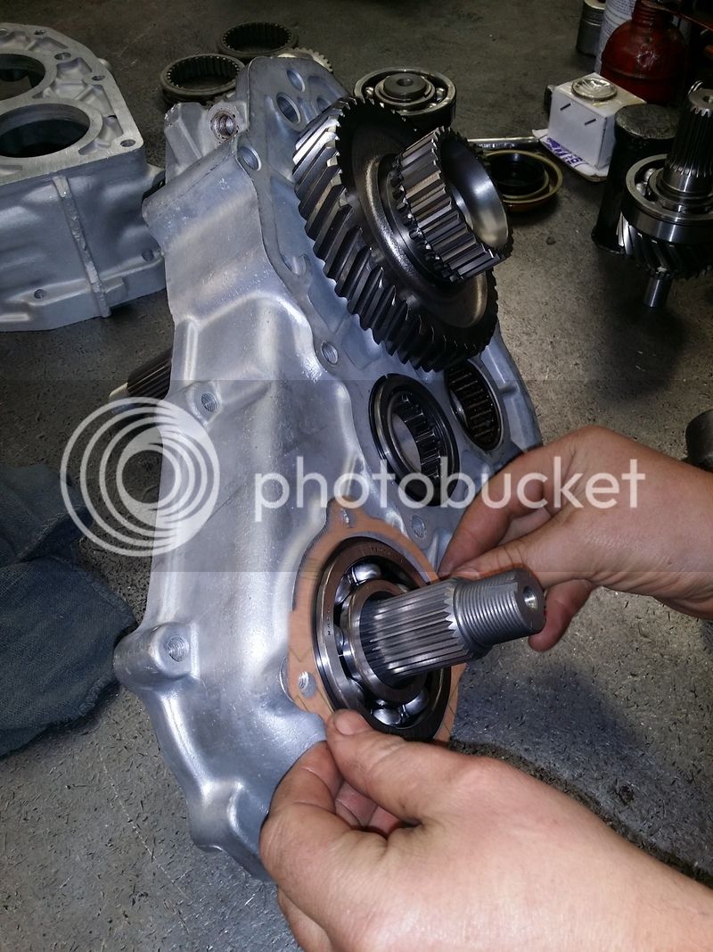

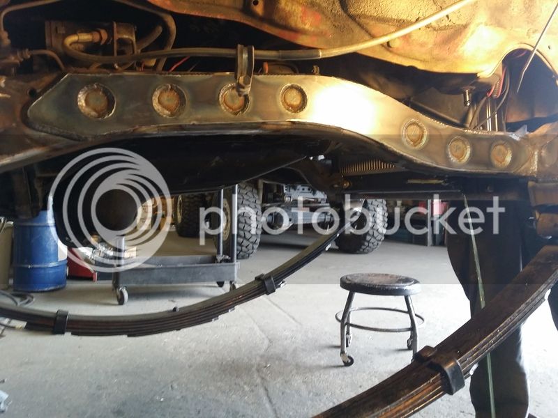

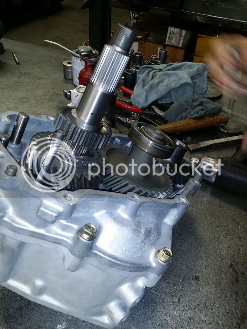

Ok so i suck at keeping up with the build thread so heres the last month or so of work

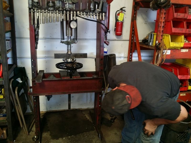

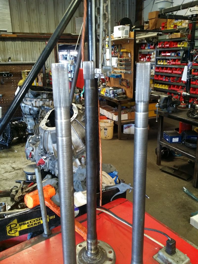

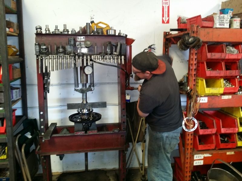

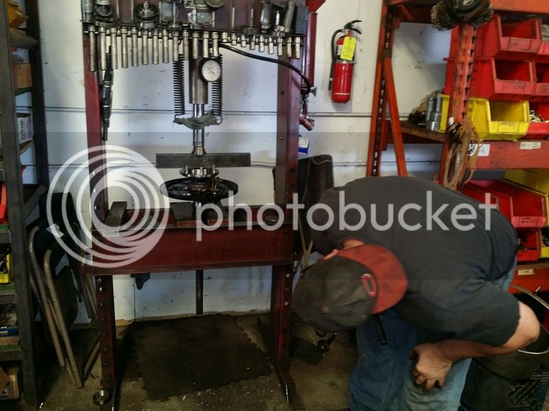

Chromoly rear axles cut down and beveled.
Me pressing them in with new bearings
