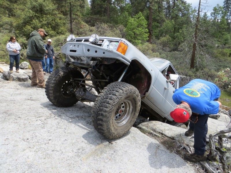

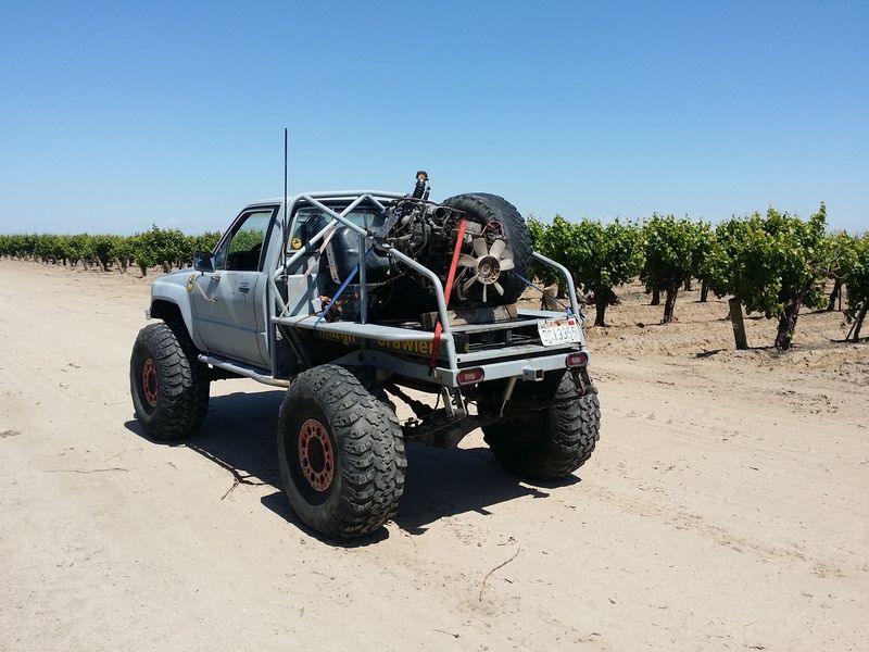

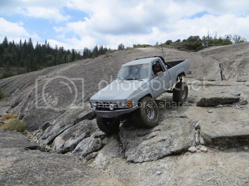

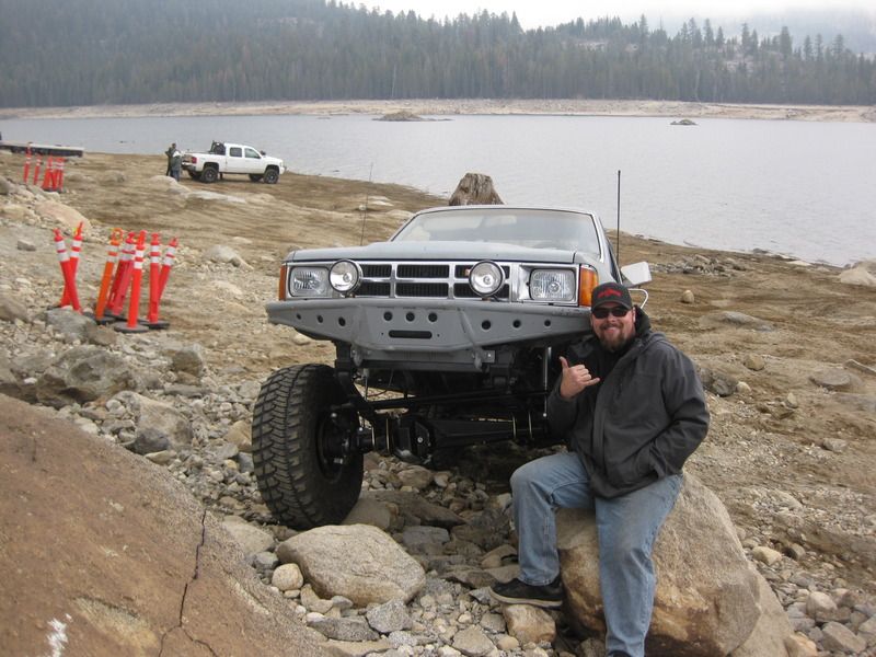

Some action pics Guys Shes coming along real nice.
And yes thats the man himself spotting for me!
Hunnington Rock Crawl Comp had A great time!

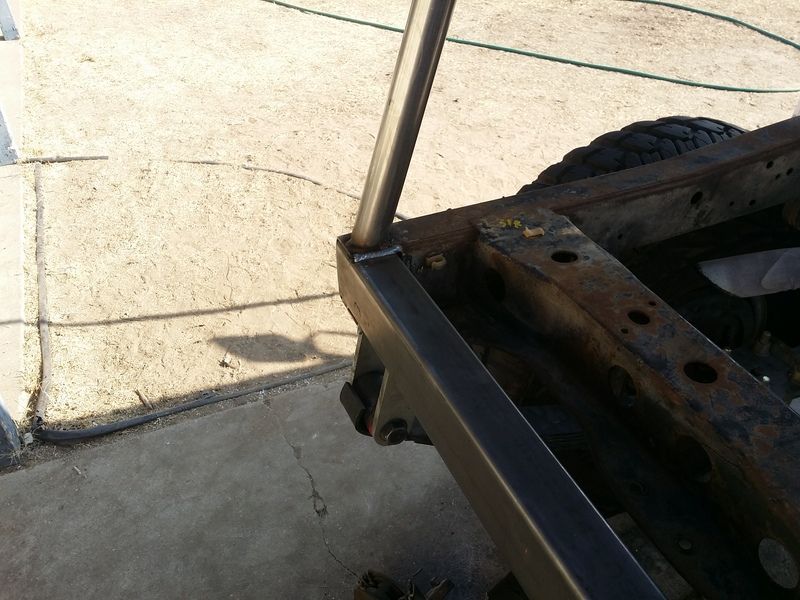

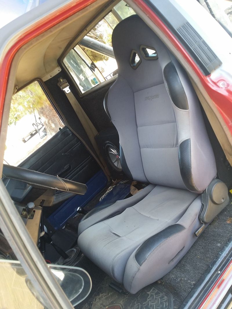

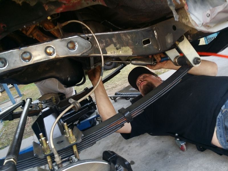

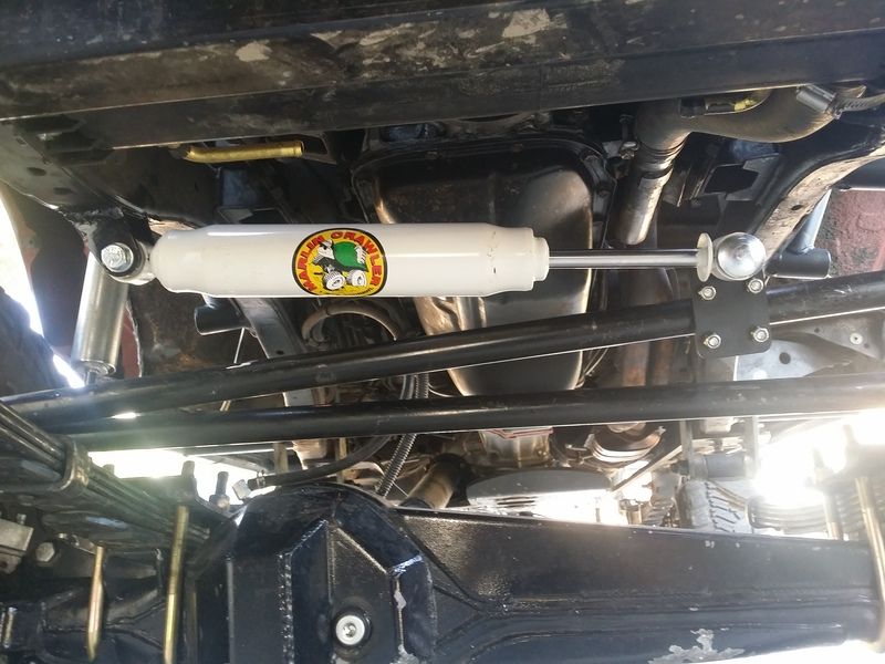

For the back i want to be a strong as possible so im going with son 1x 1 1/4 square tubing for my spacer and some 1/4 plate for the feet. Then i will drill new holes, and make anouther plate out of 1/43 for the bottom. weld the nut to it and weld it to the floor board.
Sits nice and low now! Just enough so paracord clears the floor with me in the seat and a little room for it to move up and down.
So that where I'm at with Julia. She has been real good on the trails. I even made it to the Rubithon this year!
A All-pro flatbed kit should be arriving any day as well!

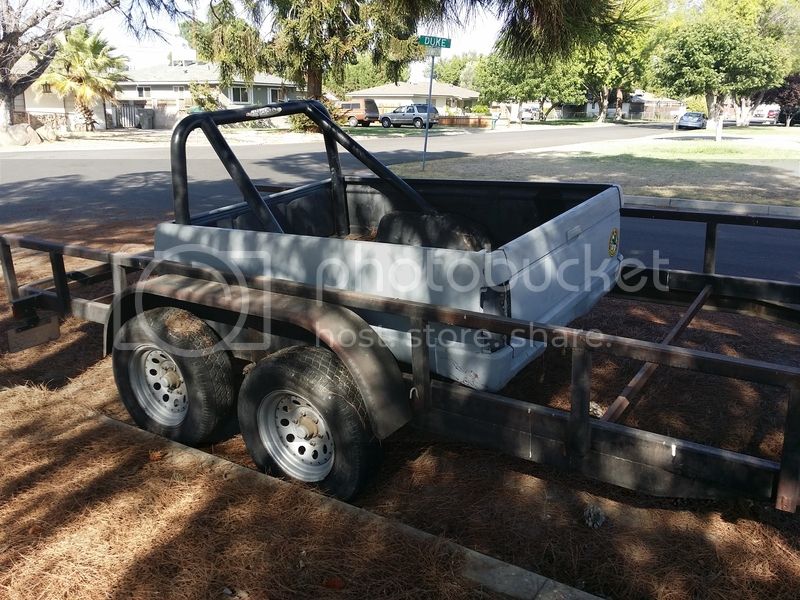

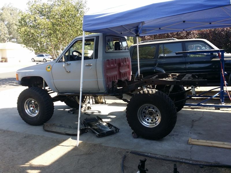

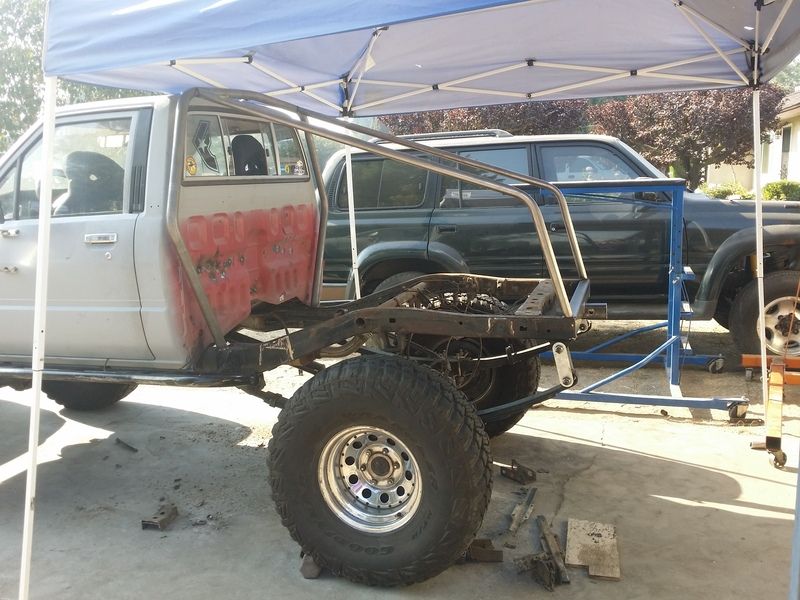

Bed off, on its way to its new home.

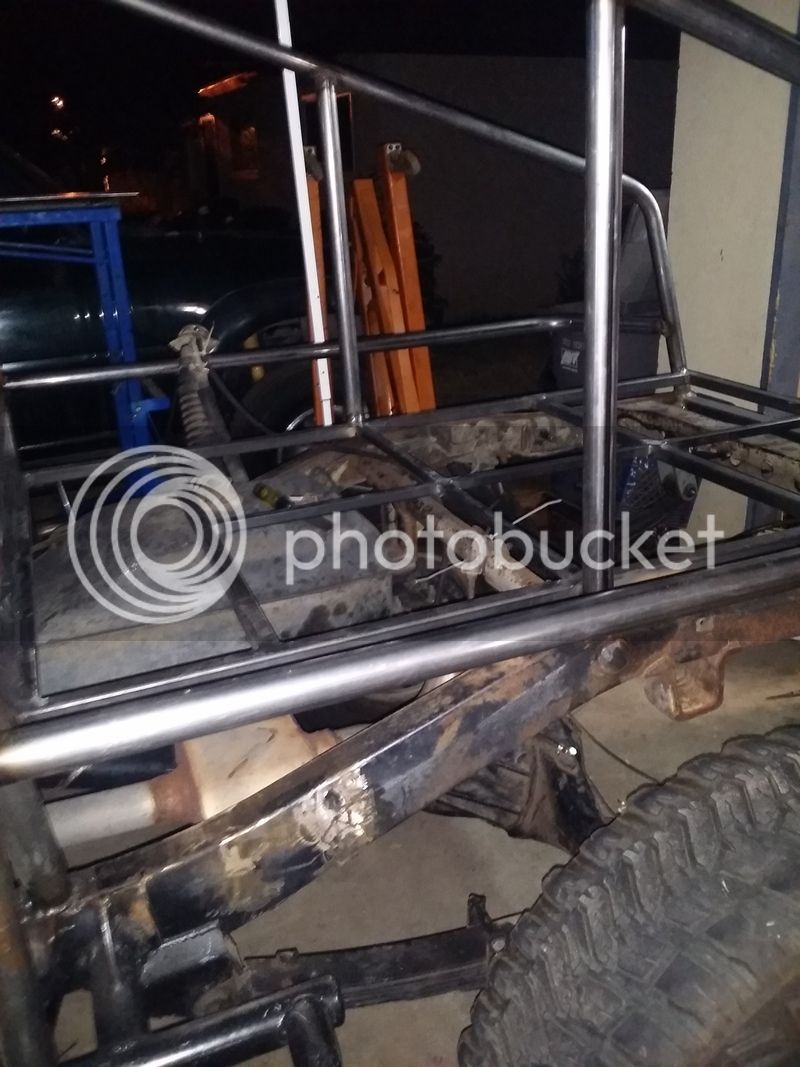

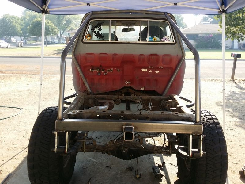

Bed mounts cut off and main structure up.

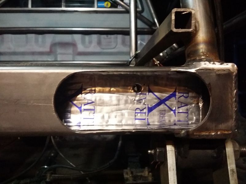

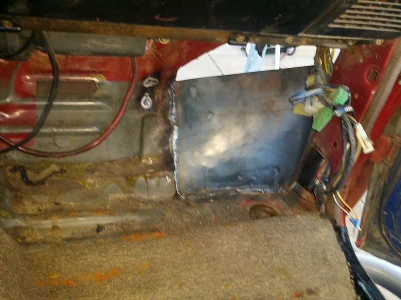

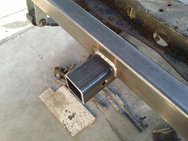

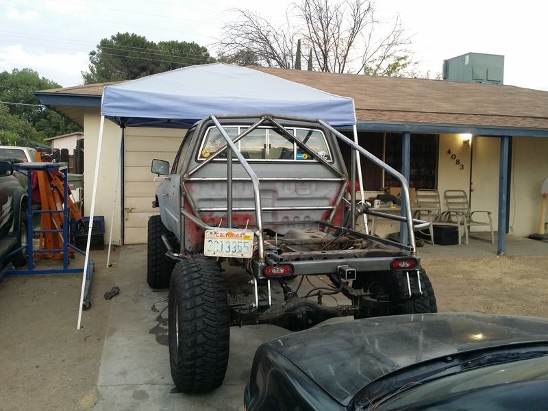

Rear cross member in and hitch in. Also fixed all the holes in the back of my cab.

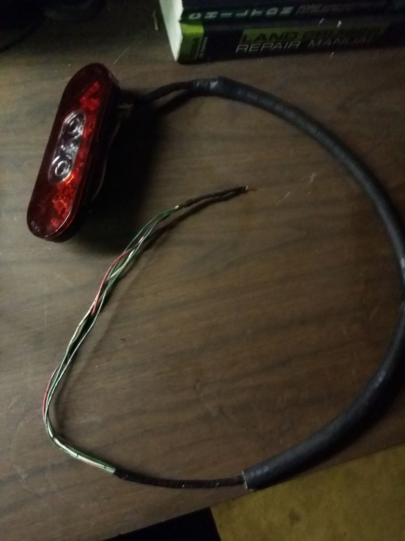

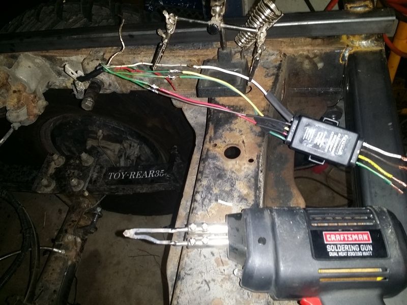

Got the light holes cut out and lined it with dyna mat to protect against chaffing
Took my lights and wired up a harness to go through the crossmember the covered it in fuel line to protect against chaffing.
I also had use a trailer light converter to get the lights to function as its a four wire system compared to three on my new lights.

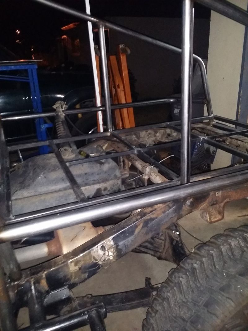

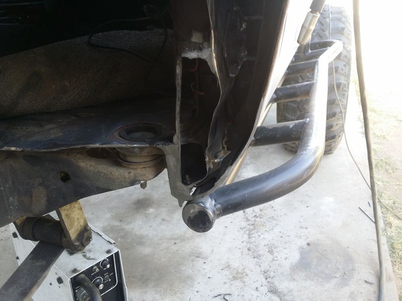

Fenders and basic floor frame in
Now to pull it all off to weld the front ugg that sucked. But Thanks David!

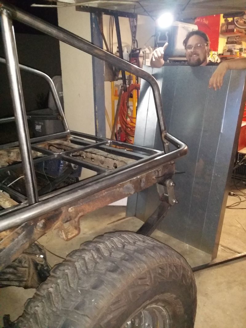

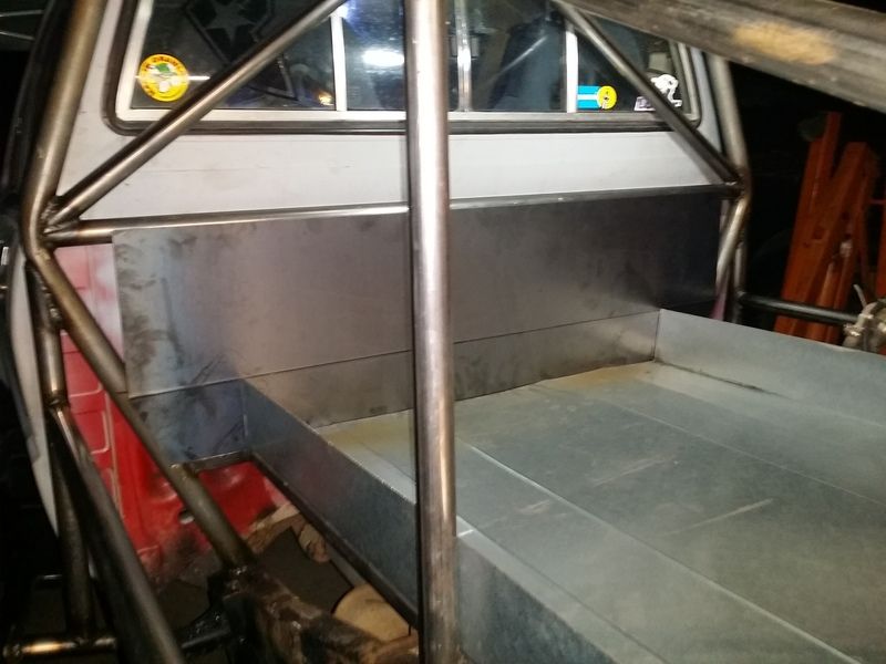

Bed pan, my buddy Brian helped me bend it and bead roll it.
Crossmembers, Thanks for the help Lee!
Ready to slem the pan in

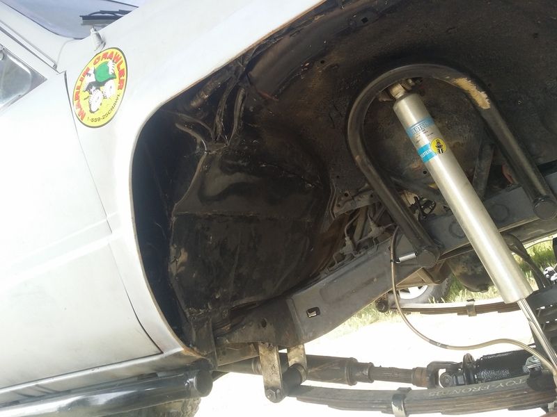

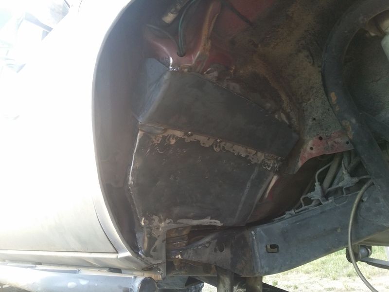

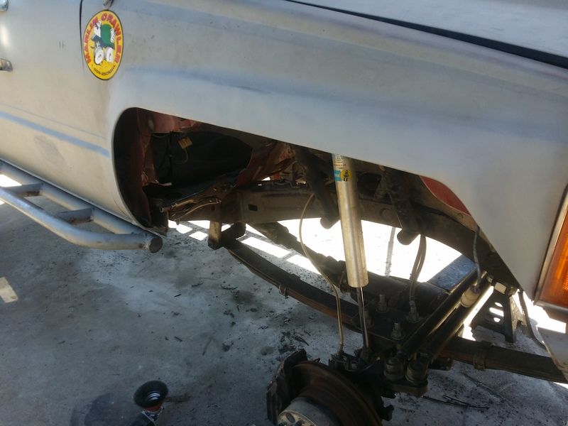

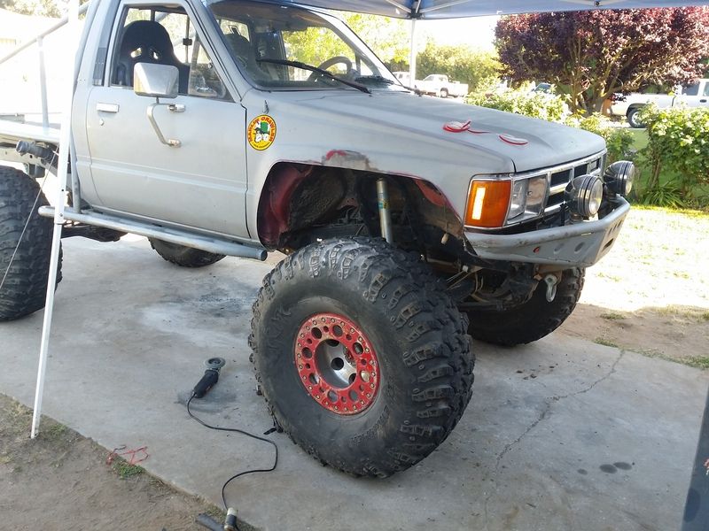

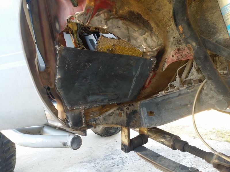

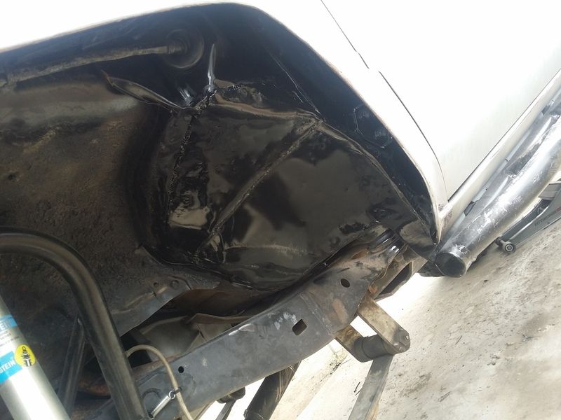

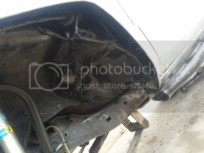

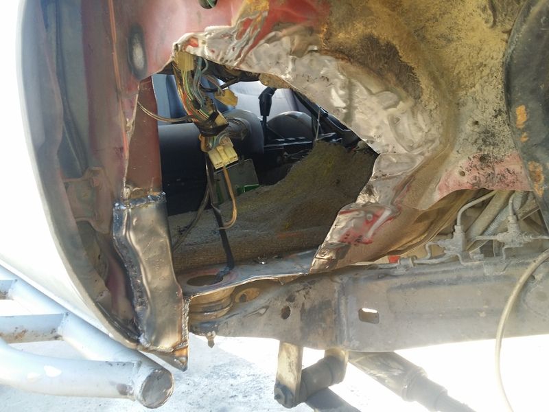

Fender and bumper trimed, going to tackle the floorboard and add roll stock to the new shape so it's not so flimsy
Here is the passenger side finished up
And on to the drivers

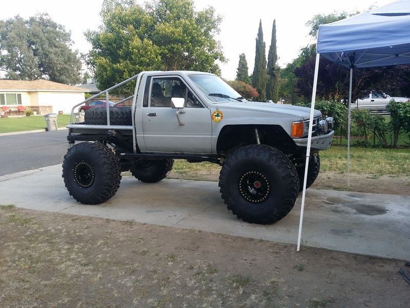

Done!
New Tires and wheels Done as well! and man they hook up great!
Iroks are sticky
