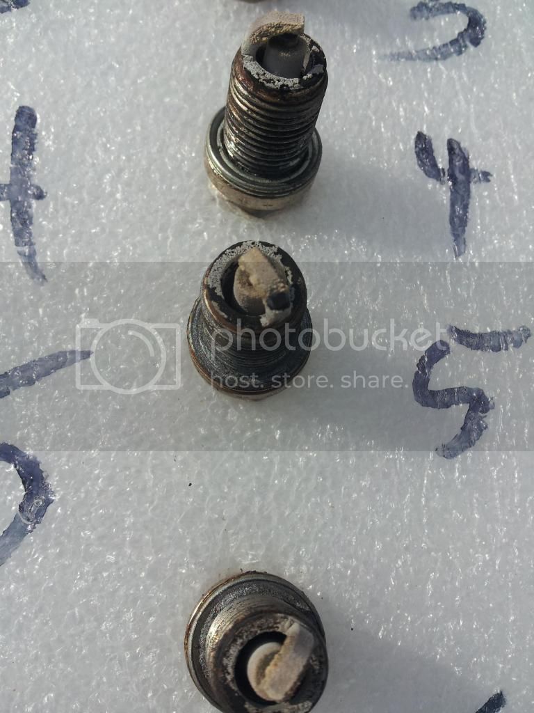

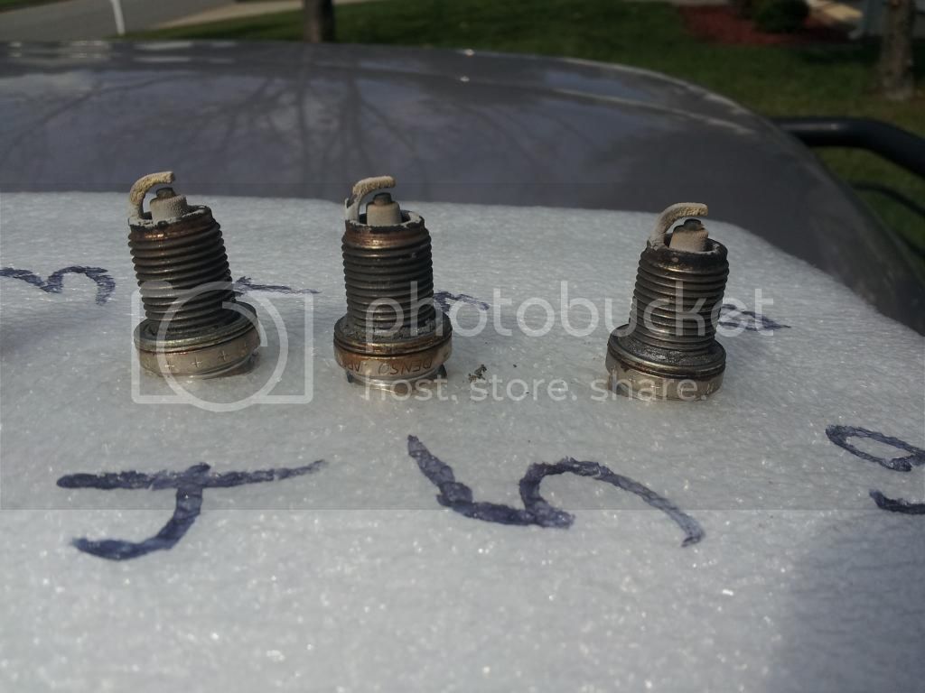

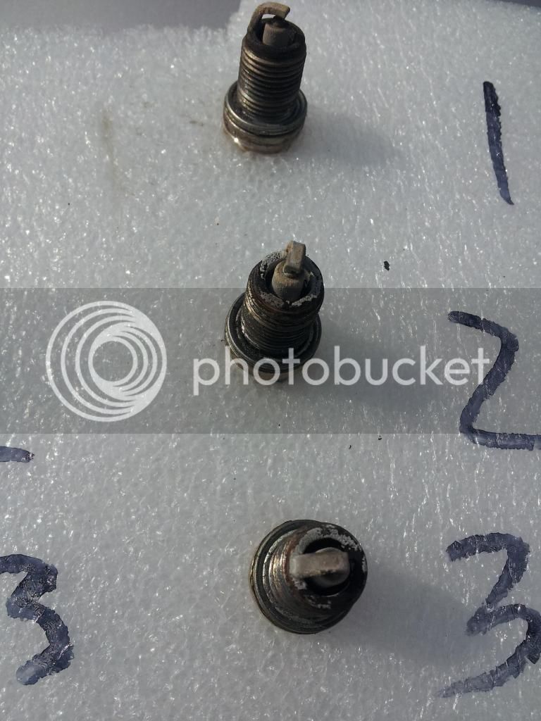

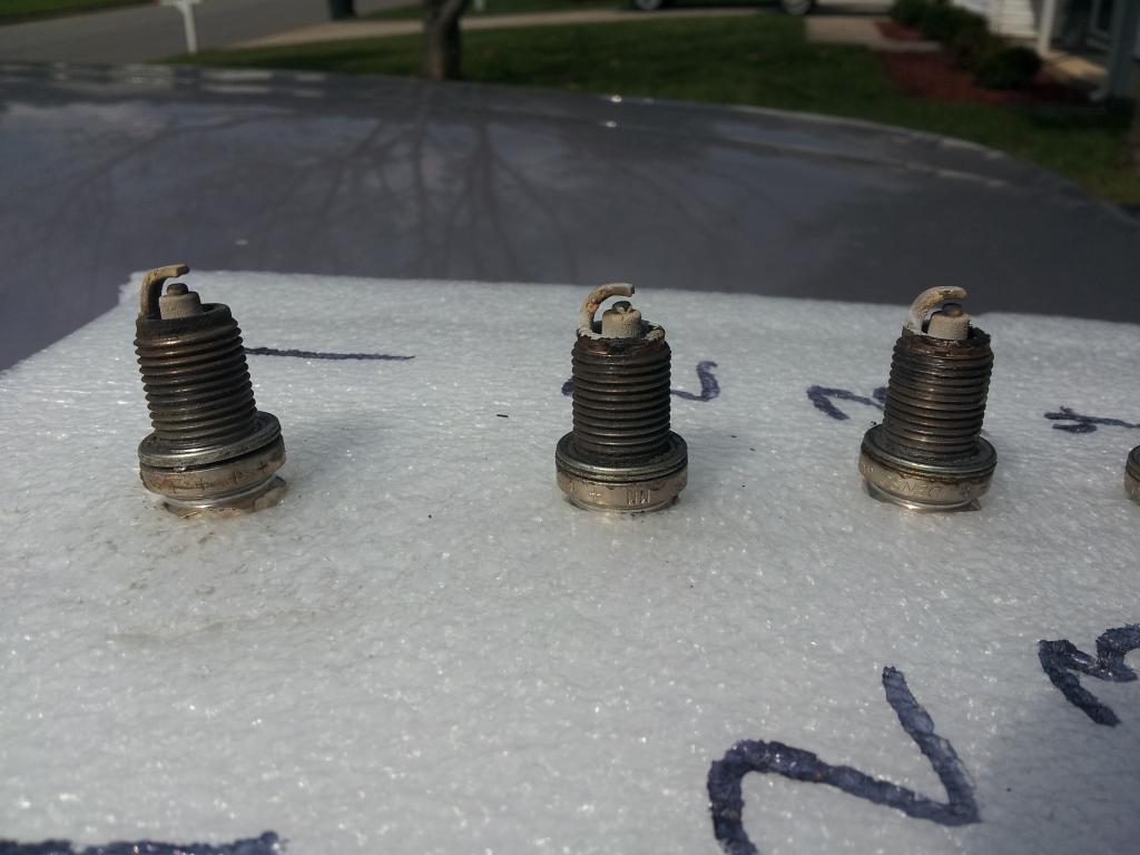

Update on my issues:
Pulled the plugs and didnt see anything totally out of the ordinary. Plugs have about 24k on them. I'll post pics when i get home from work.
