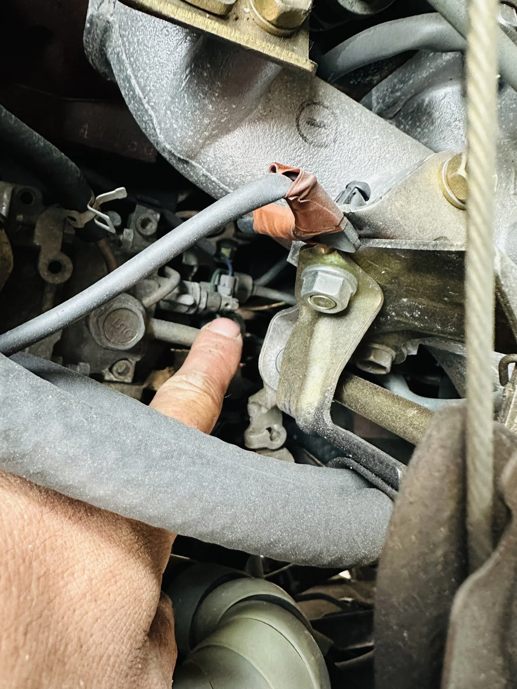

Do you think this is the altitude screw?
There is no such thing as an altitude screw - that is the max fuel screw. Your pump does not have a high altitude compensator. I would strongly recommend that you not adjust any injection pump settings until you fully understand the pump, and therefore understand that it won't solve your problem.
