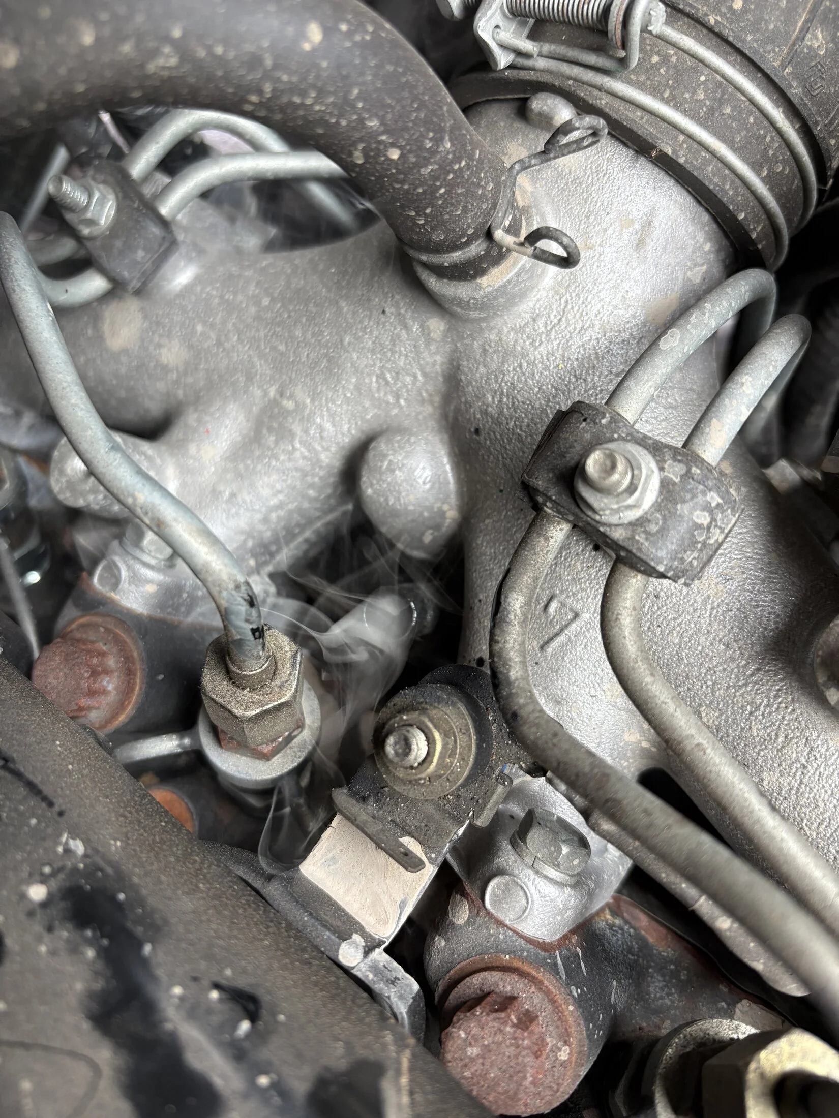

Well there is hope it’s not seized. I thought smoke from the dipstick followed by it not turning over might mean that… but..
I had changed the oil not long ago, and maybe it wasn’t as low as I thought. When I checked it the first time after it died (shortly after the red oil pressure light came on… I thought that was a low oil light) it had oil on the dip stick (all over it) so I kept driving. It died again. Then I saw the fumes coming out of the dipstick hole and looked more closely and it wasn’t as much oil as I thought it was- but definitely not dry.
Now it just clicks when I try to turn it over. Could it be a voltage thing? Maybe it’s not the motor seizing? But why the smoke? I clearly am still learning ha…
what should I try doing?
for now I’ll takeoff the fan and try turning the crankshaft by hand…
Here are the fumes..

I would say the engine is seized. You might be able to get to move a little with a breaker bar now that it has cooled down, but it probably started with big end failure, then seized up when you continued driving with no oil. So the bores may be scored.
You'll need to pull the engine apart to see what has happened. I would guess oil passage obstruction.

Yeah.. it’s seized. Won’t manually turn over.
