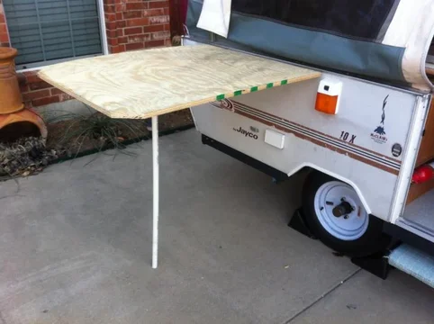

I made an outdoor table today for my pop up. I used some left over plywood and stole the J-Channel off of the stove that came with the camper. I had planned to buy an adjustable fold-down leg, but I can't find one that is around 40". I will probably get an adjustable shower curtain rod and cut it down if I can't find a fold down. (Don't mind the temporary PVC leg)
One side of the interior has a u-shaped seating area. I removed the middle of that seating area and this table can go inside to complete a second twin bed. Should have taken some pictures. I can't take credit for the idea, our old pop up had this setup.
Since the outdoor stove isn't in the location of the original design (where the table is now), I'll either have to drill a hole in the table for the propane line in order to reach the outlet or get a longer quick connect propane line. (I'll probably go cheap and drill a hole in the table.)
