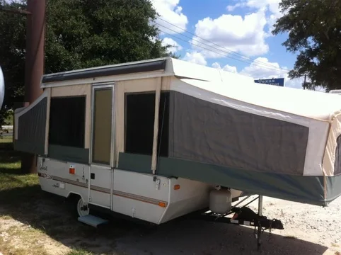

I know a few mods will be in order if I get this one, lift possibly, trash existing foam for beds, new covers and curtains (wife), some sort of collapsible vertical storage around the sink and stove, maybe add a battery setup, maybe add a hitch adapter to carry a cooler, if it will hold the weight. Here is the one I'm looking at
