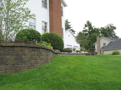

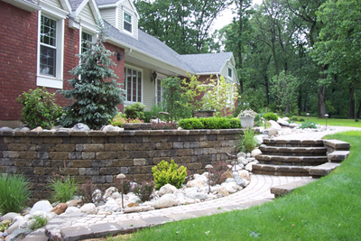

Check out scott stone and luck stone in mebane for good stone selection unless your going with concrete block eeeewwwwwww
Then at least look at the nice block. Techo blok
There's also the yard on 70 east of gso. Cheap but not the style stone I prefer. Bring cash and a trailer.

C'mon, cast concrete looks good!!
