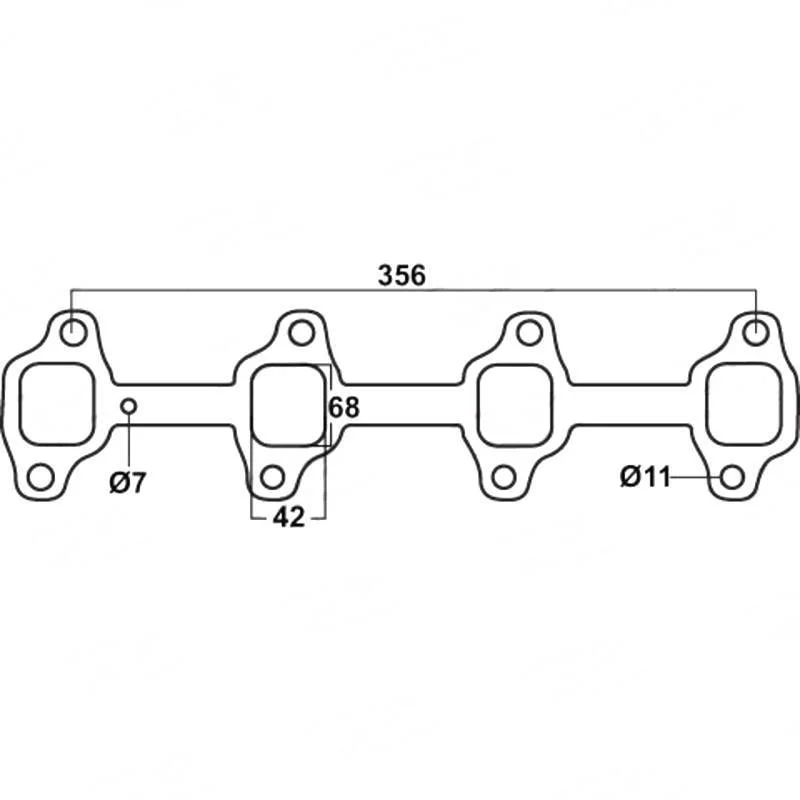

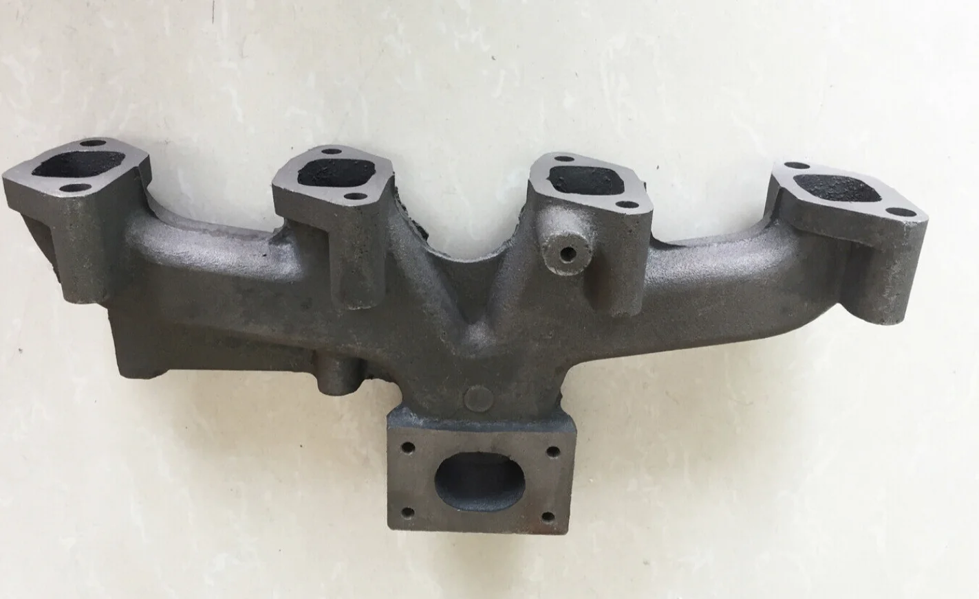

Will it fit? I can’t found the bolt pattern dimensions for 4BD1, but looks very similar compared to 3B’s exhaust flange.
Found this: Isuzu vs 13B/14B - https://forum.ih8mud.com/threads/isuzu-vs-13b-14b.160282/
Looks like it’s close, but the upper bolt holes have more offset than the lower ones and bolt pattern height is lower. So, it will not fit straight, but maybe it’s possibly to mofif
Isuzu:
Toyota (gasket):
Here is one installed: 3B turbo kit... what's wrong with this picture? - https://forum.ih8mud.com/threads/3b-turbo-kit-whats-wrong-with-this-picture.270749/
Do anyone have exact dimensions of the 3B flange?
