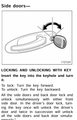

My question is does the manual key only unlock the LC from the drivers door? The drivers door also doesn't lock from the exterior, I have to unlock it with the interior lock/unlock switch. I've tried to unlock it from any other door it will only lock the vehicle. Is this the case with LC100s? I couldn't find information on whether this is the way they unlock/lock?

If you have the owner's manual for the truck, I'd suggest spending an evening reading it since the truck is new to you. The locking features are covered in there.
And yes, with a key that has the buttons, you can lock and unlock the doors. You'll want to check if the single key you have is a master key or not, that will determine if you can program other keys or you'll need external help like Techstream or a locksmith.

The land cruiser didn't come with a manual but I got a hold of one online so I'll be looking through it. Is there a way to tell if I have the master? I only have one key for it. Thanks for attaching the image, that was helpful!
