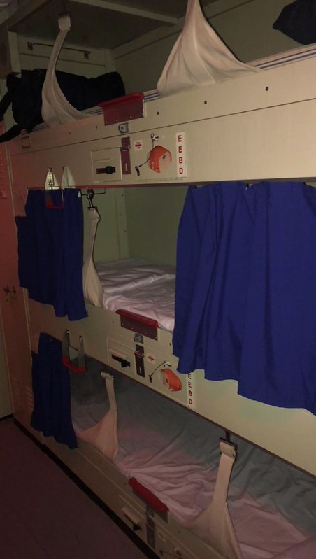

I spent 20 years sleeping in Navy coffin racks, 77" long 27" wide and 17" high not sure I could even turn over in one now LOL
They will turn you into a slide sleeper for life as mentioned earlier back against the bulkhead and knee braced to help keep you from rolling out onto the deck from the ship rocking and rolling.

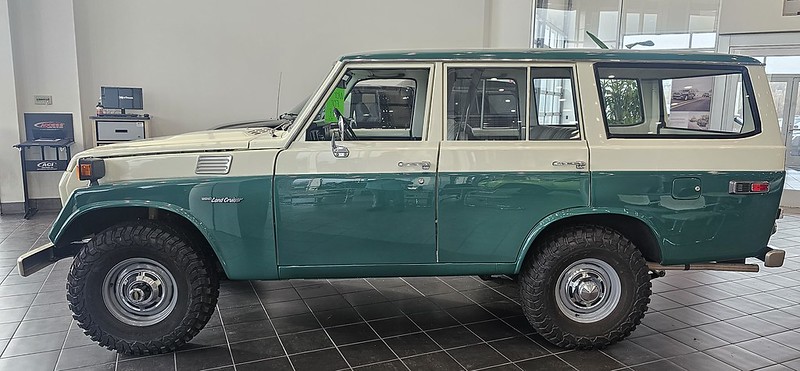

In the 70's- early 80's threw a mattress in my FJ55 and slept in the back all the time on the weekends in the woods. When I got the GX the Toyota dealer happened to have one on the showroom floor. The seats folded flat and it was a lot larger than I remembered.
Were you a submariner? Even doing a couple tours of the Midway (Midway class, 1945 aircraft carrier), the last with our daughter a few years ago, which we have docked down here in San Diego, I thought I remember the racks being a we bit more spacious.

Coffin racks on a ship or tour bus work because there's a full length curtain to swing your legs out and somewhere to grab to leverage your way out.
