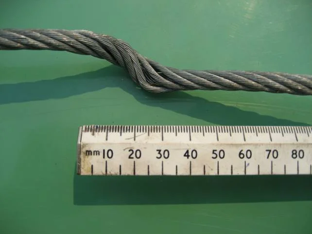

G'day,
I picked myself up a secondhand Warn XD 9000 winch on ebay. I un-spooled the cable to inspect it. It seems ok except for this kink (See the pics).
What'ya reckon......None of the strands are broken. Should it be replaced??
Cheers,
Ben
Winch cable is cheap do the safe thing, REPLACE IT.
The only reason to use a cable with that kind of damage is if happened on the trail, you have no spare and your life is in danger.
replace it with some actual rope from rockstomper.com
