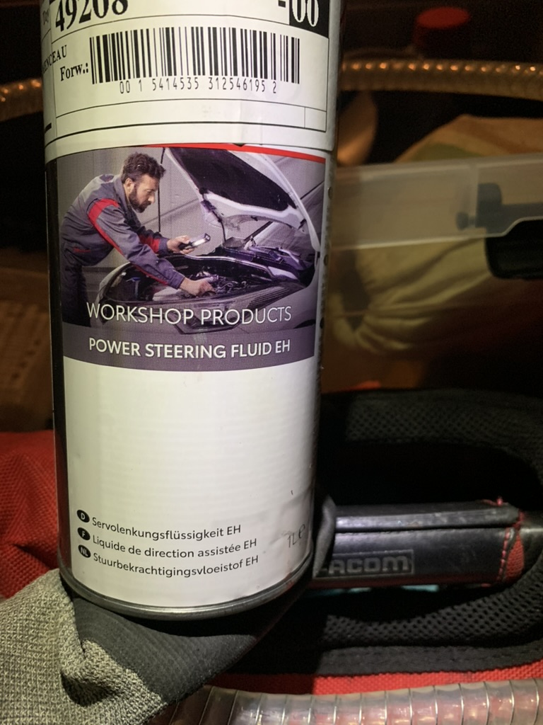

Hello,
I have a 2013 LC200 and want to flush the power steering fluid.
The Toyota dealer sold me this reference but i want to confirm this is indeed well suited for the LC200 :
Thank you

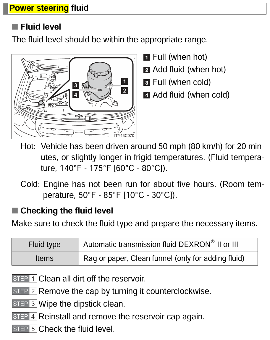

I also have a 2013 LC200 and I believe that is NOT the correct power steering fluid.
As far as I can tell, the Type EH fluid you show is for electro-hydraulic power steering systems as found in, for example, a Toyota MR2.
Our LC200 power steering systems are simple hydraulic systems. The Owner's Manual states:
The required power steering fluid for our 2013 LC200 is any automatic transmission fluid compatible with DEXRON II or III specifications.
HTH

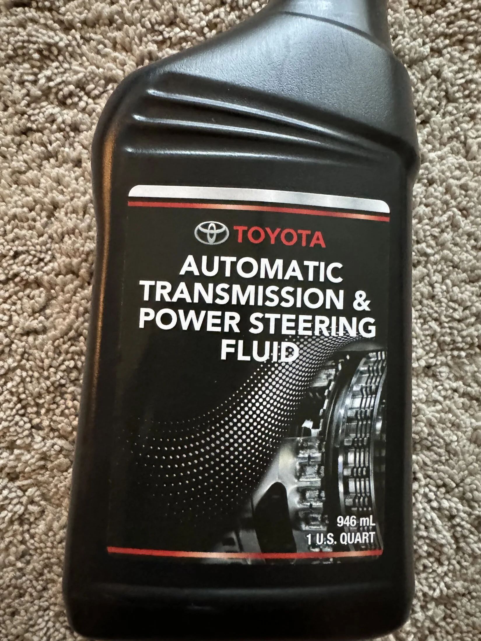

Agreed. I use Dex III, swapping out the reservoir volume with each OCI. A true flush is a bit more complex and messy. You could, simply do a reservoir exchange say 4x with running the engine and turning lock-to-lock in between. Dex III is cheap enough.
Unlike trans or center diff, power steering is a pretty generic process with just a hydraulic pump and rack. No Toyota-brand unicorn tears required.
HTH
Thank you so much ! I had the same impression.
