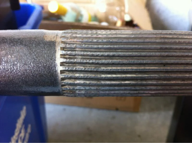

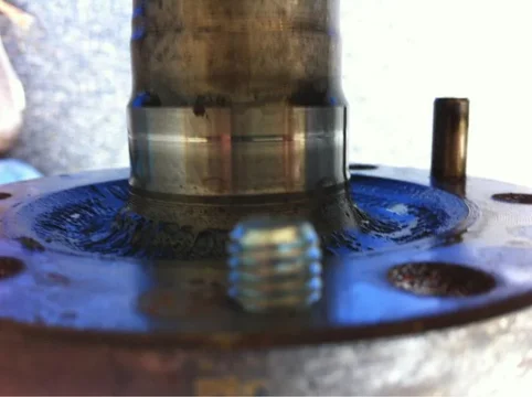

I'm rebuilding my rear axle and just got the passenger side axle shaft out. Upon inspection it looks like the splines are slightly twisted and there's a groove on the bearing surface.
Should this be replaced?
I wouldn't trust it. You can either reuse it, and have to replace it after it's broke on you. Or you can spend a little extra money now and know its gonna last a long time.
Spend the extra cash for peace of mind.
Thanks! I actually PM'd the seller about an hour ago. How worried should I be about the groove on the bearing surface?
that is the least of your worries. the twist is the deal breaker.
I would be worried about the splines as well. If you're on the trails and you lock the rear, it will probably engage fine but it may have a hard time trying to move the collar back when trying to disengage. Especially if you stress it, twisting the splines more when it's locked.
I'm sure it's fine for a while just driving easy on it around town if needed.
I have no experience with this or 80 series to be honest. But I do know that It takes a lot of stress to break an axle. They aren't designed to twist, neither are the splines. Some time in the past your axle was stressed 'almost' to its max and didn't end up breaking. It will be a lot easier to break since its already tweaked.
Thanks, guys. I reinstalled it for now. I was worried about being able to get it back in, but a few minutes of fiddling did the job.
