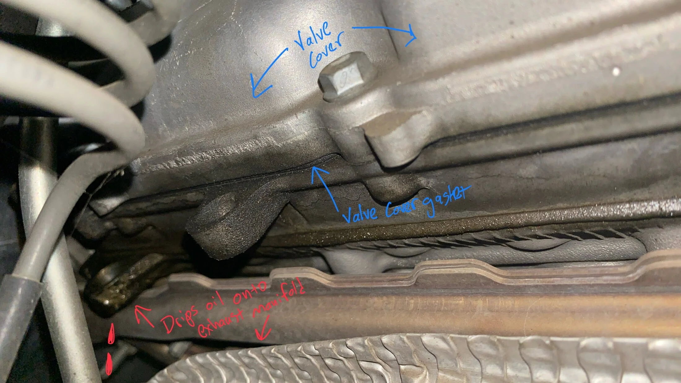

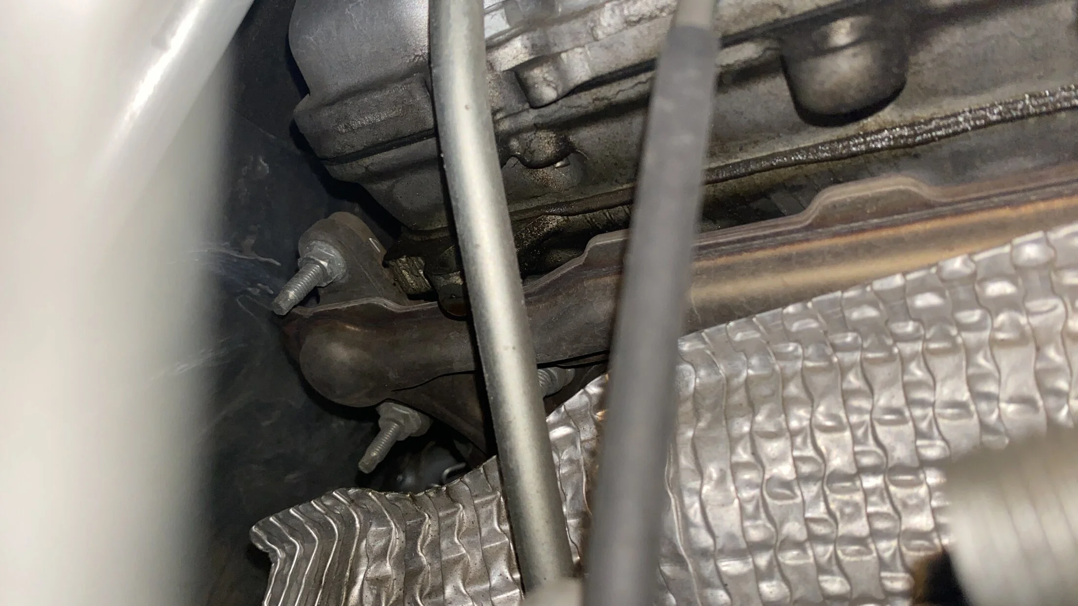

Is this a valve cover or cam tower oil leak?
Jan 24, 2023
21
140
92603
I posted this over on the Lexus forums but didn't get many answers. What do you guys think?
These pics were taken from the passenger side wheel well looking towards the rear of the engine.
  • Sad
Reactions: r2m
^ Agreed. It does "look" suspiciously like the tower leak location however.
I'm confused because every time I see a cam tower repair video, the cam towers always look like they exist fully inside the valve cover. I don't see how they could leak out.
Nope, it is actually another stacked layer. Hence it adds another interface/leak path. Head deck, cam tower plate, valve cover, from bottom to top.
Ahh, I get it now. Thanks for the insight. Well, I guess it's time to do the timing cover, cam tower, valve cover leak repair!
Looks like a valve cover gasket leak to me. Physics and gravity will concentrate the majority of the oil in the back corner like that. It wouldn't hurt to use a 1/4 drive ratchet (note I said 1/4" drive due to the low torque needed) and just put a little effort into turning the valve cover bolts to see if they are loose.
I'm not familiar with the 4.6L valve cover fasteners (yet! knock on wood) but the 4.7L had rubber washers attached to the bolts that held the valve cover on. They naturally contract and expand, and I know sometimes a simple fix was to tighten them up slightly. ymmv
^What I'd do too. Unless one is really bored and wants to perform invasive surgery for fun, try the simple things first. If that doesn't work, go nuts.
