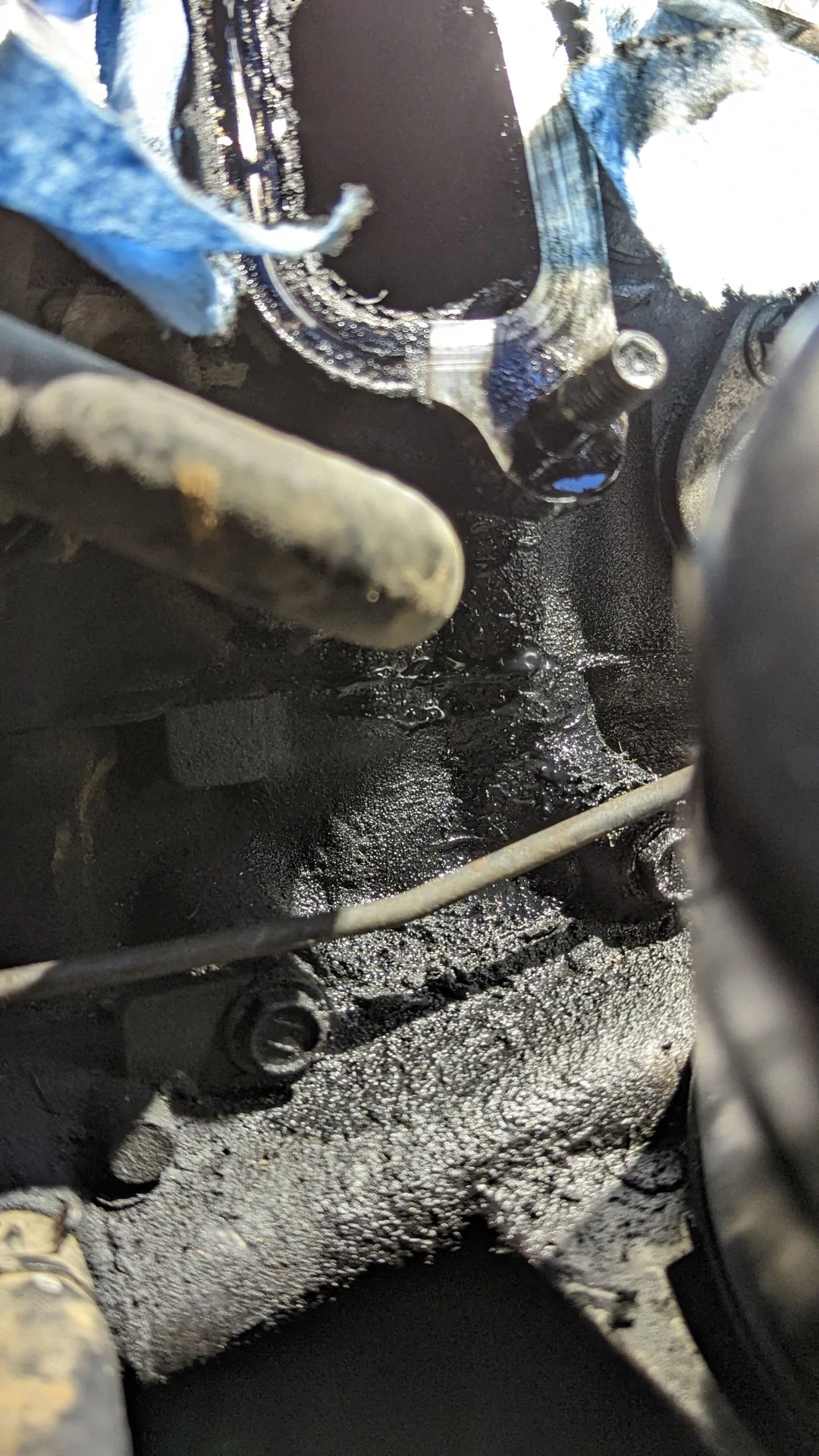

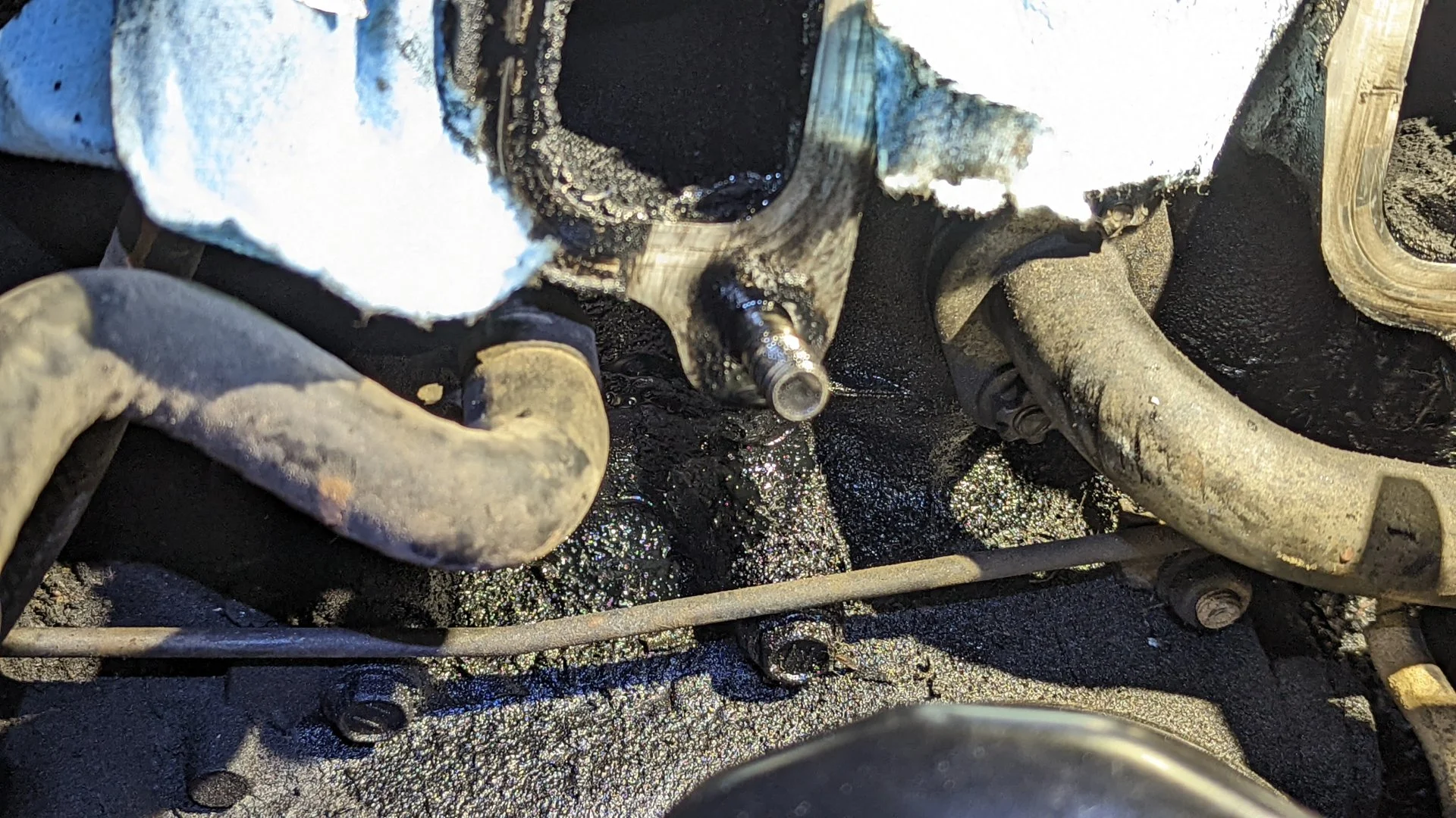

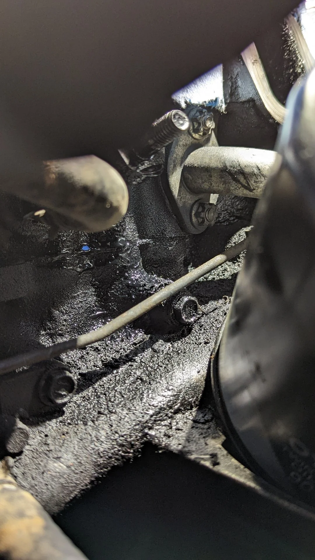

Hey again,
So after pulling the manifold off to change some gaskets seeping delicious EGR goo it almost looks like the head gasket has a leak? No dripping or real noticeable oil loss (tiny top off after 5000km or so) and no other symptoms of any sort. No smoke or anything, truck sounds and runs good. It is at 321k on the clock now.
Based on your description that it is running well, and no real major oil consumption, compression is good, then I would suggest the oil loss is what is being pushed through the head into the intake and causing you ''goo'' problem you are currently working on. If you are not seeing anything funky with the coolant (losing coolant and/or oil in the coolant) then I would say leave it alone.
Clean it up and reinspect after some driving time and see if there are any new leak evidence at that time. Hope this helps! :cheers:
Because the mess starts above the headgasket, I don't think the problem lies there.
I'm going to suggest it's either a leaking valve cover gasket, or oil from your crank ventilation (fed into intake from OEM), that is settling in the intake manifold and leaking out.
If the former, just replace gasket.
If the latter, buy a catch can, and optionally replace your intake manifold gaskets.
EGR and crank ventilation are hard on these motors as they really sludge them up.

Thanks guys, yeah I replaced the intake manifold gaskets and cleaned out the intake manifold, as expected after 300k+ it was pretty dirty but not as bad as I had seen online or expected honestly. Either way I decided to ditch the EGR and have some blanking plates coming in a day or two. Also used the time to put an EGR probe and gauge in pre turbo. We'll see what the truck runs like once everything is squared away.
