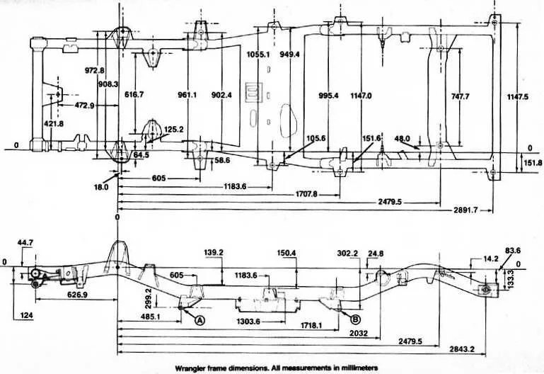

It is a Jeep frame, either a CJ-7 or YJ Wrangler. The mount in the front center is for mounting the grill.
If you can reference the frame number, you can find the production year, that would give you an idea whether it's YJ or CJ.
Probably a 95 YJ, there was not a 96 YJ or TJ. Not sure when they stopped production of the 95 YJs though, Jeep usually winds down production in May or June. Since there was no 96 model year for Wranglers, Jeep may have run the 95 model year production longer than they normally would.

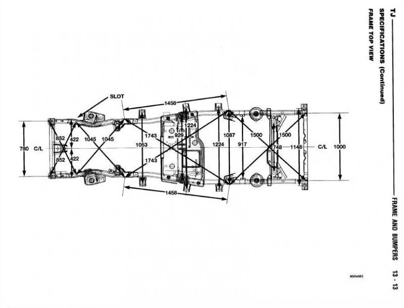

Huh.
And the frame doesn't have the coilover box buckets, just all the leaf gear.
Maybe it's a TJ that's been de-coiled?
Or maybe a one-off monstrosity that's born out of whatever the plant had at the time of assembly?
