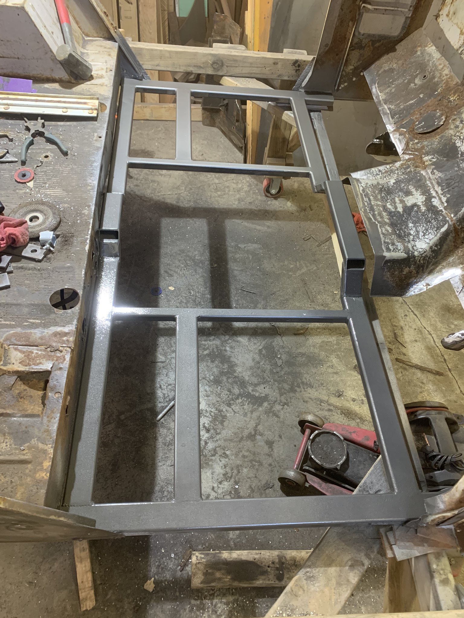

The first thing I did when I got it was clean up all the rust on the frame and body. Only major rot was in the floor, and I rebuilt the entire floor. Later on I had the entire body sand blasted in my driveway by a moble blasting service.
Untitled by Jeremy Nugent, on Flickr

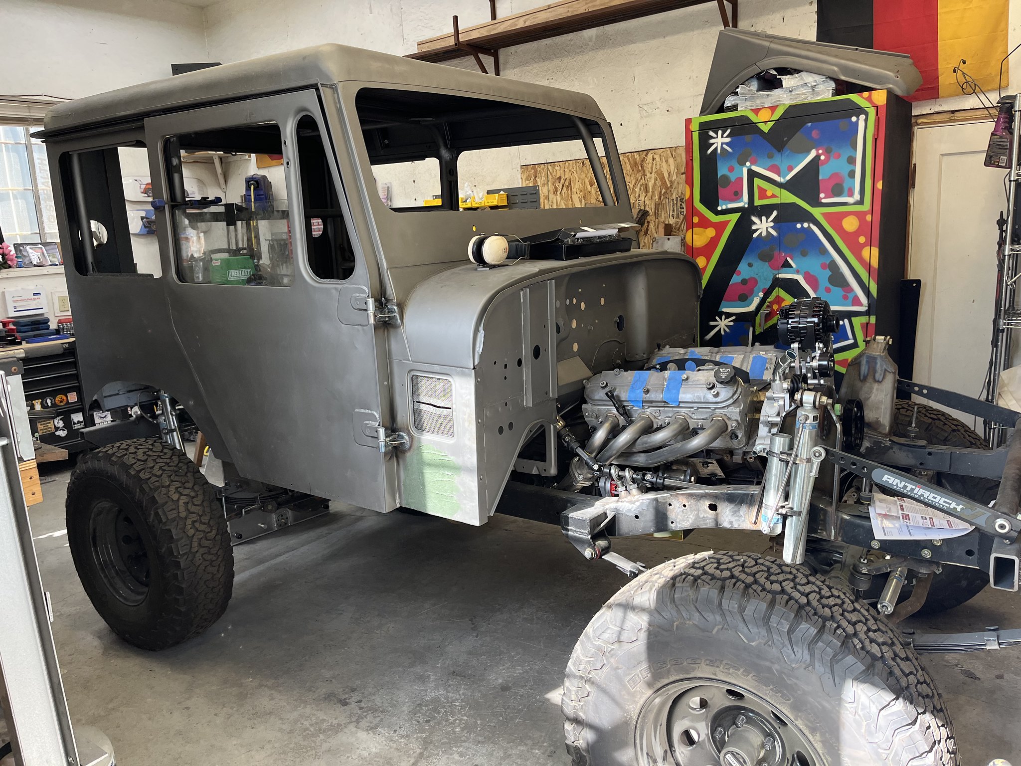

Fitting the engine in place.

Right now I'm working on finishing up the body, getting it painted so I can move on to getting drive shafts made and doing all the plumbing, wiring, and exhaust work. This Dec. I got the interior finished up and painted. Im curently working on getting the Jeep set back down on its ass end with my sealing hoist so I can paint the bottom side. Then Ill move on to painting the exterior.
