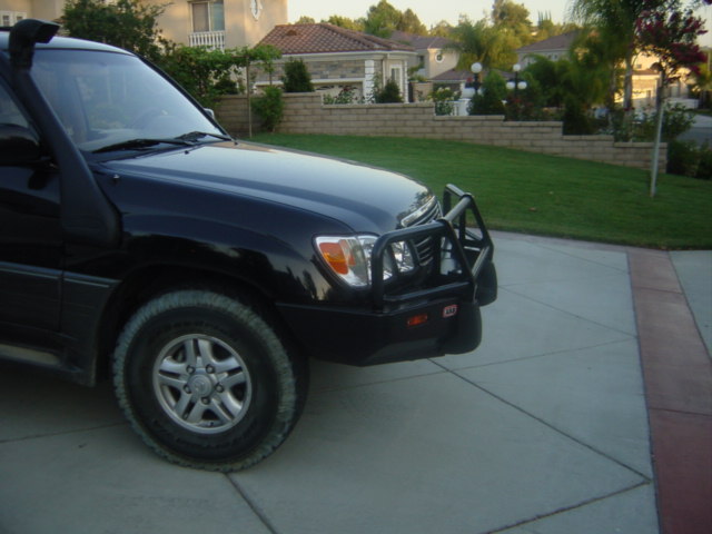

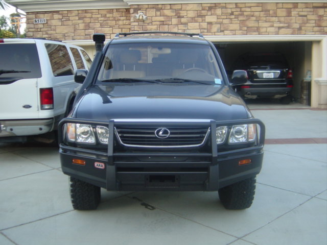

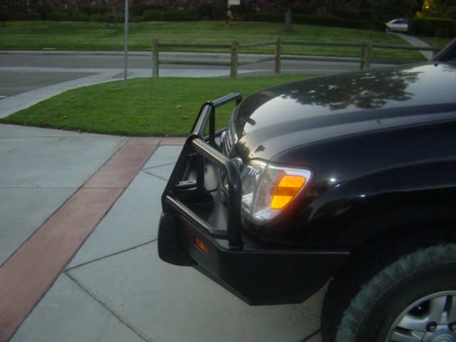

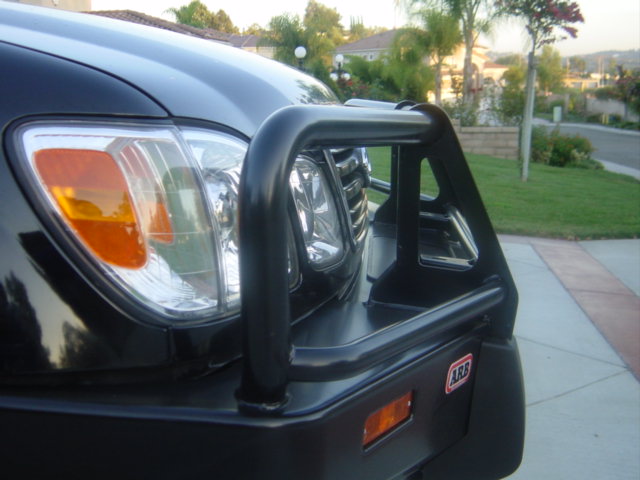

OK, you learn something new everyday. Can you take a close up picture of how it fits underneath the lights and also in front of the grill with the hood open? Did they trim any bodywork on the truck?
We tried bending the trim pieces first but it definately wasnt enough. We did end up trimming the pieces under the lights. The center of the bull bar matched up pretty well. We had to do a few other minor things too. We fought with it for almost two full days.

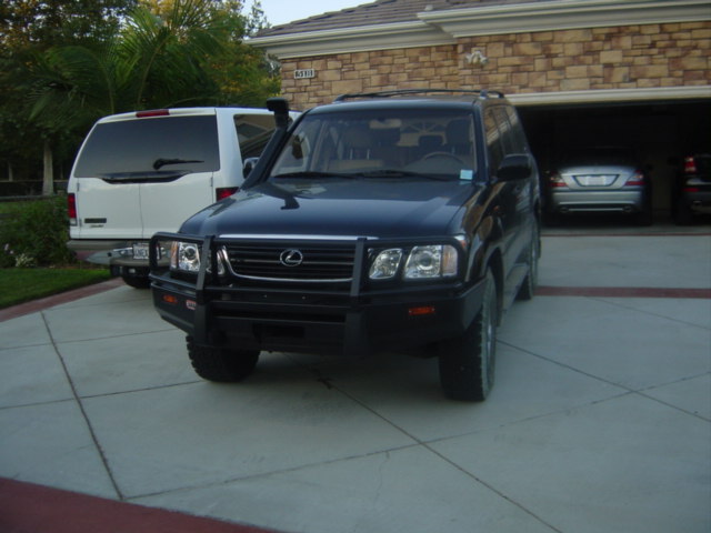

I love the snorkle!
Aha, I knew I wasn't crazy. Some might disagree. So it was not a direct bolt on.

We didnt charge him 2 days to put it on of course. We actually stayed pretty close to the original quote I believe. We will probably charge more for the next one we do now that we know what we are in for.
If it absolutley would not have fit we could of went back to the stock bumper. The pieces we trimmed really serve no purpose and are not visible with the bumpers on.

We had to work with that as well. The snorkel runs into your antenna in the body.
+ they kept the Power Antenna!
I keep going back to that beautiful snorkle, where did you put the antenna?
In the same place! hehehe

I would really like to know how that was possible. Is the LX power antenna a different design or in a different location? I couldn't manage to keep my power antenna and had to replace it with an OEM manual one..
