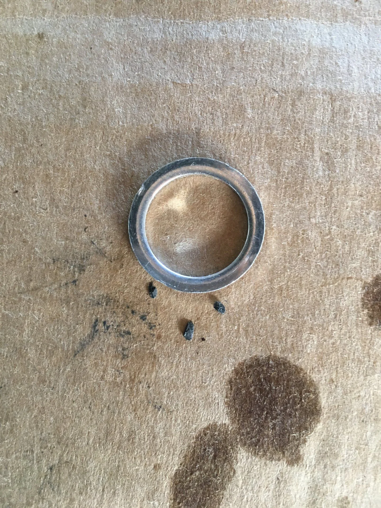

Is my T-case screwed? (Small metal on magnet)
Apr 21, 2017
8
30
San Jose, CA
Changed out a bunch of fluids today, including the T-case. There were three very small pieces of metal (see photo) on the magnet. Should I be concerned about this? Is it possible these were picked up from the last fluid change (e.g. The shop floor)? Finally, is there any other tests I can do to see if there is indeed damage to the T-case (the car seems to be driving fine. There is a slight thud at times, like a few seconds after I come to a stop, or let off the accelerator to coast on the freeway. However, these seem to be consistant with the slip yoke thud there is already a thread about, but maybe I'm wrong). Thanks in advance!
I wouldn't worry about it. Those could be from anywhere, if it's driving fine, let sleeping dogs lie.
Drain and refill.
This is all good news. No, definitely not looking for a reason to pull the T-case.
