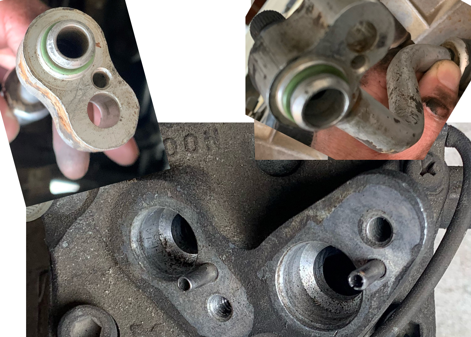

Hi guys, hoping someone might have some advice for me. I've got a May 1993 1FZFE which I believe was originally fitted with an R12 system. The compressor had been removed before I bought the car. Not knowing much about this area of the car, I was at a wreckers recently and impulsively I bought an 80 series compressor (which is supposed to work) to suit a 1FZ-FE, not realising that my car was originally R12. So I now have a R134a compressor, and I can see that the hoses don't fit - the small guide poles are on the wrong side for the large and small connections. Chatting to a local mechanic they said it would save a lot of mucking around if I kept the same hoses and that they should be fine for R134a, if I could get the right connection plate/adaptors, and as long as I replaced a couple of other bits (the filter/drier I think they said).
My question is - is there an adaptor plate or or a way to connect these existing hoses to this compressor I now have? I'm in Australia. I've seen some adaptor plates/connectors that look promising. I can't mind much info on the Denso model I have at all - 447200-3545. It was a bit over $100 - a bit better than $600 for something new. But if I have to go down the new route, I will.

Actually I see now that those little guide posts can be easily removed....which means the r12 hoses now fit into the holes. Whether or not that is right remains to be seen!
