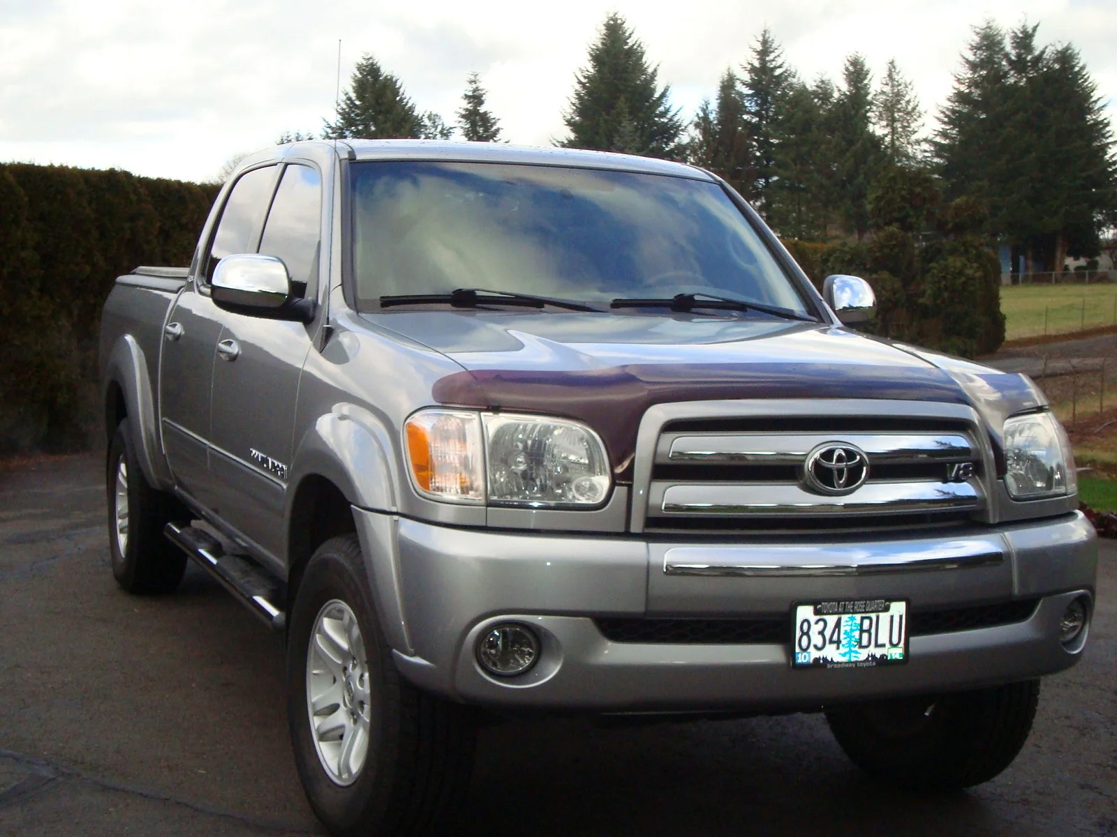

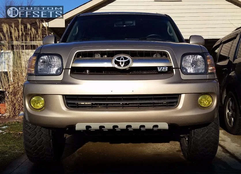

The bumper/grille is different between the two, but headlights I believe are the same. The Sequoia bumper has this middle section sticking up and the grille is shorter because of that, while Tundra's grille extends all the way down to the bumper which has no "bulge" in the middle. The little trim pieces under the headlights look a little different too.
Sequoia:
36559-2-2005-sequoia-toyota-suspension-lift-3-mayhem-riot-black-slightly-aggressive.webp
Tundra:
2005_toyota_tundra_4_dr_sr5_v8_4wd_crew_cab_sb-pic-2928629395626748186-3152621075.webp
So you think it's just cosmetics, not attachment points incompatibility? I personally really don't see why these trucks should be significantly different underneath the plastic, but ARBs insistence it can't be done gives me a pause.
