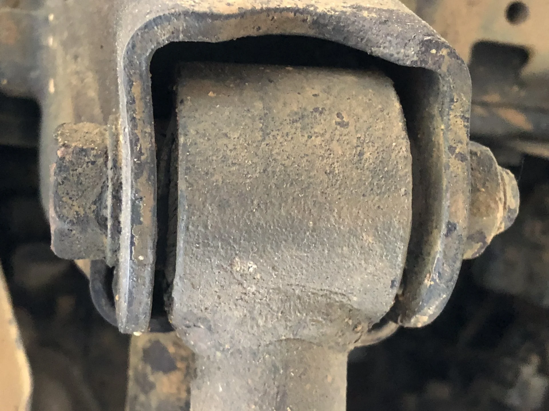

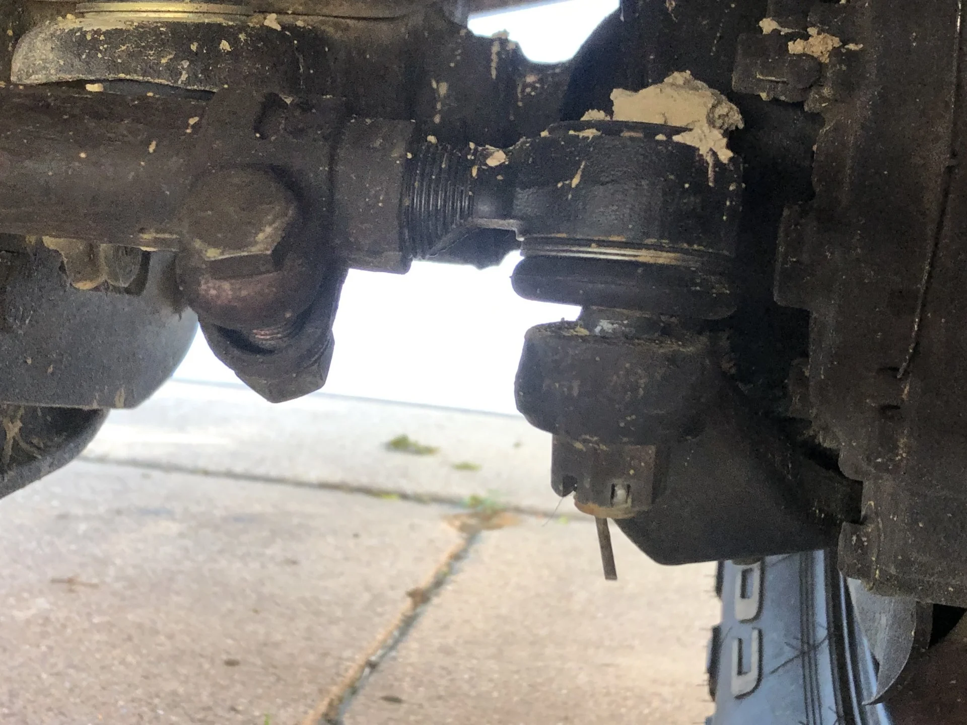

So does that sound like a typical case of death wobble in an 80? Or is it something else? I've fairly recently (recently enough that this shouldn't be a problem) had tie rod ends redone, and no other steering or suspension issues were noted by the shop at the time. The only thing I can easily notice underneath is that the boots/bushings/whatever on the ends of the straight rod that goes across behind the front axle (I do not know the name of this rod/bar thingy, so please feel free to enlighten me) appear to be crushed on one side and possibly oriented on somewhat different angles... see attached pictures for the left (first pic) and right (second pic) of that observation...

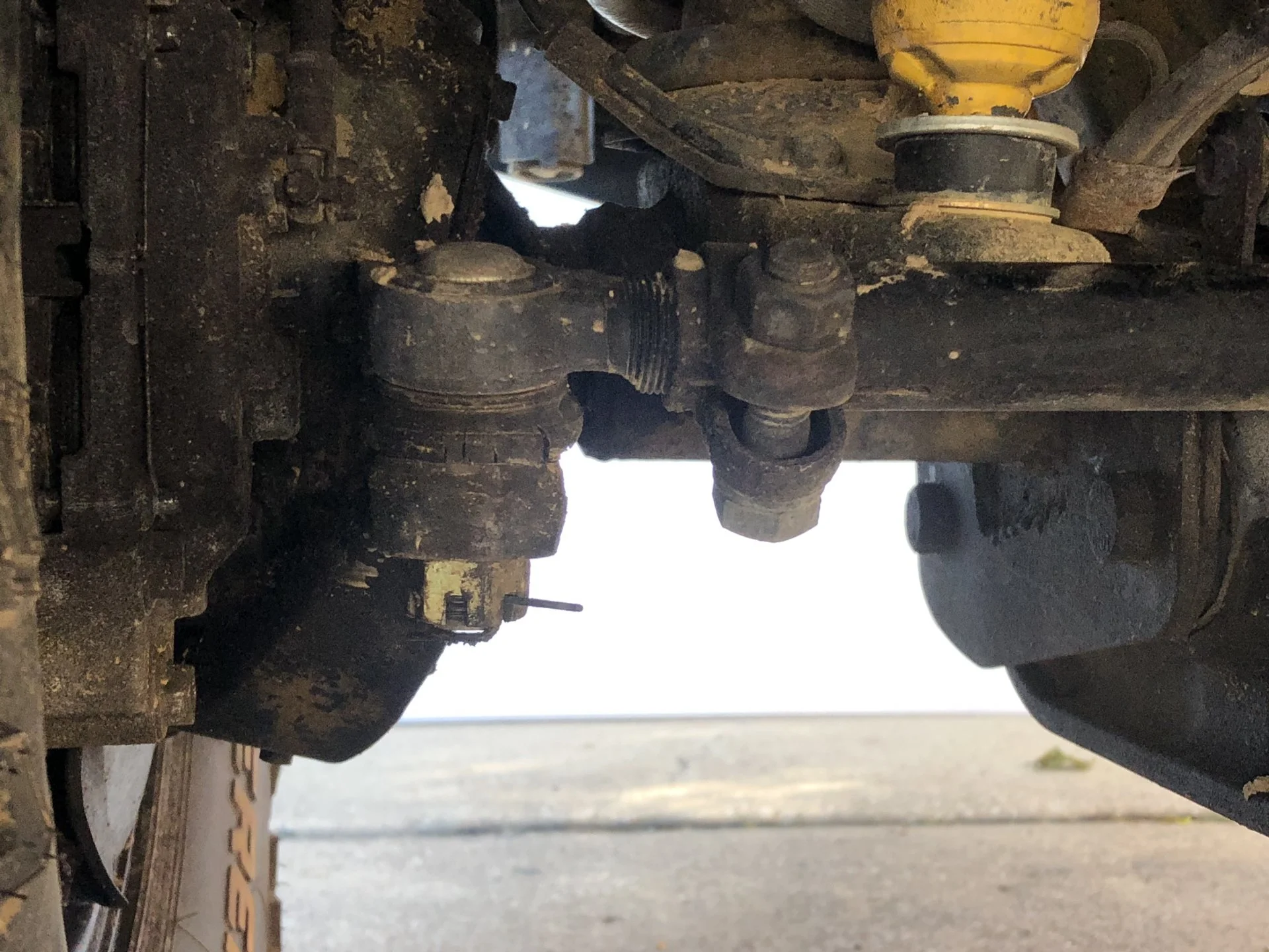

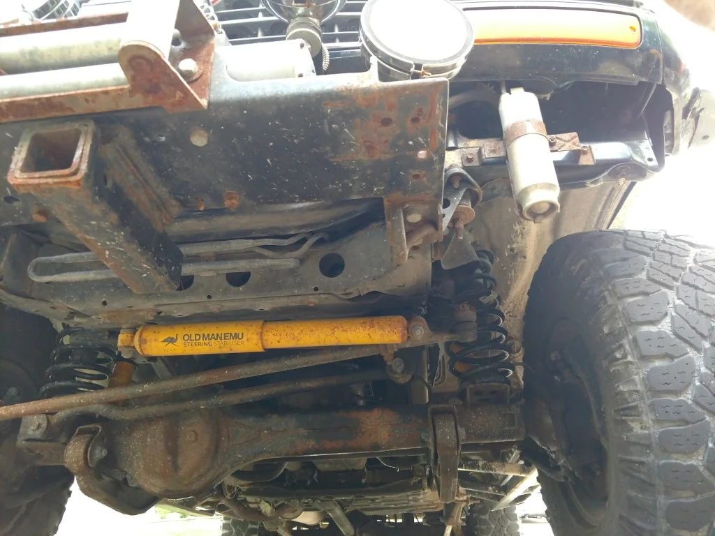

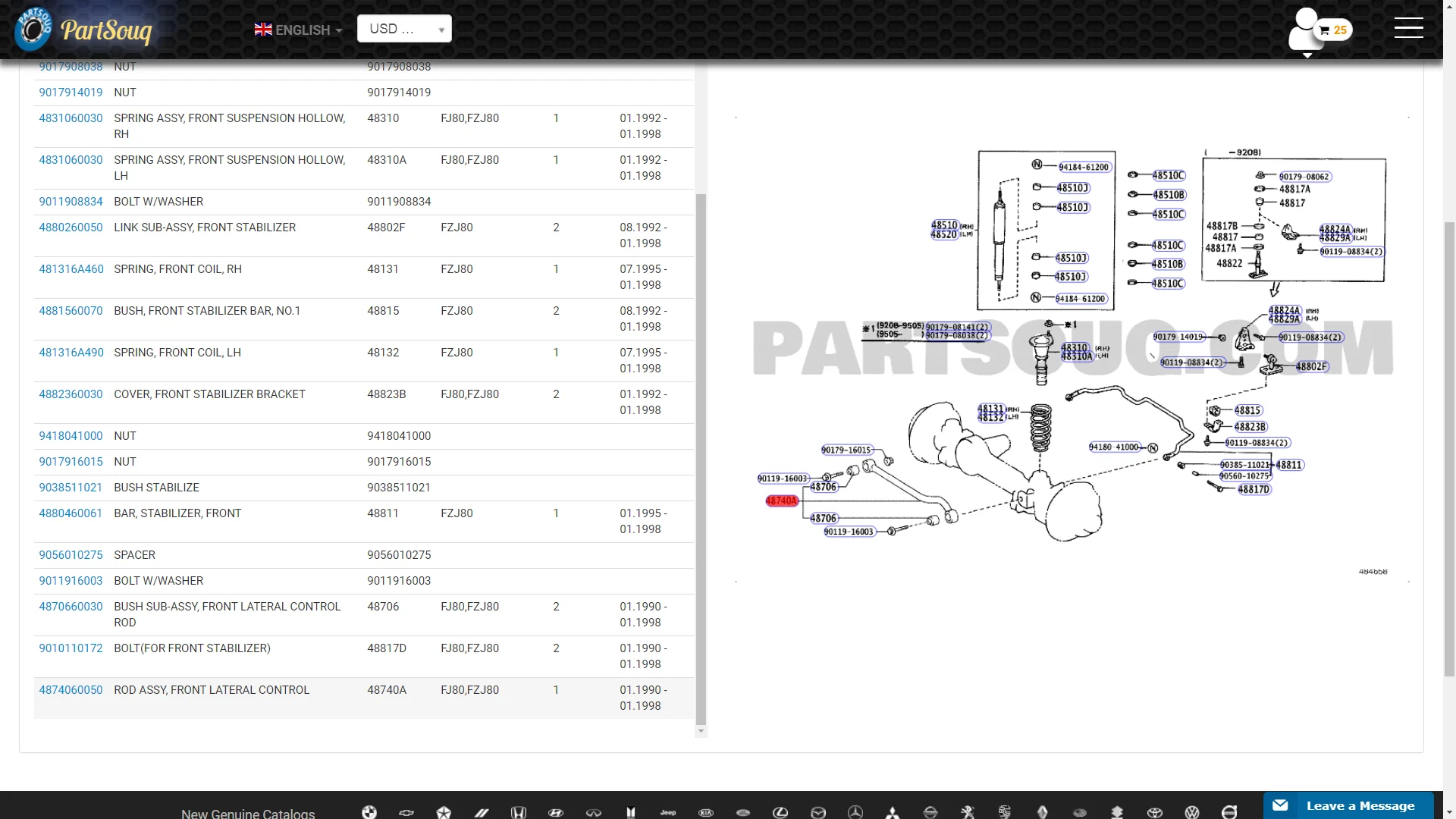

The panhard bar is what is listed below as "ROD ASSEMBLY, FRONT LATERAL CONTROL" When you bend over and look under the front of your truck, you see two rods. One is the drag link that attaches the steering gear to the lower right steering arm on the right front knuckle.
The other is the panhard bar that attaches to on end of the axle housing and the other end to the frame under the steering gear.
The yellow thing is the steering damper
The rod just under and behind it is the drag link.
The next rod with the bend in the left side of the picture (right side of the truck) is the panhard bar (lateral control rod assembly)

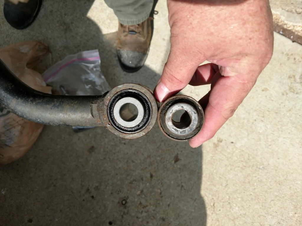

You look at your bushings under the truck that are pressed into each end.
The bushing in my hand is the old one. See how it is weather checked, cracked, and dry and it is delaminating from the bushing. That's a problem.
The new bushing is already pressed into the rod end on my front panhard bar.

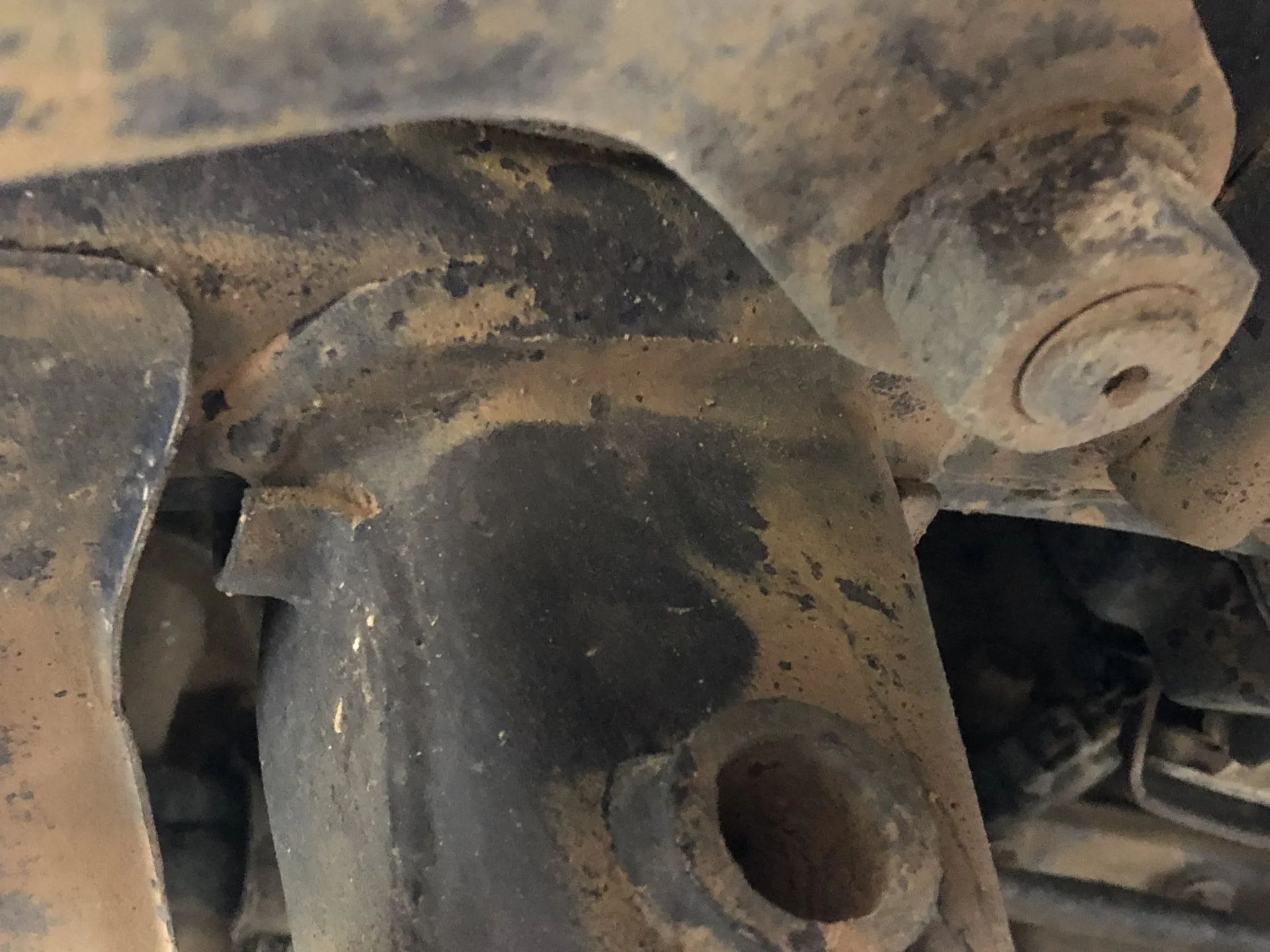

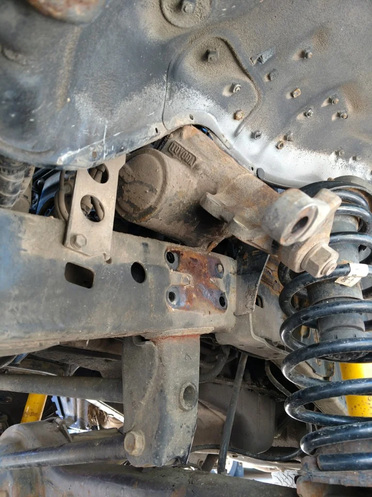

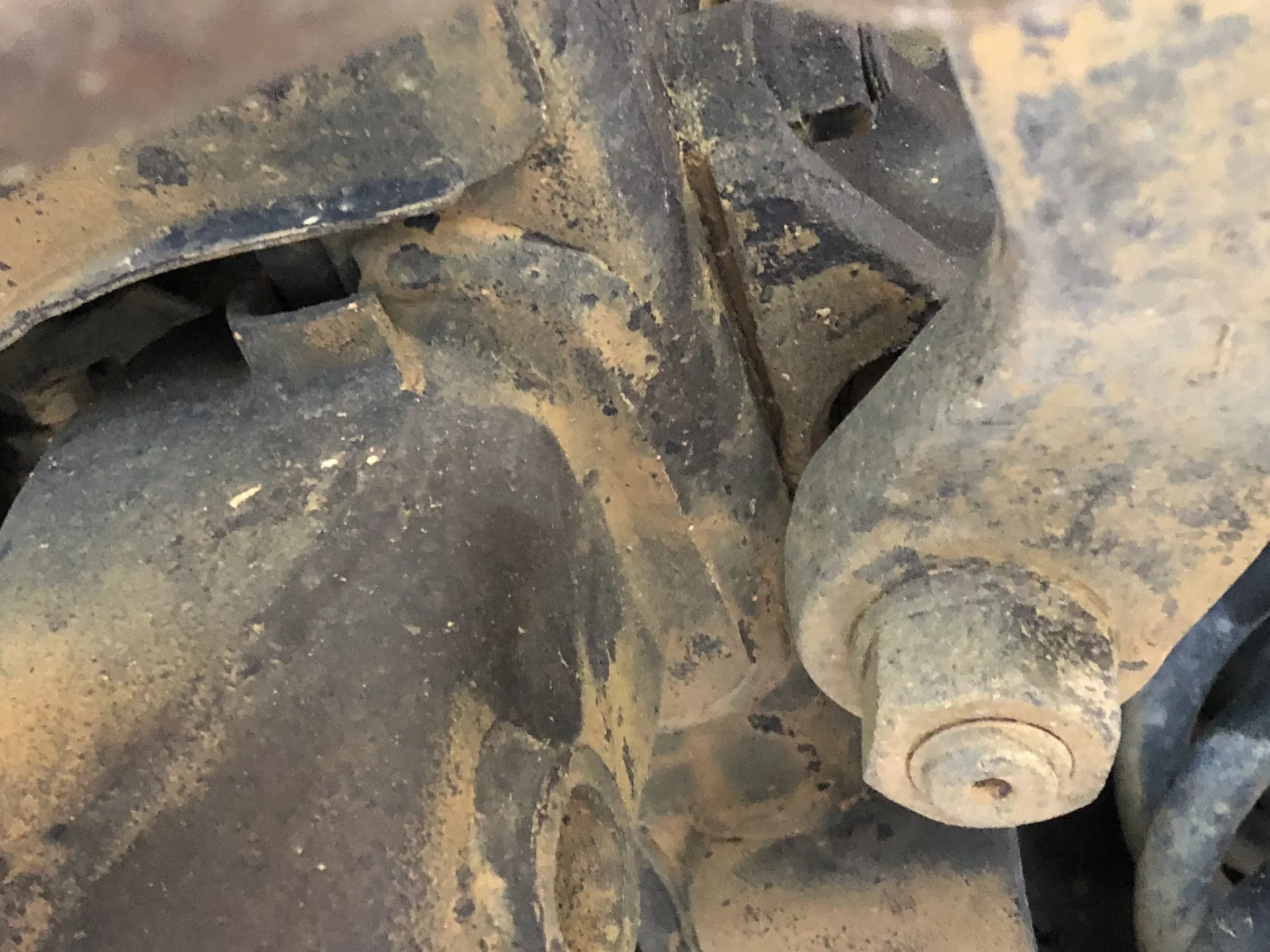

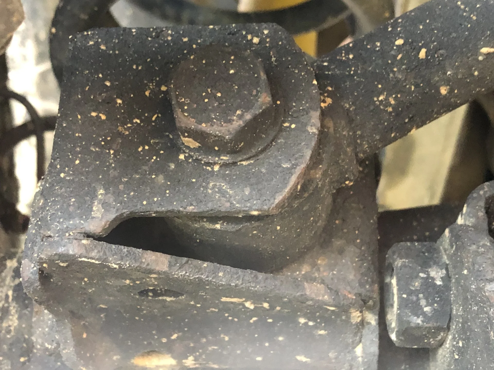

Some pics of the frame mount and the area around the bushings. Everything feels pretty solid when I yank on it, and I’m not seeing any crack, but I haven’t taken it off to check bushings or followed the advice above to clean carefully and use a bright light… can bushings be checked without removing the panhard bar?

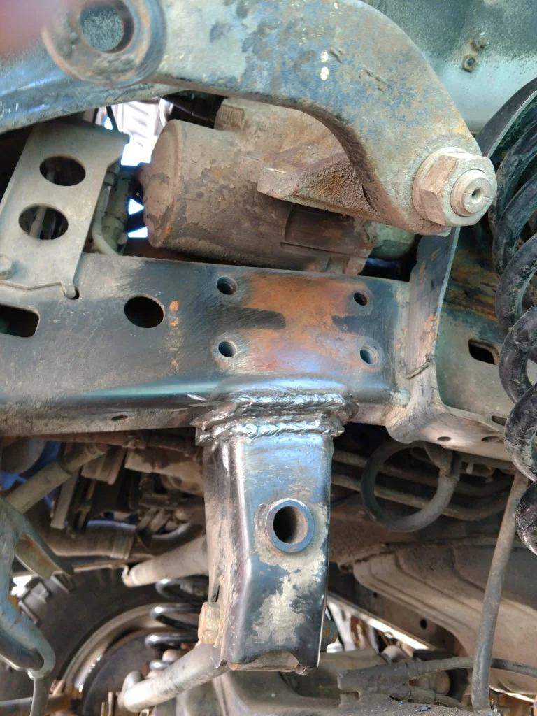

Pics of a cracked panhard frame bracket and some ugly welding to glue it back together.
In the first pic, the rusty line where the bracket meets the frame is the crack.
In your second picture, the left side, you can see hunks of your bushing blown out.
You DEFINITELY need new bushings. I would suggest you do ALL your suspension bushings with OEM, especially if they have never been changed.
If that’s where it cracks, then I think I’m good…
Alright, so panhard bushings are bad. Good to know!! Thank you!
might be time to head to a shop, I definitely don’t have the know how or tools to knock out old and press new bushings…
