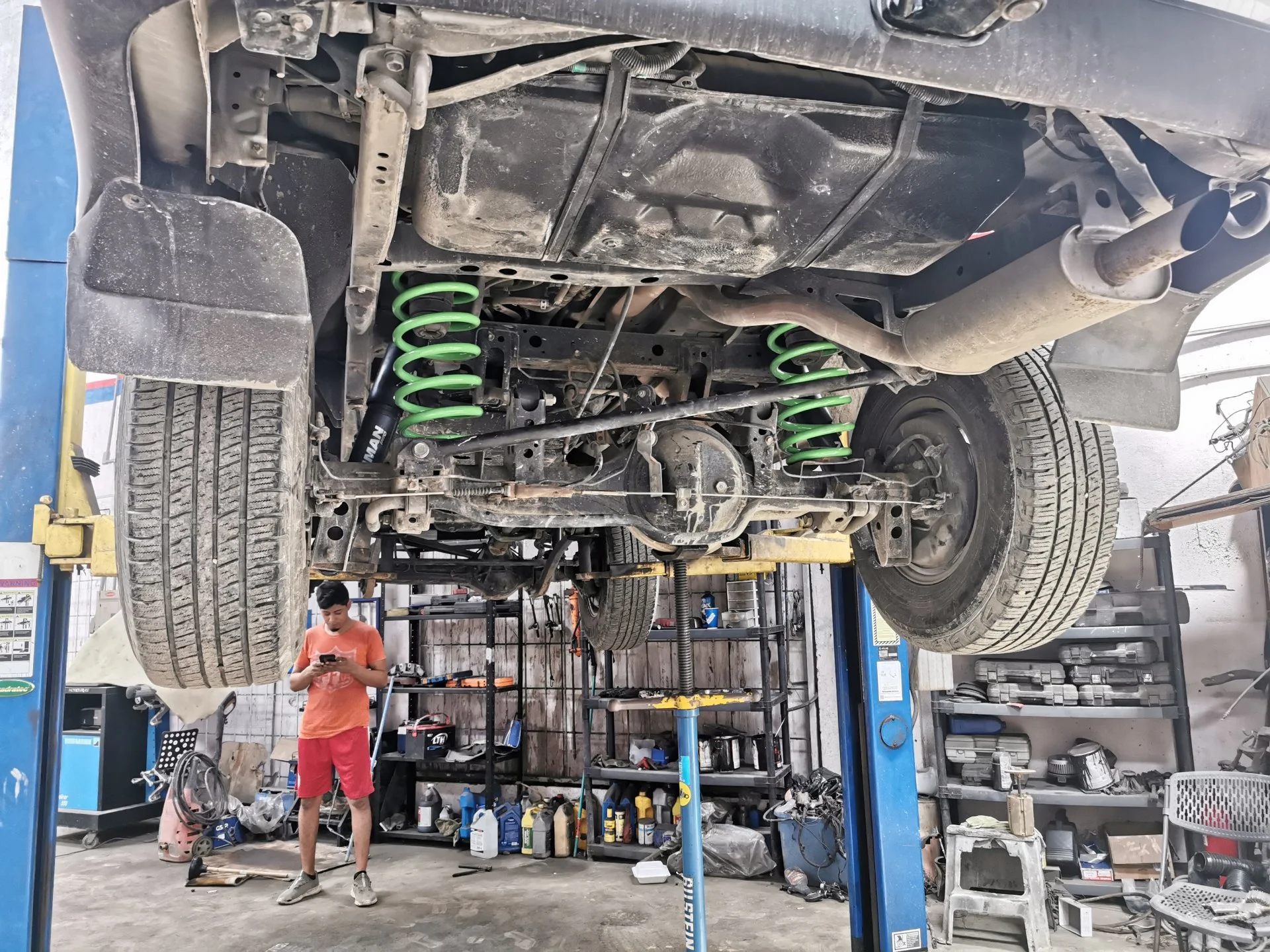

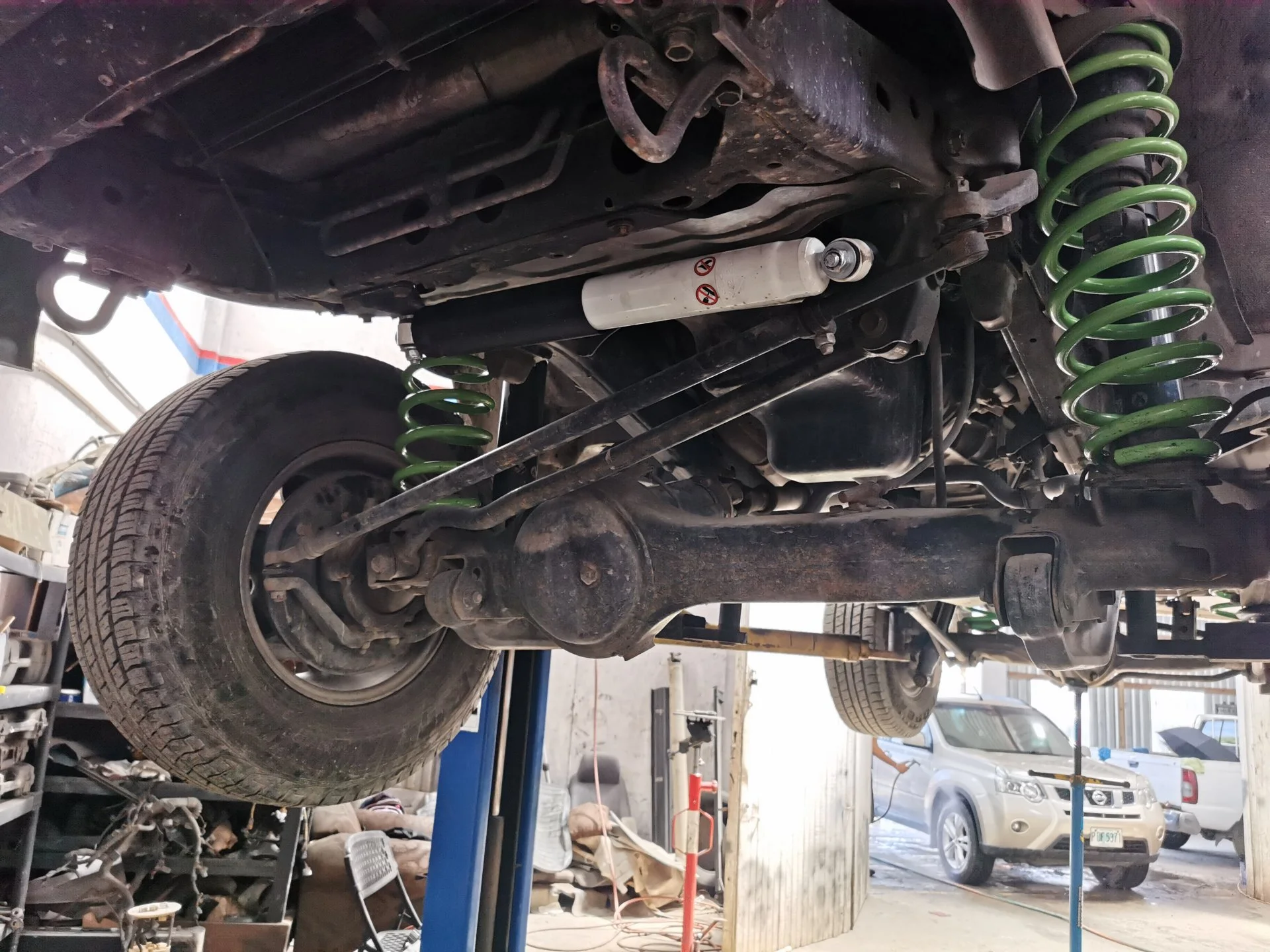

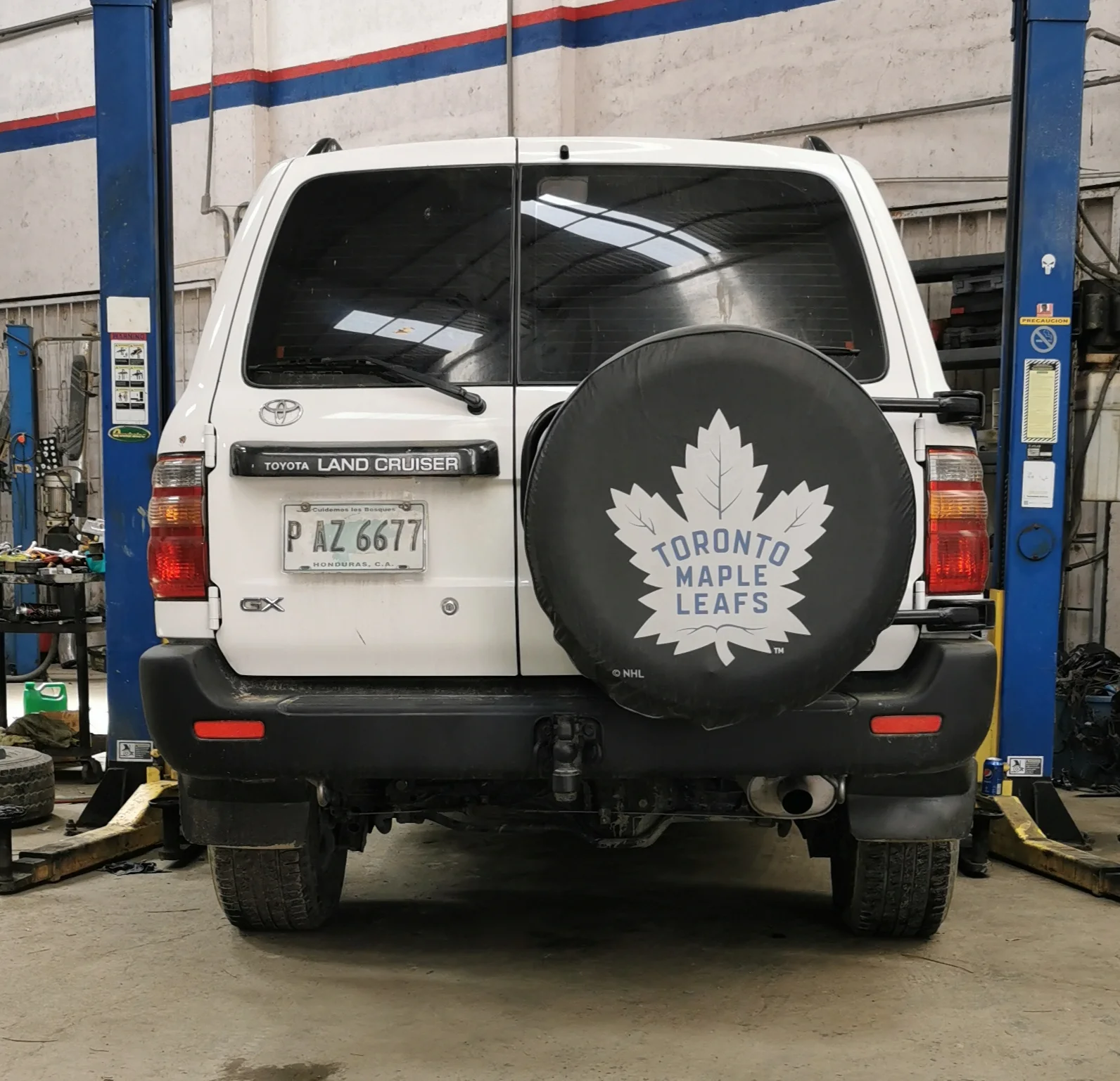

Howdy again. I just had my Ironman Stage One 2inch Lift with Foam Shocks installed on my 105 (Had to buy the 80 kit) and the Right Side is 1 inch higher than the other. Is there an obvious f&$k up my "mechanic" made? He's stumped. My mechanical skills are limited to 1 year of shop class, so I'm stumped too. There is no way to put them on the wrong sides, right? Thanks.

Mechanic claims his shop guys didn't see any. Are they clearly marked? Don't see how this could have been overlooked so easily. Rear is exactly one inch higher on the passenger side and front is 3/4 inch.
Hard to tell from the Pic, but I noticed it right away when it came off the lift. Took it for a drive down a bumpy road to see if it "settled". Nope.
I don’t know if @Ironman 4x4 USA springs are clearly marked L or R, but I’d wager the shop guys did not compare free heights before installing.
