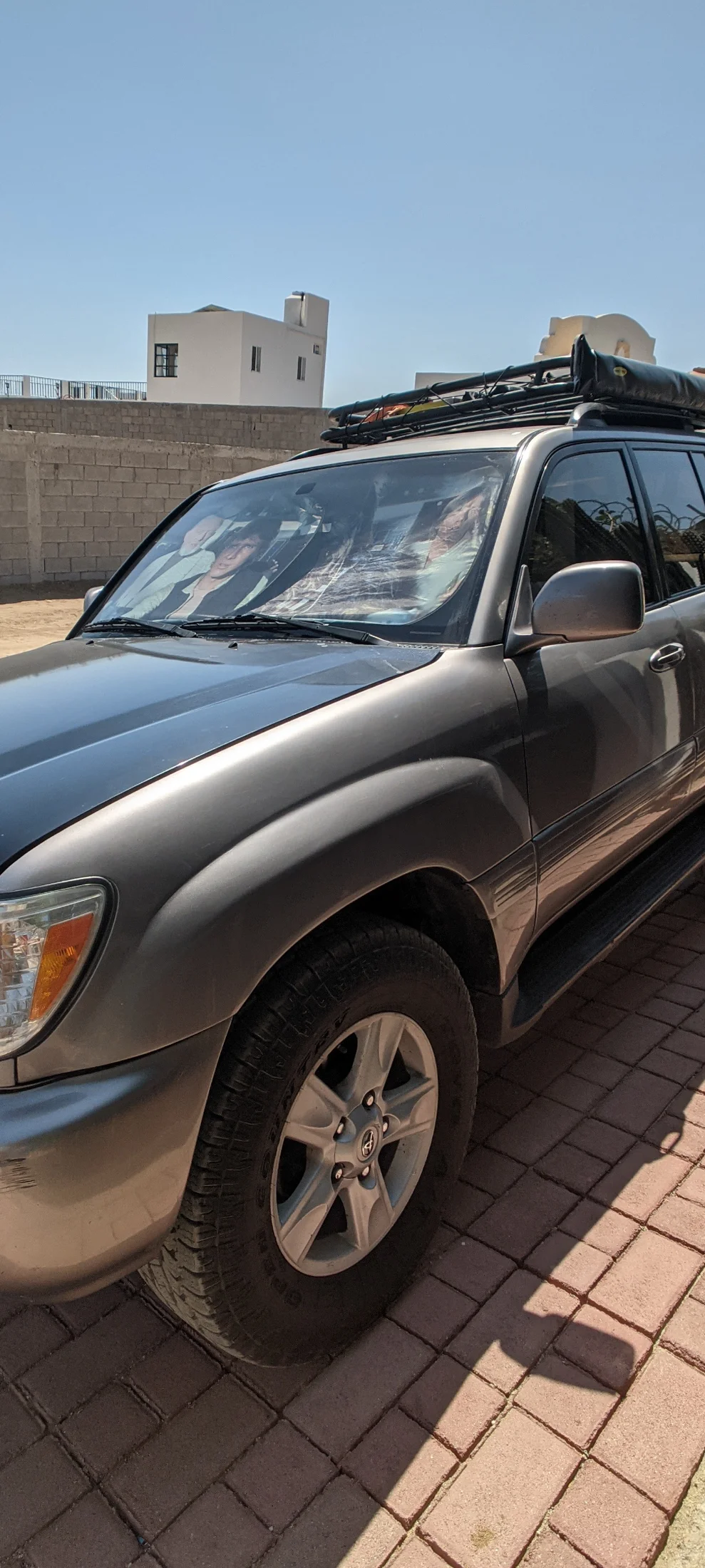

New 100 Series owner with a question (tire rub, one side)
Heres a video on what I did to fit my 18" methods on 275/70/18.
So it did rub when turning the wheel side to side.
Do you think those stock newer 18 land cruiser wheels with my ko2s 275 70 18s will work without cutting anything up?
I used to have the tundra 18" wheels (no spacers) and those did not rubbed.
But once I got the method had to do the modifications. I think it's because most aftermarket wheels are 8.5 - 9 width and that make it rub when turning.
I just found a set of tundra 18" steel wheels, the five spoke style for $100 with caps. I am going to get them on Tuesday and have them powder coated or just paint them and swap my tires over. When these wear out I'll get some new wheels.
I had an alignment done yesterday, they got the caster over 3 on both sides. Still rubs a little bit on the passenger side, but drives a lot better.
