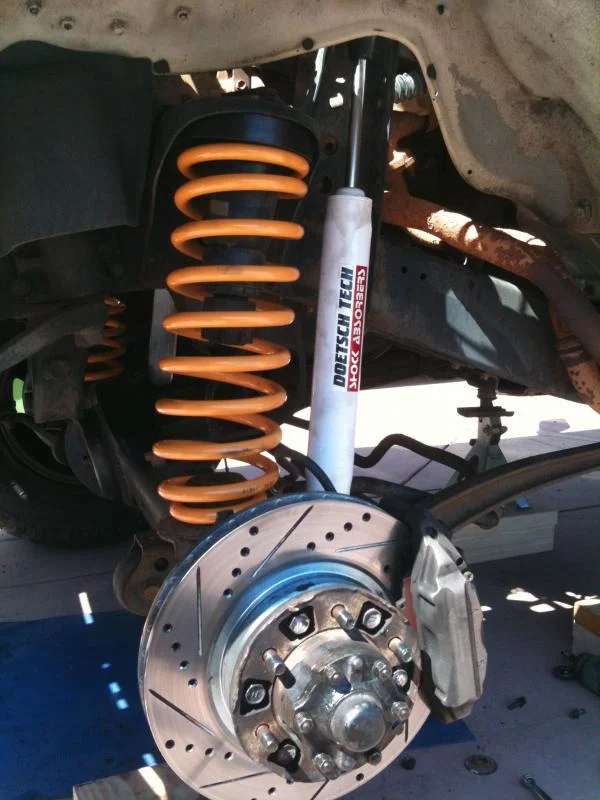

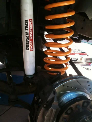

Hi there, finally lifted the rig, feels way better now,
i did the 30 MAF spacers + iron man springs in the front. with 26" doetsch tech shocks
and for the rear just iron man springs and doestch tech 24" shocks again
I also wanna say thank you for the instructions on SLEE offroad. and thank to Eli at 4x4 Camel for being very helpfull, same goes to doetsch tech (they were quick and had all my questions answered). IMG_2232.webp
btw dont tell me to remove the so called "damage multiplier" because i will be doing that pretty soon ;). thx in advance
Nice rotors! So from what I've gathered, you have to call Doetsch and have them customize your shocks to fit, correct? My Ironman springs are on the way, just gotta get me the shocks :D

So what you do is call Doetsch Tech and talk to them and make sure they have all your stuff in stock. they dont provide steering dampers for this land cruiser bc whom ever built the locking pins for them went out of business. so i just got an ironman one. and ordering the shocks is really easy you just fill out the form online on there website.
