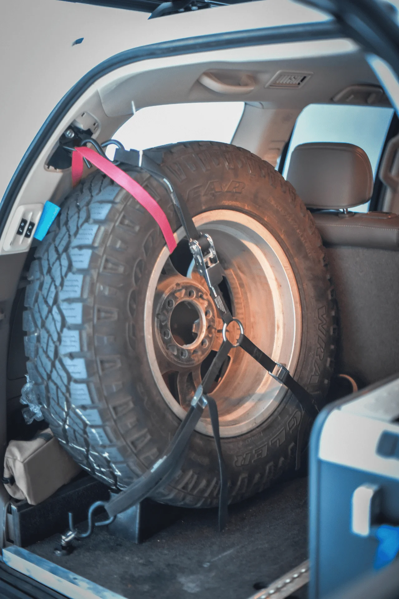

So I have a working vertical interior tire solution now (255/70R18 on OEM wheel). The core is a yakima "Y" shaped tire carrier ratchet using the third row seatbelt mount (swapped to a D ring). With my DIY platform, I used aircraft track so able to attached to load points. The red strap is a secondary backup. There are rubber tire chocks - but those mainly just help me stabilize before the strap is tight. This is mounted driver's side, and I still have (tight) access to the factory jack.
Hope this sparks some ideas - and an even better solution!

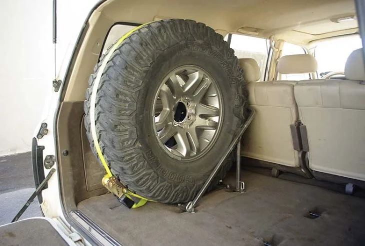

This pic is of is an 80, which gives some excellent mounting points to work with thanks to the 3rd row attachment points. From what I've learned we don't really have anything solid to bolt into on the fender side of things, and the floor (at least with the 3rd row in place) is almost equally bad. I don't even like strapping down my go-box in the back, those "tie-downs" feel like they're made of Lego.
Here's a solution I like from the T4R forums toyota-4runner.org:
We've got grab handles and the aforementioned seat belt mount to work with up top, but nothing on the bulkhead and the floor is a DIY thing for us 3row suckers. Something like this built off of nw_fj62's most excellent floor would be just the ticket. I think it's the best looking solution I've seen so far.

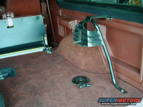

If you could take the mount in your photo and add a plate with a couple of wheel studs, you wouldn't need any straps, just bolt it on!
The only design consideration would be to have the vertical plate with the horizontal wheel studs, have the ability to raise and lower to accommodate various tires sizes (diameters) and still rest the weight of the wheel on the deck, not suspended.
You're speaking my language. I much prefer the idea of mounting to the lugs, or hub, and then using a strap as a backup. The tires on my XJ were much larger than OEM, resulting in the bracket sitting at a funny angle. It was still rock solid, but I suspect any taller and you'd have issues. You can see the angle of the attachment in this pic:
ACtC-3fasKiVr9aFl4v6RJpWW4-wUFhMqx39khmt8jYHxlsrNEG7mln035QcrC9vZybu5ncrX8v-5hoftzQPyeKClaDhHM2rz9A6FWr_kwqLS6ixL6XRlf-YQuVP-jLcaHeqDs7NKL_Q6ONDsiR3wTYk3iPv=w1325-h883-no
So if the 4Runner mount had a plate in the middle, with a vertical slot that my "hub mount" bar could slide up and down to accommodate various sizes, it would be just about perfect.
Here's a pic of a Bronco that looks like it has some vertical adjustment built in.
That plate, on the 4Runner's hoop, bolted to the floor and grab handles. Now we're in business.
BINGO!

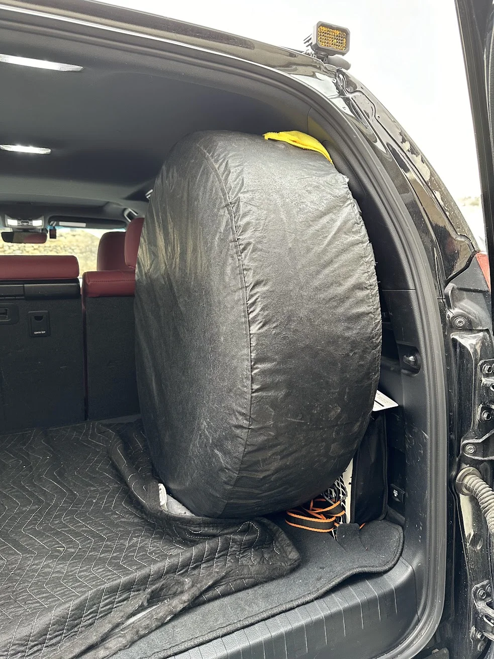

I just wedge mine behind the back passenger seat and ratchet strap it to the tie down points and the grab handles. Not the best solution, but it doesn't move even on offroad trips due to the seat and is temporary until I have time to build the rear tire carrier. A 285/70/17 is about as big as you can go depth wise there.
I like this method. Even if only configured for expected offroad use it just seems convenient.
Glad to see that works. I have a tendency to overthink things.
