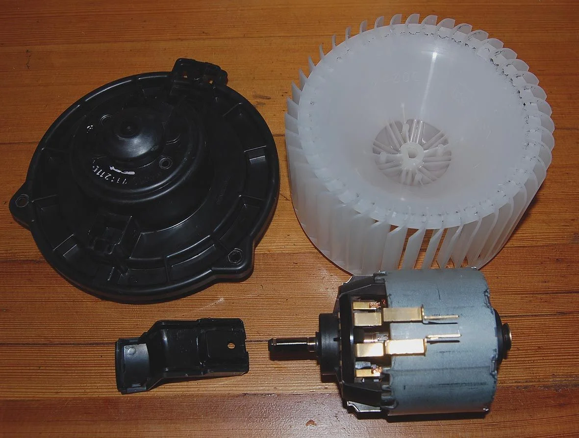

It immediately sounded better and came on quicker once reinstalled. I will monitor. I did not have any electrical connector grease or contact cleaner. I plan to buy both. You can see in between the housing and the fan vanes two copper connectors that looked really dirty. I think that could be causing the issue. I want to clean those, clean the vanes better, and add the grease to the connector. Those copper connectors on the side. This is a borrowed picture from the web. I was not able to separate the vanes from the motor. I had limited time.
I have been unable to separate the vanes from the motor. Vanes are held in place by a pin/axle from the motor that clicks into the vanes "hub". Theoretically you could push aside a plastic pin in the hub center ring to allow the axle to slip out, but I could for the life of me not get it to budge.

If this were to become an issue, I would jsut replace the whole setup. Not cheap, but saves time and you're sure to get it working perfectly afterwards. The whole unit is one part, I checked when I looked at mine.
This topic has been discussed in other threads (I think among others the FAQ thread that I started about retrofitting the cabin air filters to LX/100 that does not have them by swapping out the cover), someone there managed to get the vanes off and clean it all up.
I hadn't remembered this yesterday but now do recall that I had tried to take apart the assembly as well and couldn't get the vanes separated. I tried everything I could think of to take it apart and it didn't want to budge so I replaced it.
