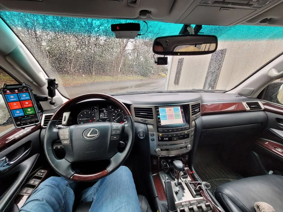

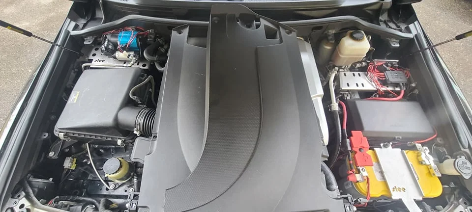

I'm considering this setup now. How do you like the Garmin Overlander? I'll be running two sets of lights, two compressors and Front/Rear lockers from whatever interface I choose. The fact that I can mount a PowerSwitch up front for those mods, and add one in the back for all my other accessories is a nice bonus. My biggest concern is that I won't be happy with the phone control or the Overlander unit. Would you have any hesitation using it to control eLockers?
I’m sure it will work with the lockers but I have my lockers controlled with the 80 series stock dash locker switch. The 80 series locker switch fits perfectly in the 100 series by pulling off that switch and popping it on. So when I turn it it activates my front locker after I activate the rear locker. Gives it a super nice factory look.

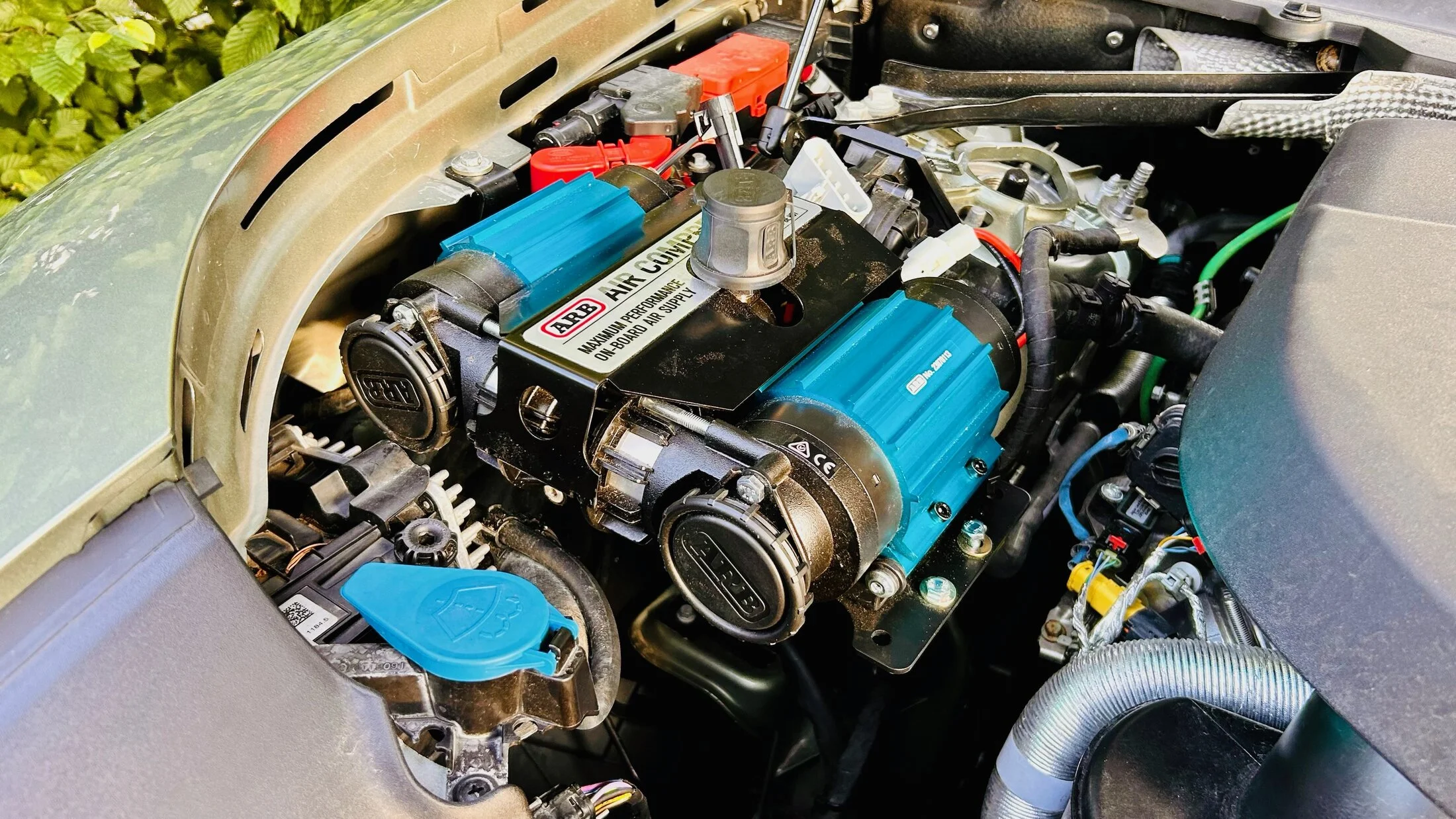

Hi, I am considering Garmin Power Switch for my New Defender 90. I have already mounted an ARB Double Compressor. How exactly does the wiring look like? Can you help me? Best from Munich (Germany)
