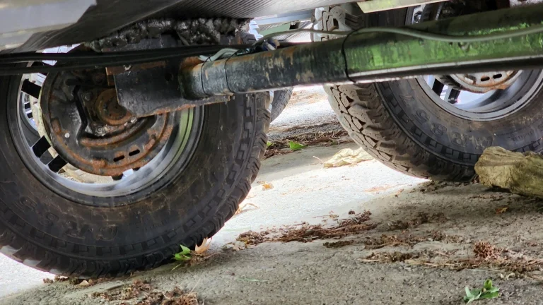

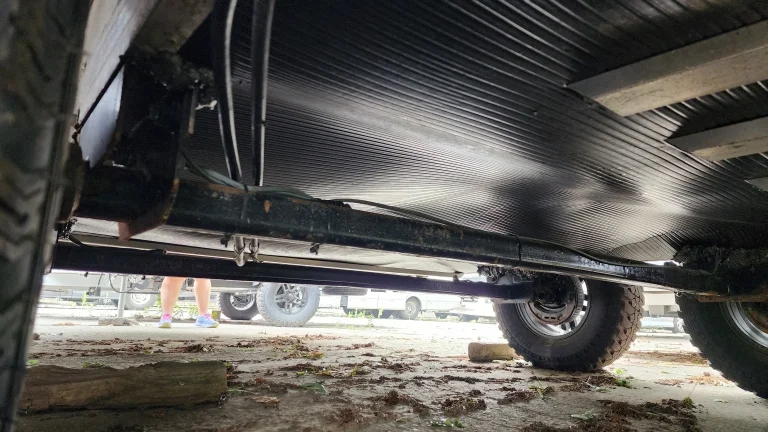

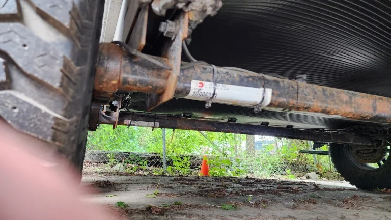

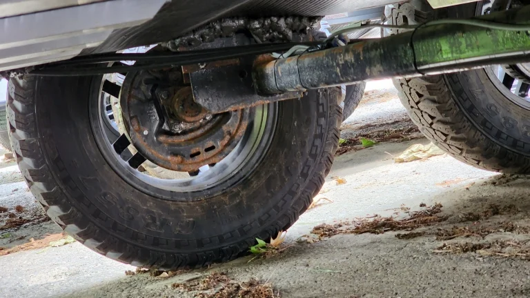

The trailer and options ticked all of our boxes but I noticed a couple of things that made me a bit nervous. The 2 issues were: rust on the suspension and placement of the propane and other hoses. The suspension is Dexter which is good IMHO. But with regard to the hoses it looks to me like they would catch on and/or be bumped by all kinds of things. I’d be satisfied with either metal or fiberglass skid plates to protect them but doing that on my own would certainly void any warranty. The dealer is very accommodating and might do a skid-plate mod (we bought our first travel trailer from them) but I didn’t bring it up as I was just kicking the tires, so to speak.

Depends on what you consider to be "off road capable". Maybe to the secluded lake or campground with forest service roads access. But any even slightly challenging terrain, would, in my opinion, be over extending it's capability. That particular dual axle design is NOT very off road worthy. I don't see ANY springs, leaf or coil! And are those welds? In rough terrain, wheels would be off the ground part of the time at best and IMHO, they are supposed to be load bearing, for weight distribution, so the frame would be stressed significantly with the added vibration of off road travel. With the quality of trailers being manufactured today, plus the rust on the suspension shown in your pics, I'd have serious doubts that this trailer would survive more than a couple of seasons, at best.

Regarding the welds - yes indeed they are welds and the manufacturer touts it as being really great! I hadn't considered resultant stresses on the frame in severe off-road conditions given the suspension design. That suspension is an "upgrade", btw. I have no idea what their standard suspension consists of. Maybe their std. suspension is actually better for us.

Torflex axles are listed, they don't have exposed springs because they are torsion axles. Likely the std. suspension is trailer springs, which will offer the worst possible ride. Be wary of your eggs breaking and your beer being foamed!
That rather ugly, bubbly stuff is spray foam. The welds are clearly GMAW, likely a spool gun, on the aluminum frame. Those black smudge marks are a clear indicator of this. I'm not a fan of AL frames on trailers or bicycles, but there's enough examples out there that prove my concerns to be a pretty low probability. Still, I won't own one of either.

It was the aluminum frame that originally caught my notice but I'm wondering about condensation & mold as every aluminum member is a heat pipe to the outside. I haven't found out how they insulate the walls or if the inside walls actually touch the aluminum framing. The other thing I thought was weird that I mentioned in my OP was the exposed gas lines. I'm thinking they should have been at least run along the framing members. Even our first trailer had that.
I did notice and look up the Dexter torsion axles but couldn't get a sense of how tough they were. I took time to find out the suspension design after almost buying a Black Series. It turns out the suspension on a Black Series is quite rugged but entirely manufactured and sourced in China meaning you can't get spare parts. There were other issues with that brand but I learned to check out the suspension.

Generally the Torflex axles are tough enough for most all uses. Can get into the axle chosen needing to have bigger wheel bearings for truly off-road use, but that happens with pretty much any suspension design. Years ago A/T made a stink about one that supposedly de-vulcanized the rubber allowing the whole spindle/lever/bar assembly to walk out of the housing. To my knowledge pictures of this event have never been found. Though slowly dissipating the bad word continues to reverberate on the net (dig deep enough here and you'll find discussions about it). Coincidentally this supposed event happened not long before A/T came out with their own trailer suspension design. Draw your own conclusions.
I can tell you that the Torflex under our tiny, light TrailBlazer tent trailer (there's a thread here on those) had shocks added to it almost as soon as the OP took possession. Since then it has been all over the South-West, up and down Baja several times, Copper Canyon, and clear up to the Oregon Coast without any trouble. I suspect that IF the Torflex de-vulcanization did happen that it did not happen by the method reported as that would be impossible. The most likely way for something like that claim to happen would be from excessive heat. I can't prove it, but I suspect that adding shocks moves enough heat out of the rubber and puts it in the shocks, which is what they do - turn motion energy into heat, that the possibility of over-heating the rubber in the axle is very low.

Hangy-down parts seems to be the default design choice with U.S. RV designers. They don't have to deal with the results of customers taking the trailer where their marketing people imply that it can go and I'm sure that any warranty claims are denied as "Use beyond the intended scope" or some such similar wording. From a mfg perspective routing the propane lines thru holes in the frame to tuck them up better is a problem for assembly (slower, more steps involved) and a problem for long-ish term durability (dissimilar metals or abrasion). Better would be for those lines to be inside.
