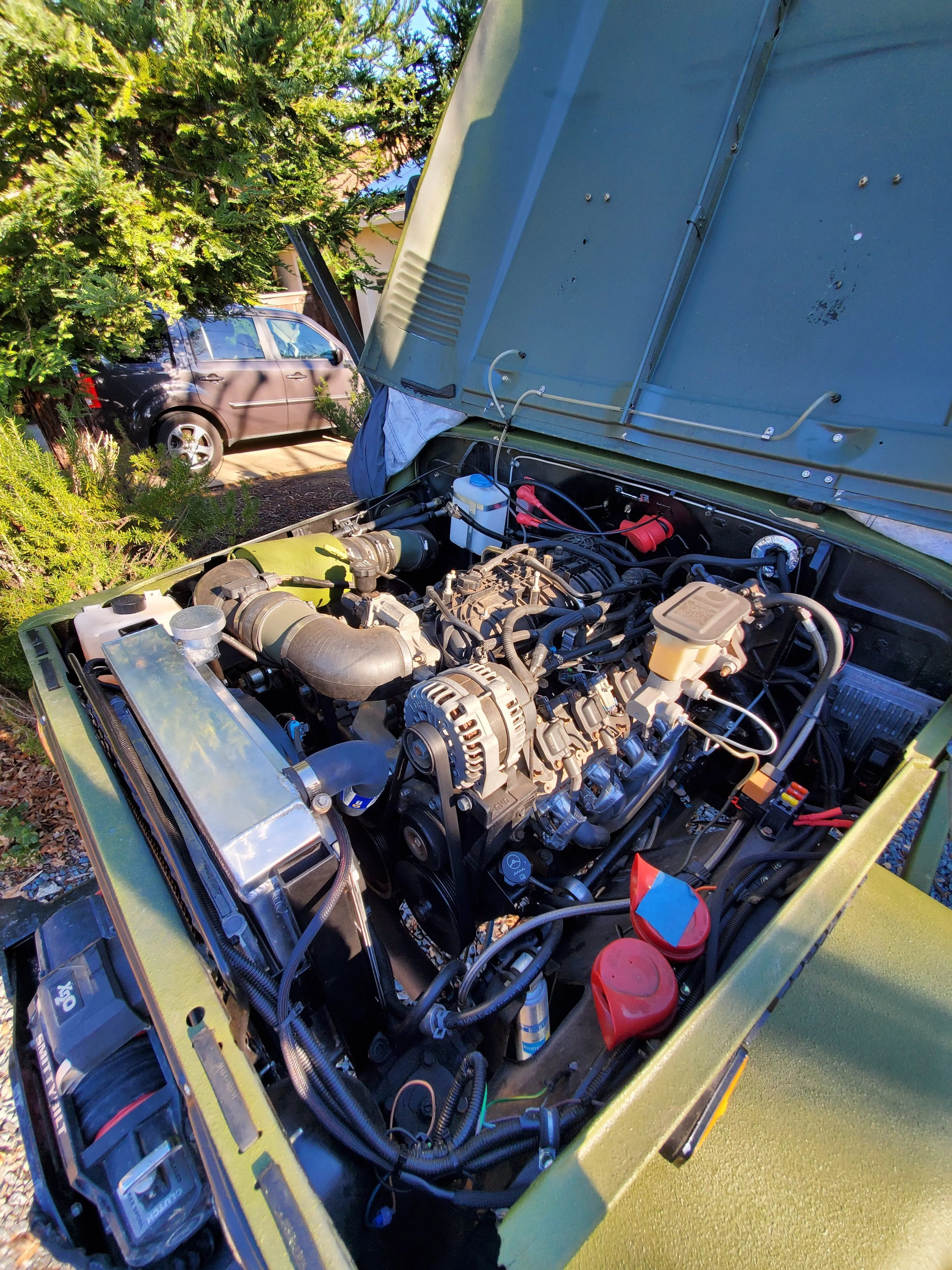

Heres an old picture of my engine bay and why it's so cramped with that large filter cylinder. Making some heat shields or covering them with heat shield might help. Something I need to do when I finally stop putting different motors in the thing.
That's a good way to do it. You got me beat for room, my cruiser has coilovers up front and the hoops and engine brace also take up some good room.

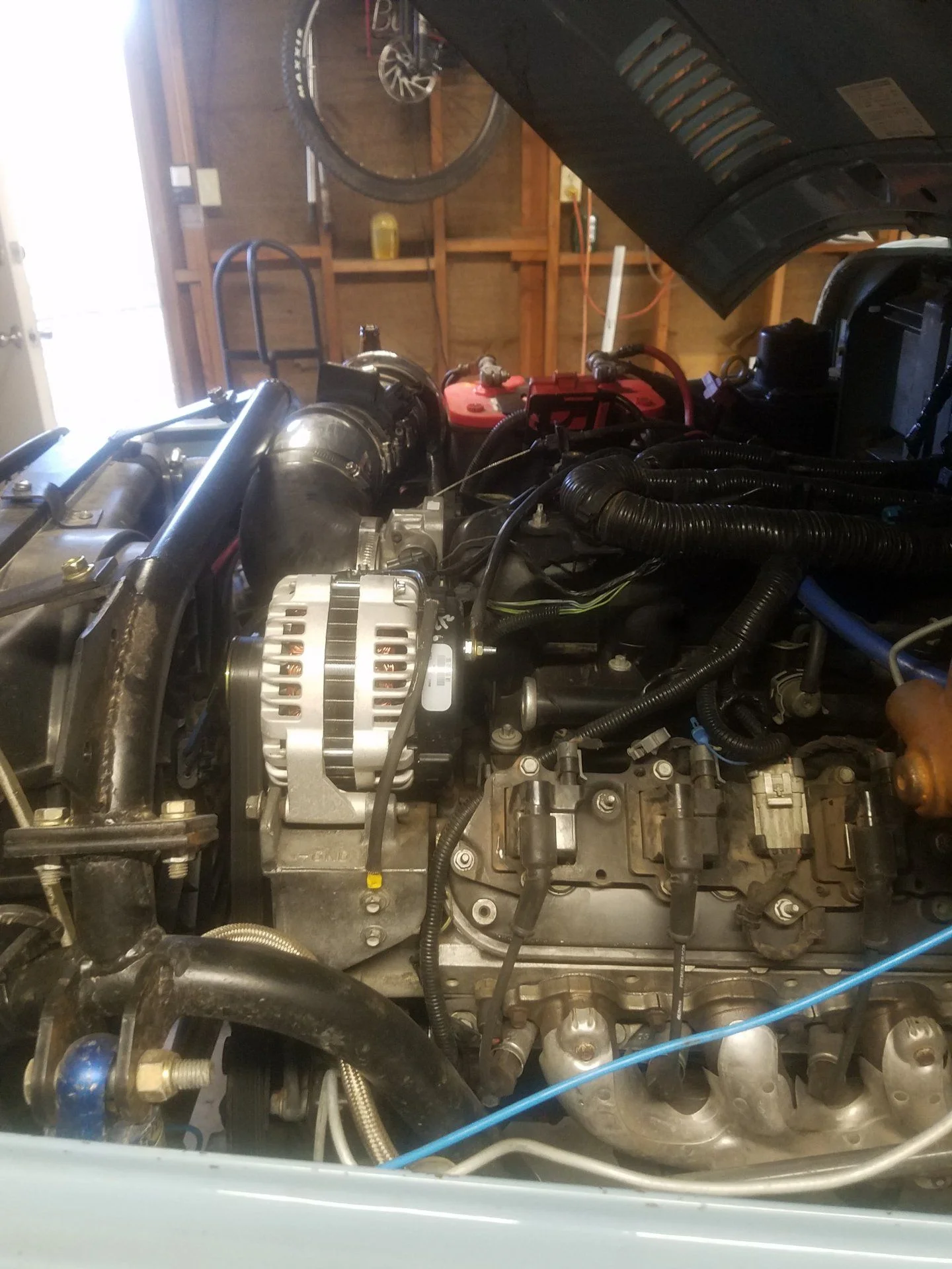

That's the route I'll need to go. How did you come over the alternator with the ducting? Mine goes to the passenger side because of the alternator
This was my original routing. Just up and over the alternator.

In an effort to get cooler air, I put in this set up. But the filter was too restrictive, and I kept getting DTCs. But this is the current routing, but with the bigger filter and box that I posted before. I did wrap the pipe with HVAC insulation from Home Depot. That actually did help.

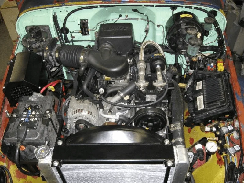

I have a 1st Gen 5.7l Vortec, so I don't really have the same input air temperature problem that you do, but I wanted to keep the filter dry and free of crap. I didn't find any commercial air boxes that would fit in the available space, so I welded up a 16 gauge steel housing for it. The filter housing is open to the front and outboard side, but could very easily have been open to outside air through louvres or a snorkel for cooler air. You could do something similar.
