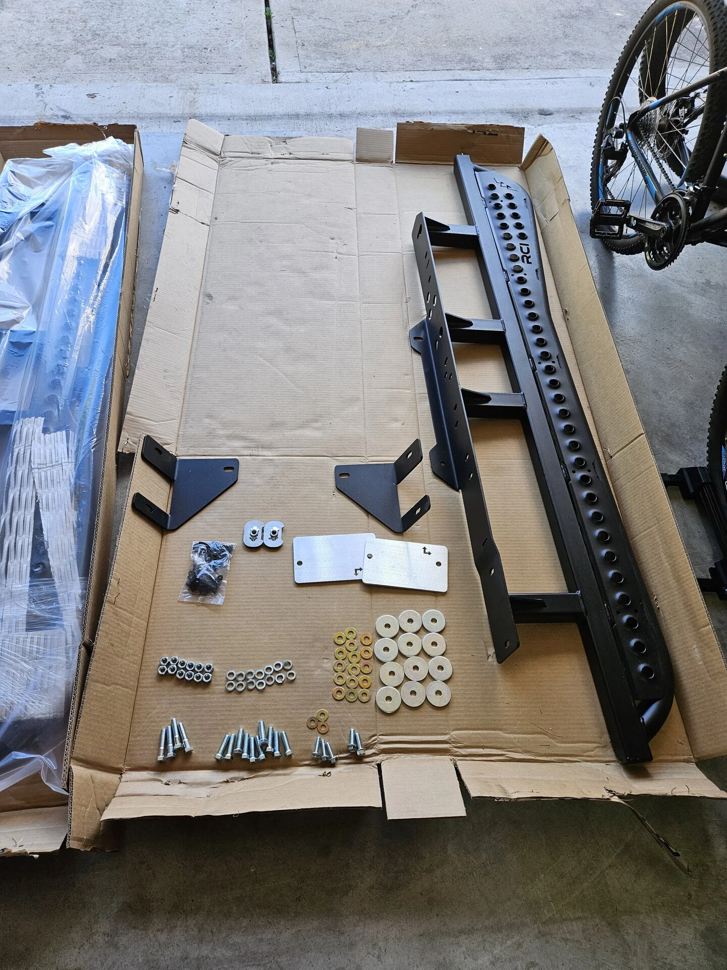

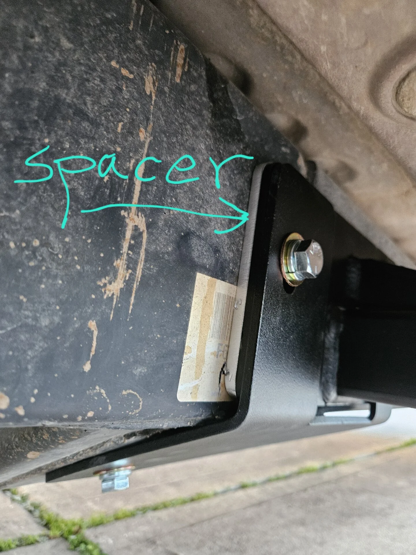

Got these RCI Offroad sliders on sale during Black Friday. Installation was straightforward. The most difficult part was reaching up through the front boxed portion of the frame rail to get the front-most washer and nut threaded onto the bolt.
Don't forget to place the aluminum spacers between the slider and the frame at the beginning when you're getting the first bolt in - they wait to tell you that you should have already done this until a much later step!

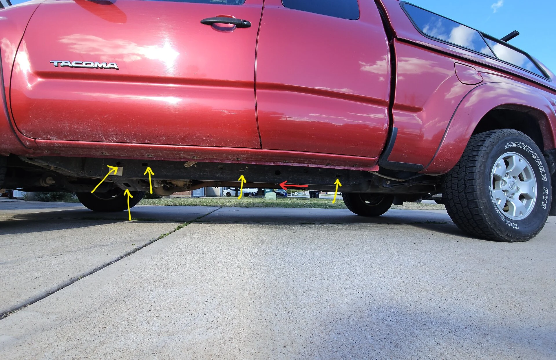

Here are the mounting locations. The yellow arrows indicate the holes on the side that used. The red arrow indicates the existing bolt on the bottom of the frame rail that is used.

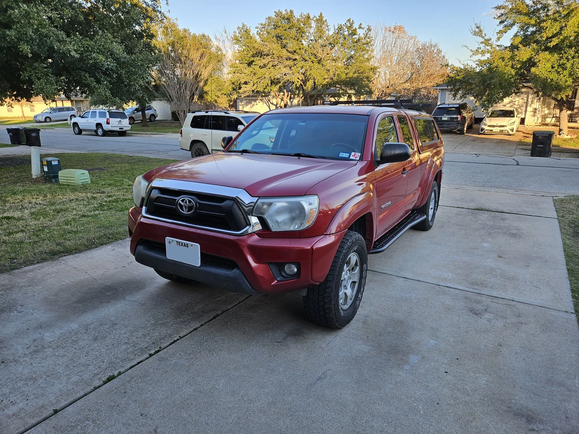

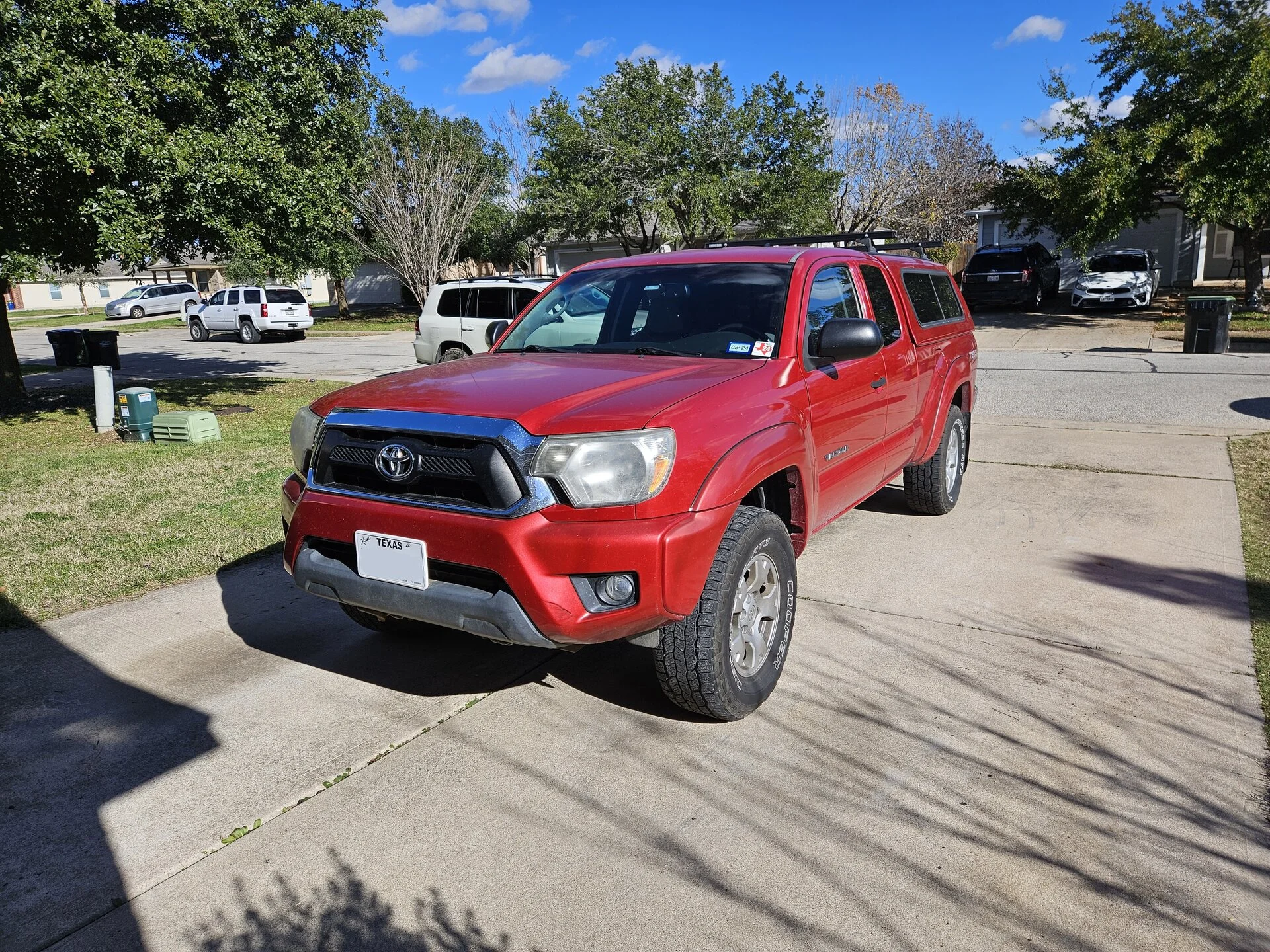

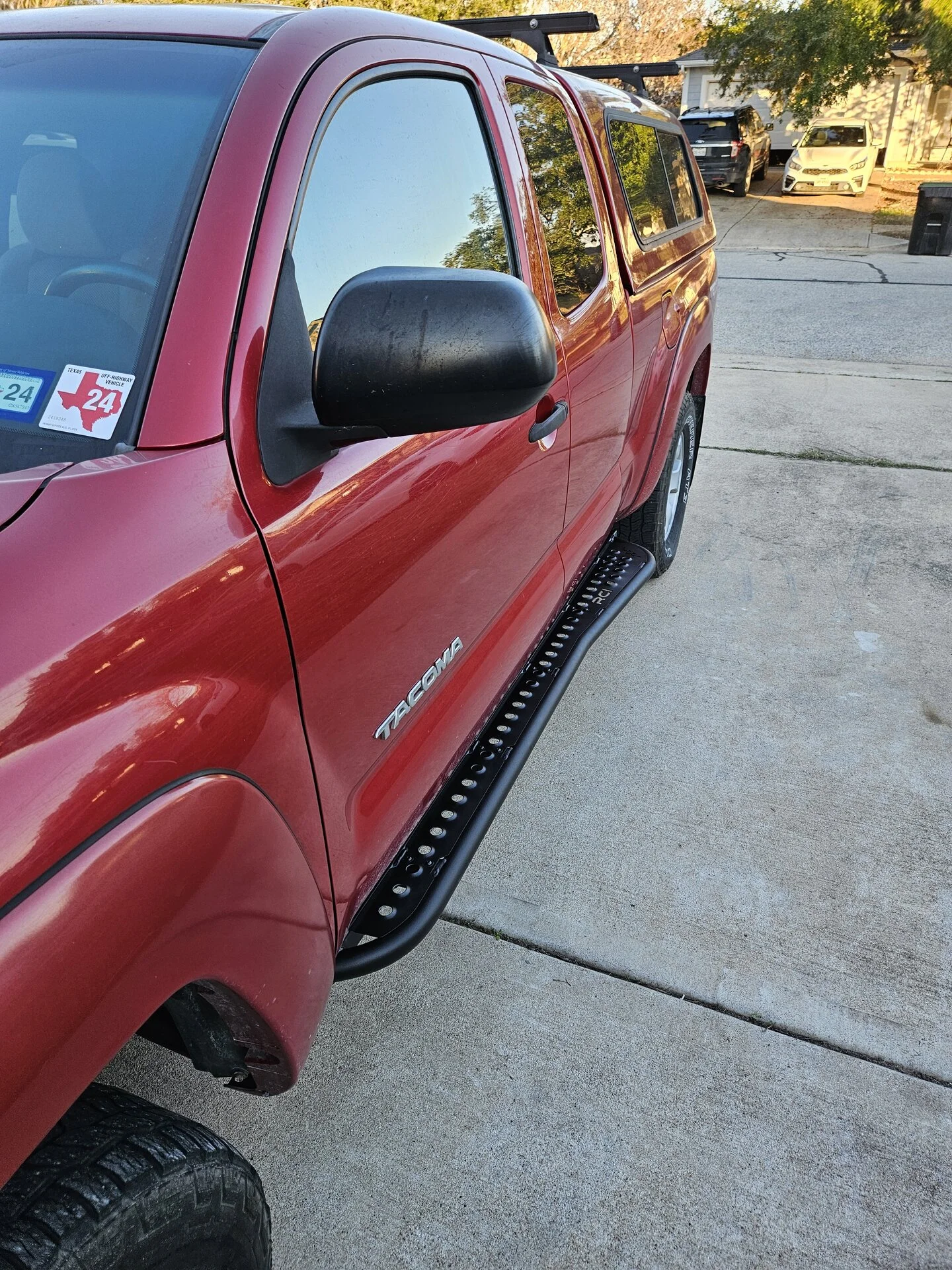

Before and after shots:

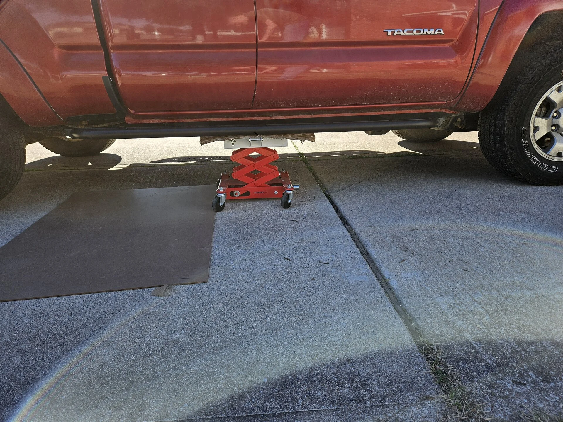

By the way, these small transmission jacks from Harbor Freight are excellent for all kinds of things, like raising sliders up for installation.
