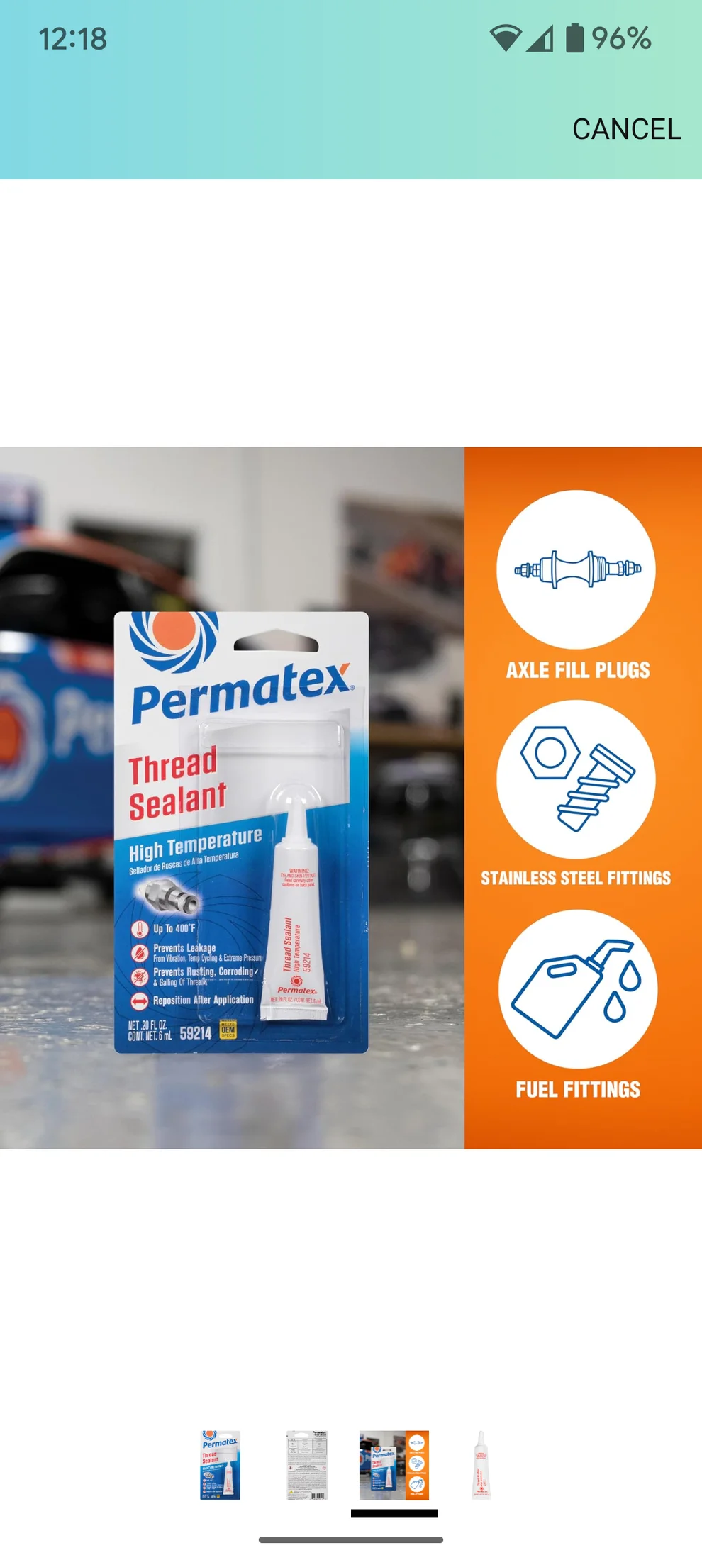

I always use a thread sealant that says, Sensor Safe, like permatex high temp, and never an issue.
I try to buy the smallest size available, cuz this stuff doesn't last long once
opened
