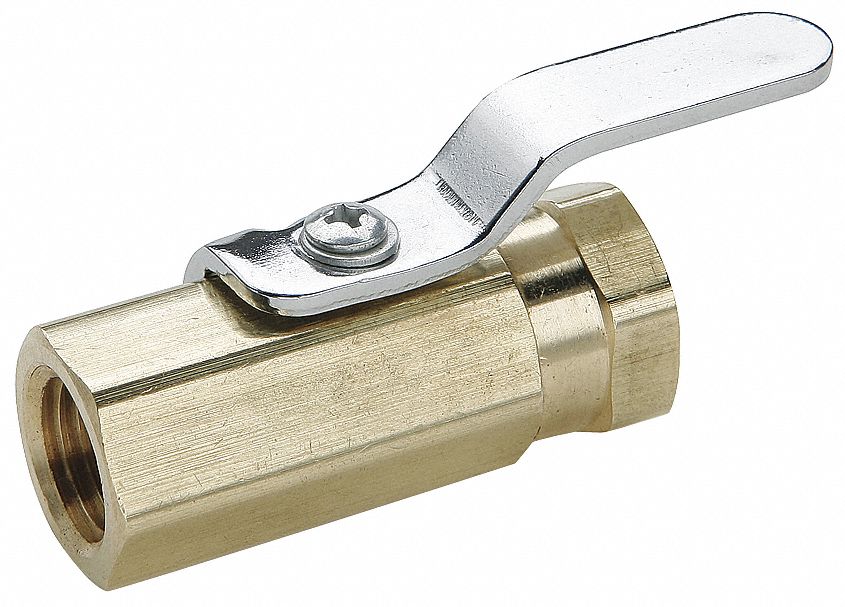

to a corrosion resistant material, probably Nicopp. But I want to install a manual (not electric with a relay) fuel shut off valve (ball valve) for anti theft purposes on the forward 5/16 inch fuel line.
I envision a ball valve of this type:
https://static.grainger.com/rp/s/is/image/Grainger/21VL80_AW01?$mdmain$
either in 1/8 or 1/4 size.
The fuel system consists of:
One short piece of rubber fuel tube from the tank. This rubber tube is connected to the beforementioned steel 5/16 inch line which travels most of the way underneath the car. Just before the fuel filter, the steel line is connected to a piece of rubber tube again.
Question:
What is the best way to install such a valve in between the fuel line? I am especially interested in what fittings I should use for this application. Flare fittings, compression fittings, metric fittings (I live in Europe). I am very much confused by all the fitting types, but ideally I would like to go with the flare fittings - if there are adaptors/fittings that fit into the ball valve. Any ideas?
