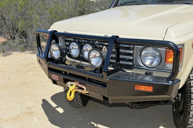

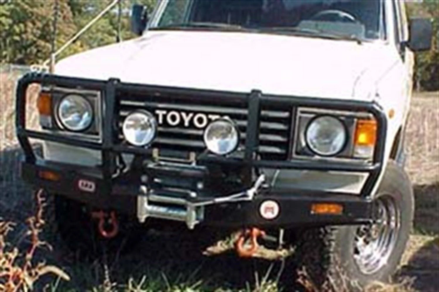

I used to have two lights just like the top picture shown on my ARB bumper (130 W ea) but I found that they were TOO bright. Reflective signs & even the zot dots on the road were blinding and made driving at night kinda more hazardous. Also if you forget to flip them off and a car approaches from the other direction - you've created a very dangerous situation by blinding him.
After I upgraded my car headlights to 100/80 with a wiring harness (mandatory) I found I no longer needed the bumper lights & got rid of them. I don't miss them. Even off road. They also get in the way of handling the winch cable on the drum (if you've got a winch). I'm glad they're gone. I'm a bigger fan of unobstructed air flow to the radiator.

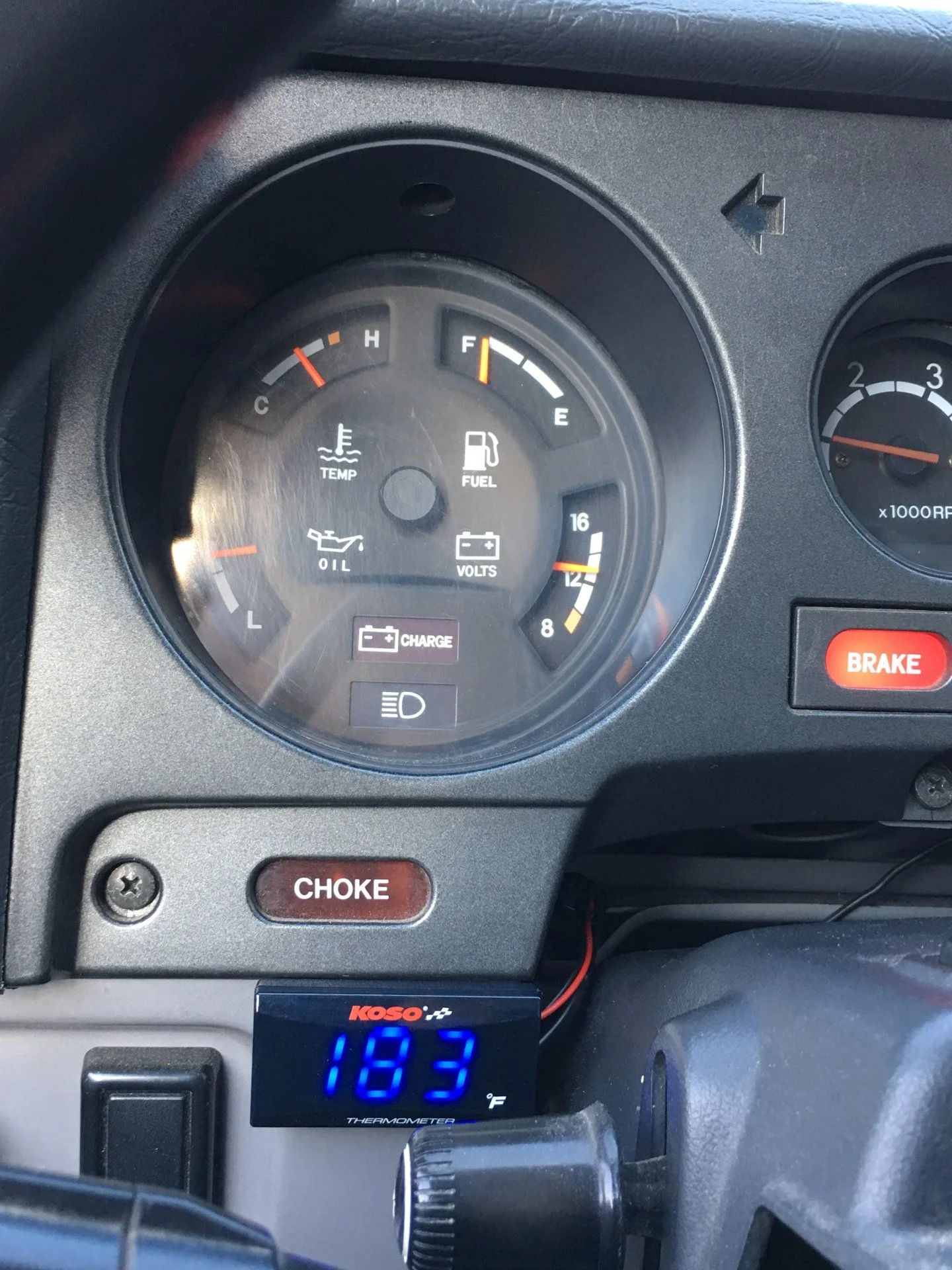

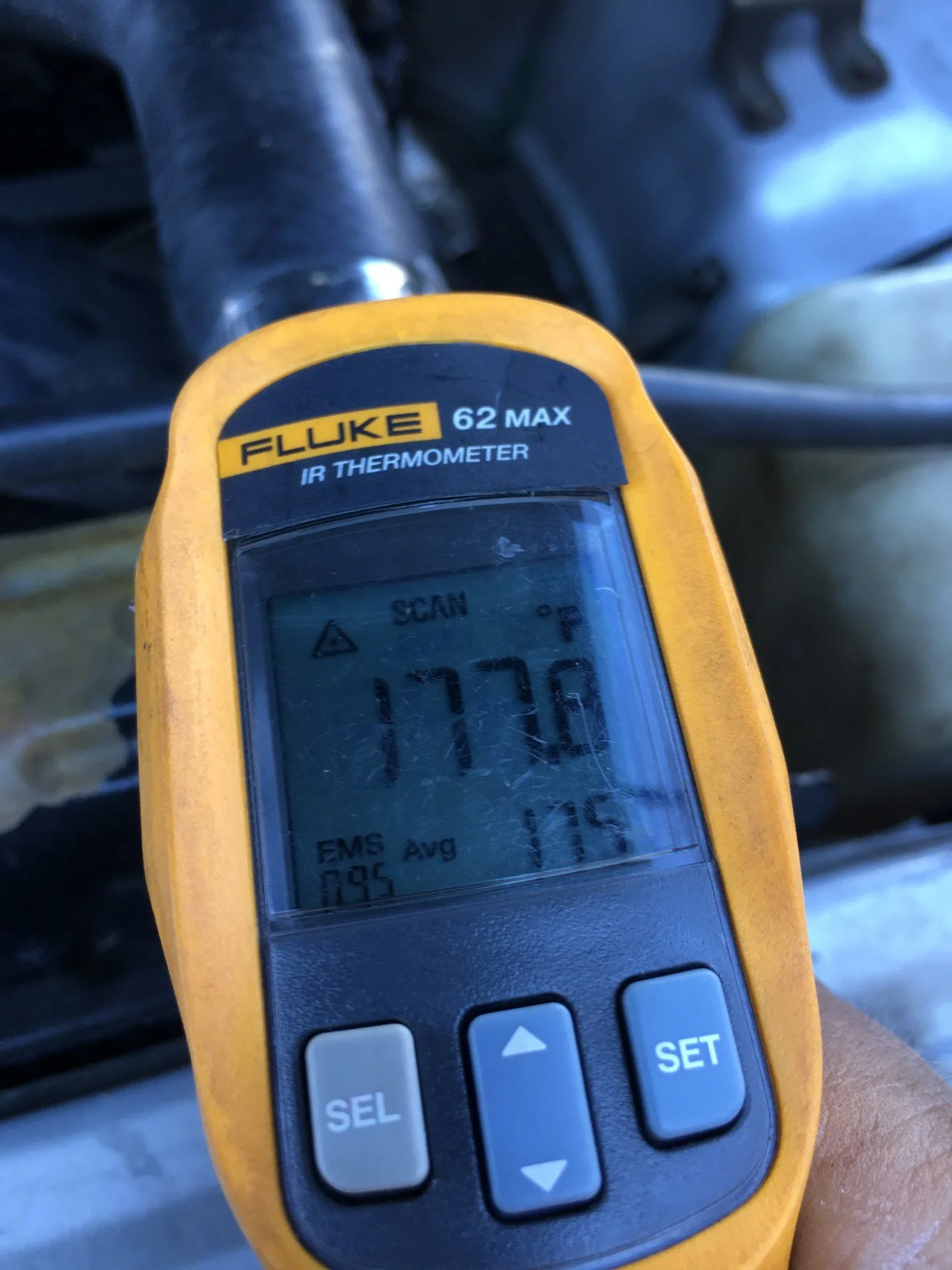

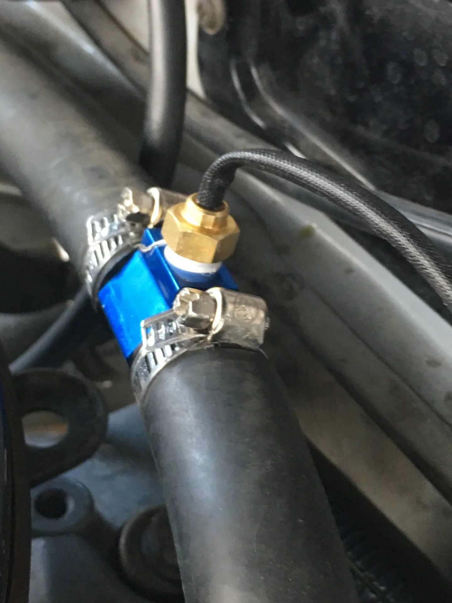

I added that mini temp gauge to track temperature trends.
In the mountains of big bend and the long stretches of I-10 where I held the truck at 3200rpm for an hour at a time, it would climb up to 205* and drop on the other side of the hill consistently.
Temp climbing on the highway is just a function of engine load, there was no shortage of cool air. This was with my snorkel also.
