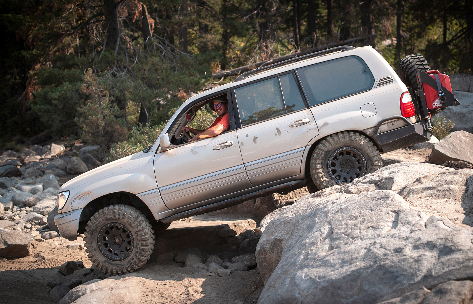

I've run Rubicon twice on AHC and a number of other trails, don't let AHC hold ya back I think it's a great system so long as it's working:)(knock on wood:)) I run Wheeler bump stops up front and Medium duty Old Man Emu springs in the rear(to help with the weight of the rear bumper, spare, cans etc) Part of the reason I love running the heavier springs in the rear and the bigger bump stops up front is if the system did take a s**t on the trail I could still drive off without the suspension totally collapsed. I have air lockers front and rear, 4.88 gears, summo transfer case gears, ARB front bumper, Coastal Offroad rear bumper etc.. Load the rig up, make mods as needed to run the kind of trails you wanna run, don't let AHC hold ya back, these rigs will take an absolute pounding. Hope that helps, good luck buddy and get out there and start adventurizing! -Ken
@Cantatan you plan on doing any wheeling like what previous the post is showing?
