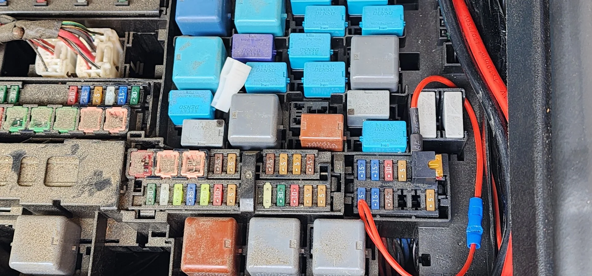

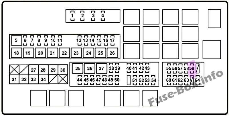

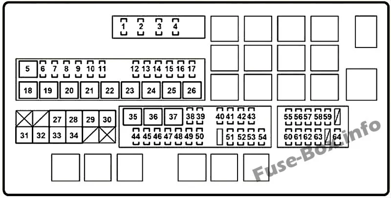

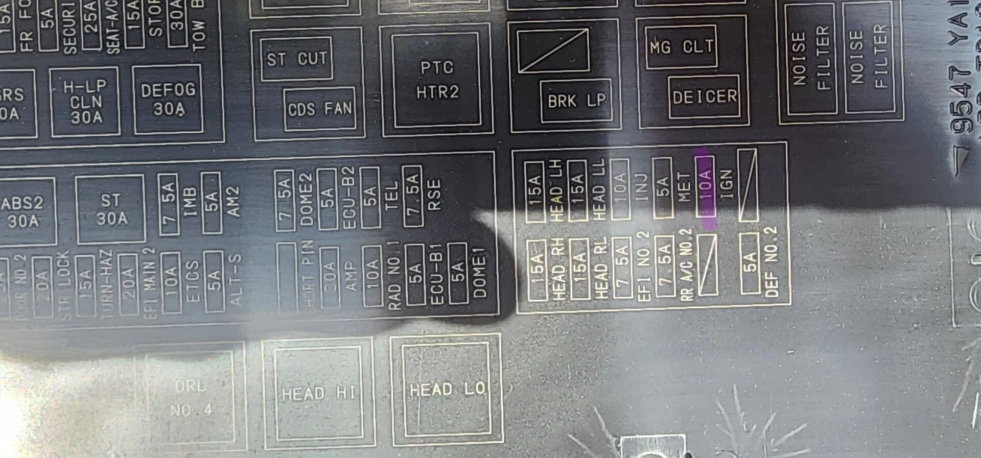

This is just information for anyone looking for an ignition switched power source in the engine bay. Mine is a 2009 LX 570.
In the Drivers Side Fuse Box (NA), #59 IGN 10-amp fuse on the attached diagram is only powered when the ignition switch is in the On Position (not powered in the accessory position).
This is not suggested to directly power additional accessories, but instead to be used as a + signal wire for relays or other powered devices. In my example, I am using it as the accessory wire to turn on an Auxbeam AR-800 Switch Panel controlling the air compressor, main light bar, scene lights, etc.
Note: Purchased a Low Profile Mini Fuse Tap to pull from this location.
Note 2: Please ignore my dusty fuse box. The lid doesn't provide much of a seal, need to get the compressor on it.
